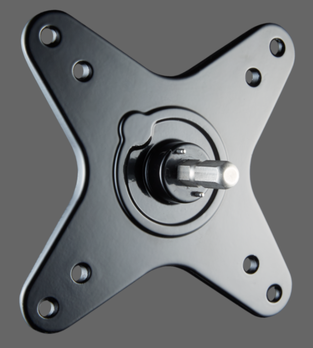

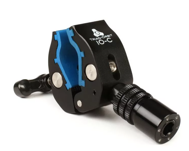

    I'm having trouble coming up with a solid and sleek mounting solution for my HP Reverb's WMR controller. I recall seeing a photo somewhere with a clamp-type mounting solution bolted to an 80/20 rig. I believe it looked something like this, but I can't find the original photo anywhere. Any ideas?
    22,211
    154,729Coins
    +11,213 / 57 / -2
    Just a thought, as I have not tried it, but how about a reversed VESA pole mount, so use what would normally be the TV plate as the base and the pole mount to hold the controller: https://www.amazon.com/s?k=vesa+pole+mount
  12. Chipless
    Chipless Member
    Nov 28, 2019
    84
    152Coins
    +26 / 0 / -0
    That's a great idea, and coincidentally, I was going to get this VESA adapter for the clamp I linked above, but the total price would have been over $100! Your idea is much more affordable, and I think it will be even more effective. I will update once I have everything set-up. Thanks again!

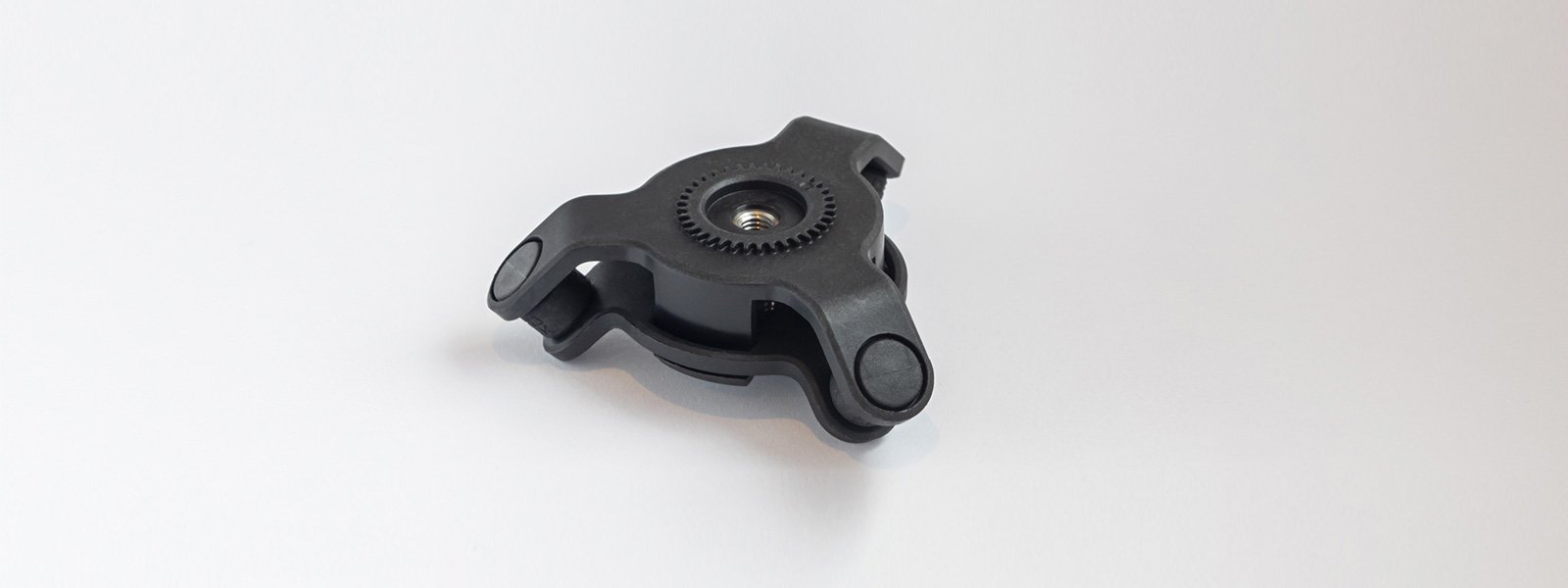

    When I find some time (which is not soon), I want to design a mount to 3D print similar to this one:
    My plan is to screw the lower part to the rig and add some extra weight to the tracker mount. I have bought some buffers for actioncam vibration dampers to act as the springy part.
