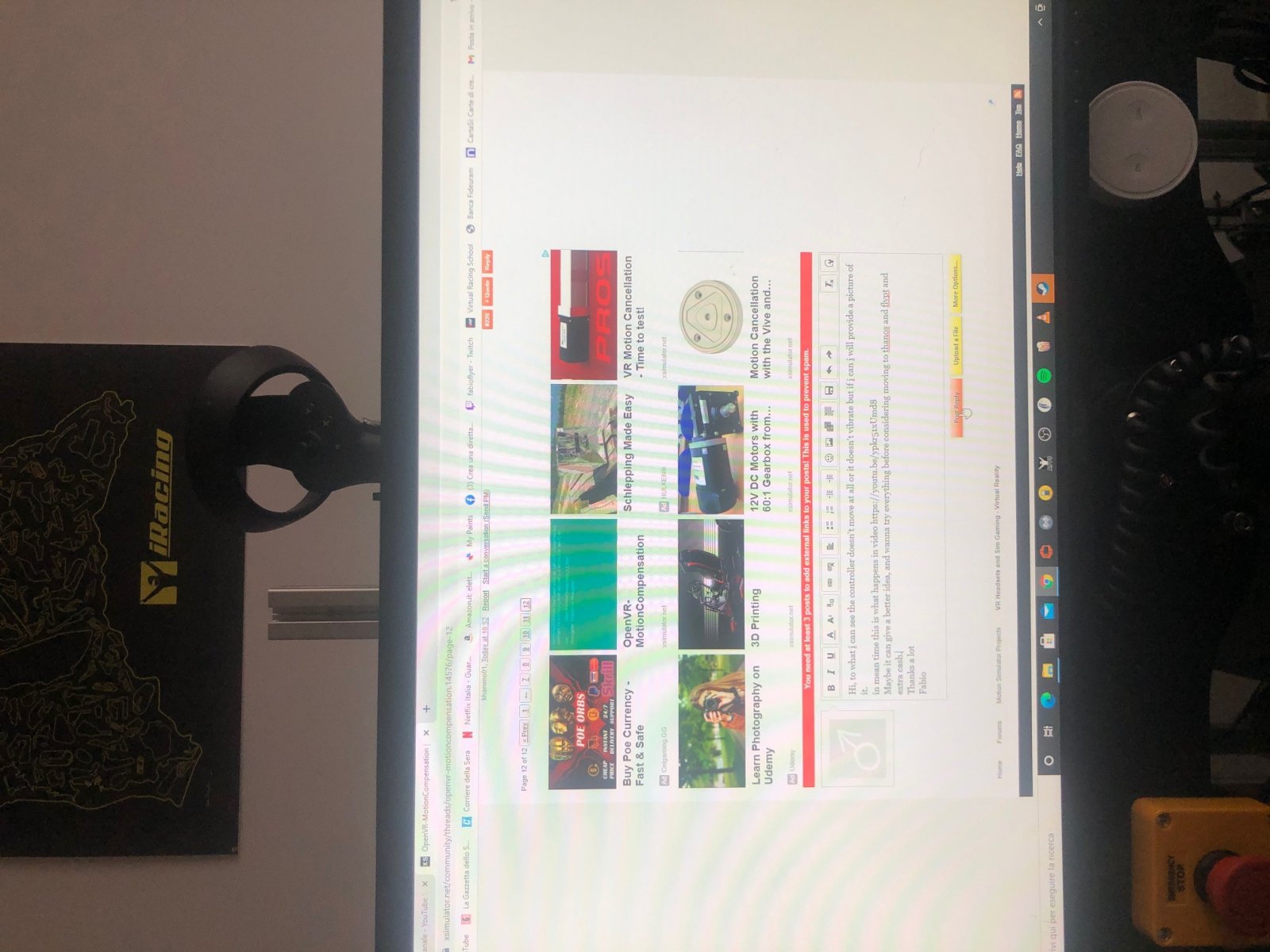

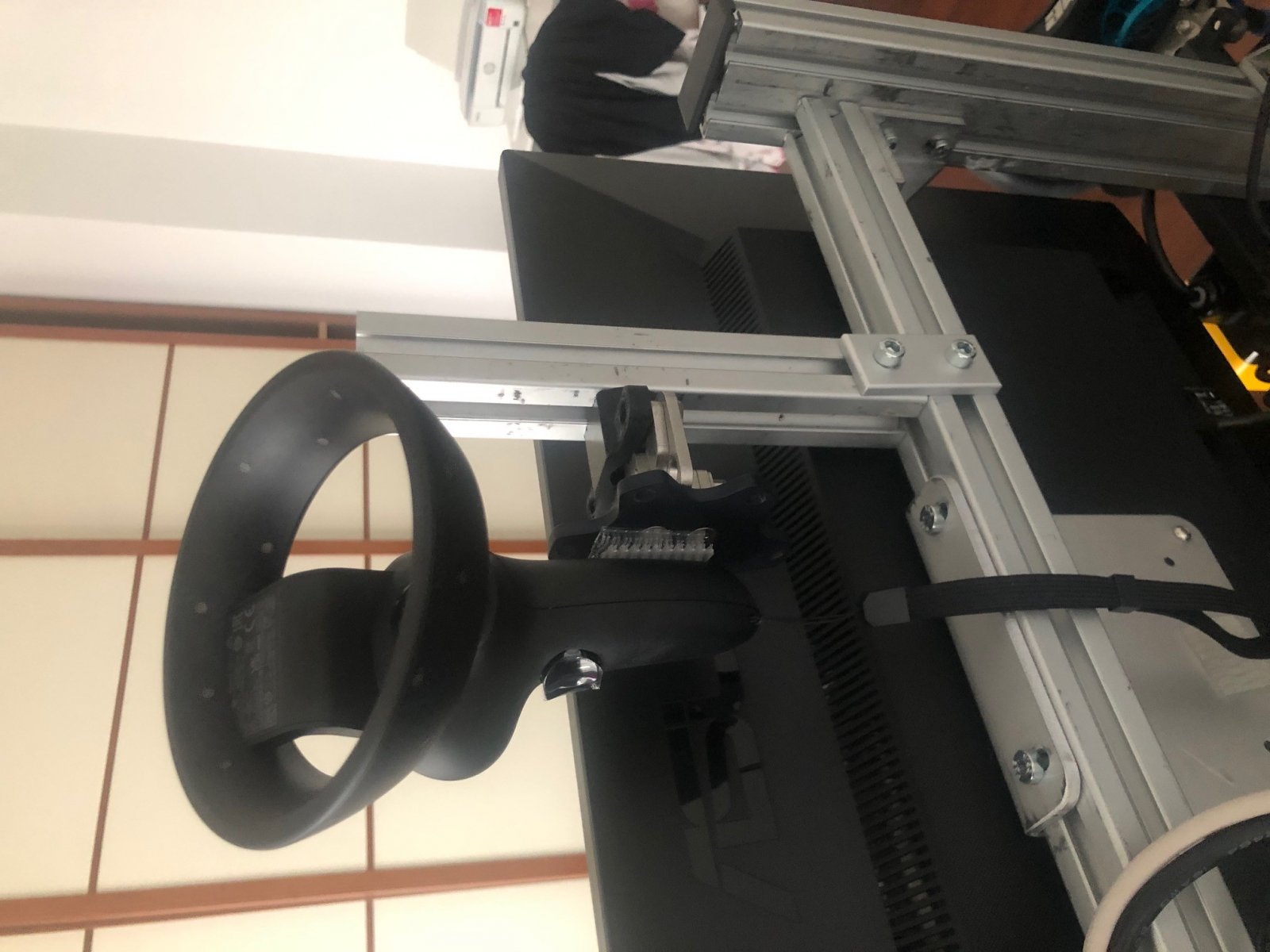

    Hi, to what i can see the controller doesn't move at all or it doesn't vibrate from what i can see.
    in mean time this is what happens in video please note that the complete flip of image it started happening only today.
    Maybe it can give a better idea, and wanna try everything before considering moving to thanos and flypt and extra cash.
    Thanks a lot
    Fabio

  8. fabioflyer
    fabioflyer New Member
    May 19, 2020
    8
    102Coins
    Motion platform
    EDIT as the mike didn't work
    First half is Motion compensation ON LPF 0.85 DEMA 4
    Second half is no motion compensation
    Fabio
  9. fabioflyer
    May 19, 2020
    8
    102Coins
    Motion platform
    Sorry for the many posts but seems this forum won't allow any edits of the messages after 1 minute.
    Here is a better (i hope) video to show you what is the main problem at the moment
    Fabio

  11. Dschadu
    Dschadu Active Member
    Jan 2, 2017
    109
    1,938Coins
    +146 / 1 / -0
    Your mount is most likely the issue. Velcro is to soft. It causes the controller to shake and move. The mount has to be sturdy. Like welded on. Even the slightest movement is catched from the sensors.
