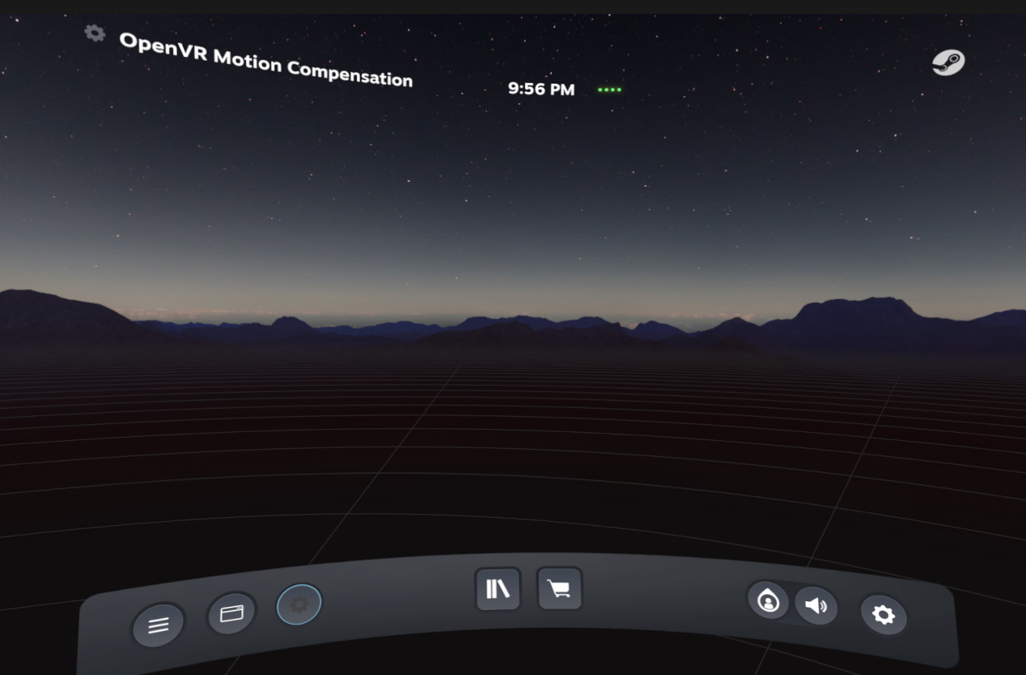

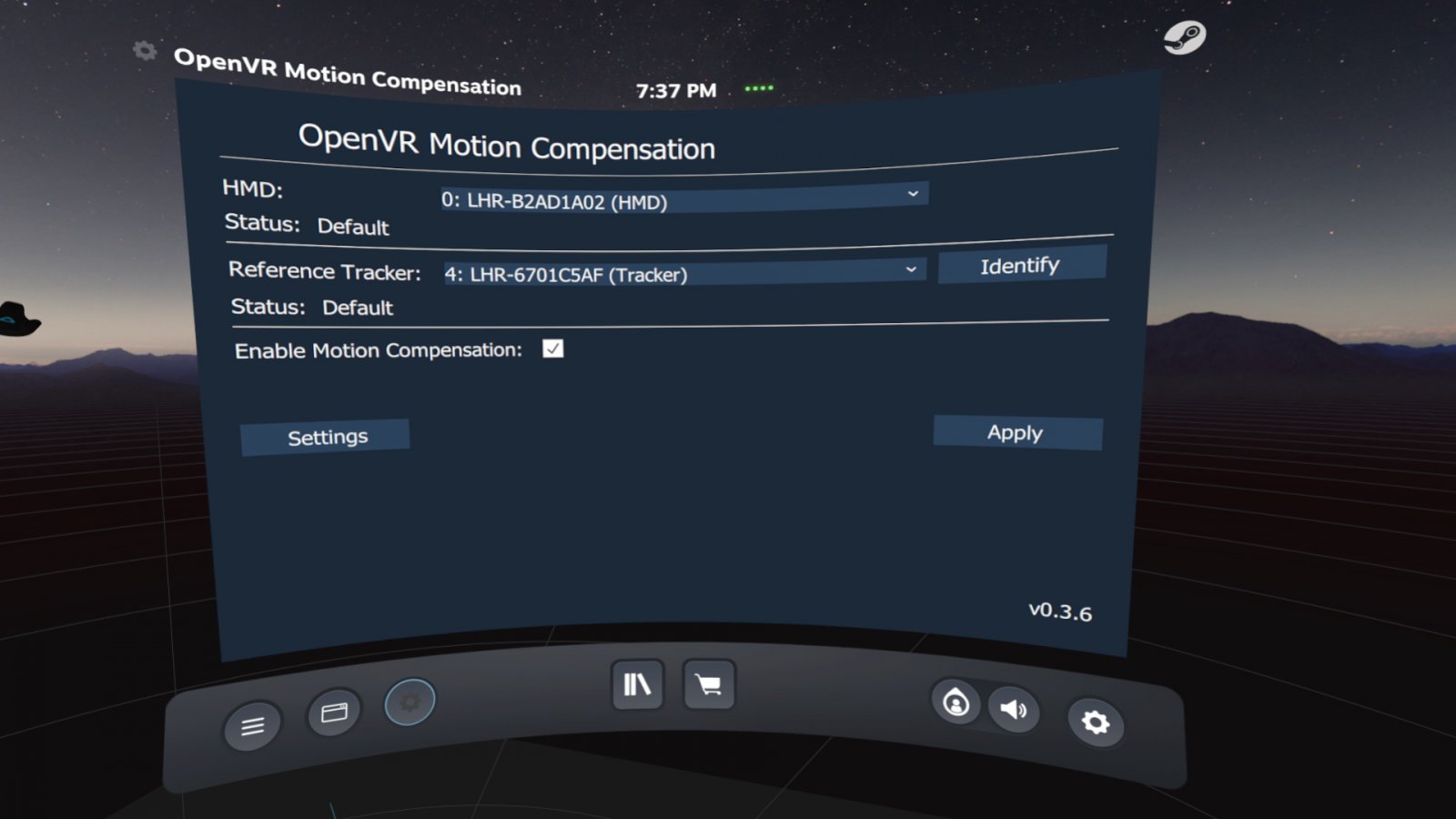

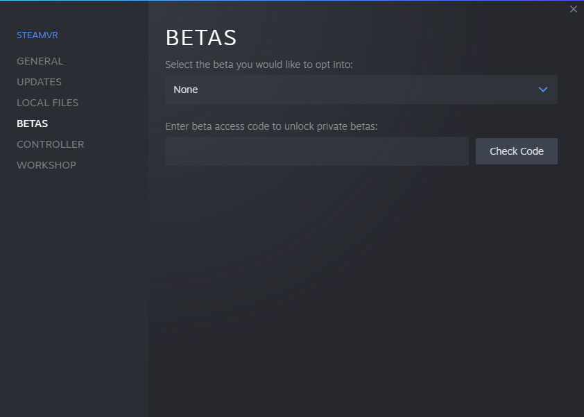

    Hi all,
    I'm wondering, if I'm the only one facing some OVRMC 0.3.6 issues since some weeks.
    0.3.6 was working flawless for months, I almost never had to restart Steam VR to get OVRMC runnig.
    But around July 11th OVRMC suddenly did not start anymore. After de- and re-installing OVRMC and Steam VR I did not got any huge difference.

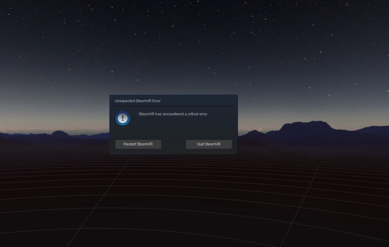

    Steam VR crashes quite often and I need to restart SteamVR several times, incl. unblocking OVRMC.
    Sometimes it looks like having OBS Studio running help, but I think this is more or less placebo. It does not work all the time, so maybe by chance only.
    Most of the time a re-start after unblocking OVRMC brings the OVRMC logo in, but clicking on it leads only to an "empty" OVRMC config page.
    I tried SteamVR in and out of Beta Mode, no difference.
    1) Typical 1st startup page without OVRMC logo
    2) Nothing blocked at first startup
    3) Restarting and crash
    4) Unblocking and restart bring up sometimes logo but "empty" OVRMC config page
    Info:
    Windows 10 Ver 21H2 Build 19044.1826
    Steam VR Build ID: 9124143 July 18th 2022
    OVRMC 0.3.6
    Any idea what could be wrong?

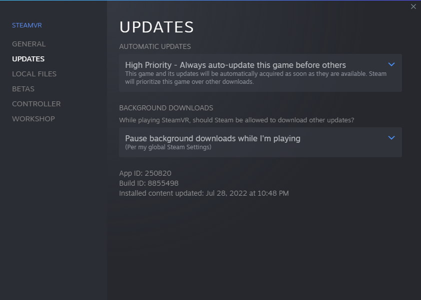

    Update - seems to be solved with latest SteamVR update.
    Since updated to Steam VR Build ID: 8855498 July 28th 2022 OVRMC runs as flawless as before.
    Michael

    I have potentially fixed the problem with the recent SteamVR version, try replacing the motioncompensation driver Dll with this one. The location is usually your steam/steamapp/steamvr/driver/00vr.../bin/win64
    Let me know if it helped.

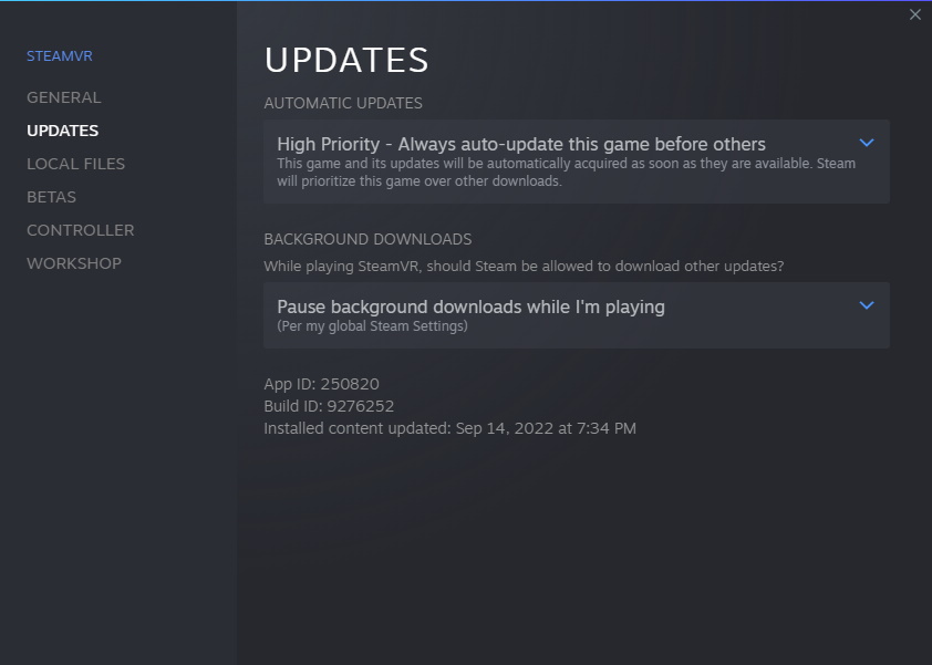

    @Wagnard - Thanks, you are my hero.... :thumbs
    Fully fixed the issue for me.
    1) Switching back to "non-beta" version
    2) Updating SteamVR to latest version (9276252)
    3) Starting steam and check if OVRMC will start - it did
    4) Doing some test runs with AMS2 - all good
    hug:
    Michael

    I can see a similar issue with a Reverb G2 (mixed reality) and it was because of the Windows Mixed Reality for SteamVR driver. Reverting to the LKG version in Steam Fixed it.
    Maybe it's a similar issue on your end.

    Its for Windows mixed reality, you have pimax, normally you don't have that.
    Its when I click property on the windows mixed reality in steam and under beta, I select the LGK version
