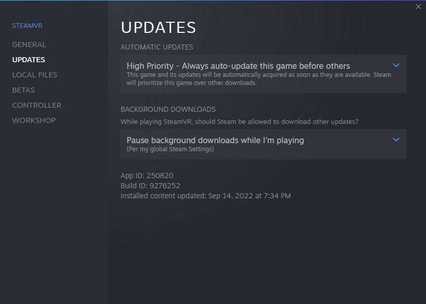

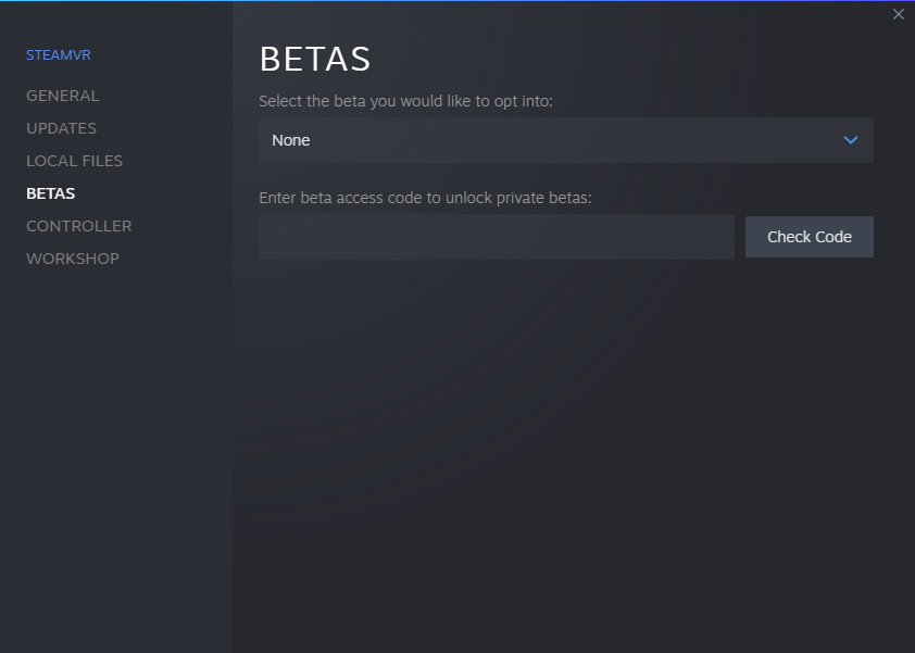

  3. Wagnard
    Jan 30, 2017
    567
    Wagnardsoft
    Canada, Quebec, Mirabel
    5,384Coins
    +787 / 2 / -0
    In steam, right click the mixed reality for SteamVR , properties and under beta, select the LKG version. It should fix the black stuff

  5. prime97
    prime97 New Member
    Jun 7, 2020
    18
    Sydney Australia
    143Coins
    Thanks, that fixed the black stuff and service has been resumed.

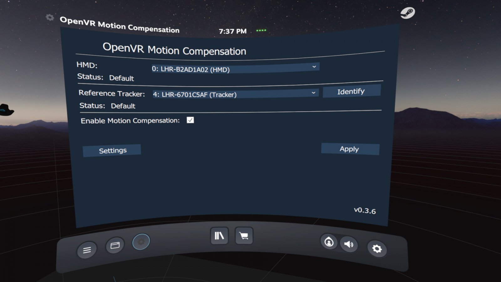

  12. InTheory
    InTheory New Member
    Jan 10, 2023
    34Coins
    Not sure What I am doing wrong. I installed OpenVR motion compensation as directed. Set up my FLPT OVRMC output. But the virtual compensation device does not show up in my list in OVRMC settings in Steam VR.. Any help? Using a Quest 2.
  13. Avee
    Avee Virtual Pilot
    Jul 5, 2020
    149
    1,167Coins
    +43 / 1 / -0
    On your steam VR dashboard there should be a little cogwheel for the OVRMC settings. You need to activate it there, and set the center of rotation of your rig.

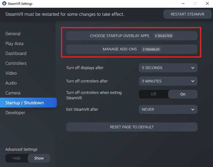

  16. HugoB
    HugoB New Member Gold Contributor
    Jan 11, 2019
    15
    215Coins
    3DOF, Arduino
    I followed the steps to install OVRMC, but the cog doesn't show up.. I tried all the troubleshooting advice ("If you cannot see the small cogwheel on your SteamVR dashboard, check the following:"). I am running the latest SteamVR (1.26.7) and not beta. I am using OVRMC v0.3.7 I tried restarting SteamVR, restarting Steam, the PC, uninstalling OVRMC and uninstalling SteamVR with a clean uninstallation deleting all traces of SteamVR and OVRMC and doing a fresh SteamVR install and initial setup then reinstall OVRMC. No luck, the 'cog' won't show in the overlay menu. Of course I tried activating it: [​IMG]

  17. Wagnard
    Jan 30, 2017
    567
    Wagnardsoft
    5,384Coins
    +787 / 2 / -0
    The ddl seems loaded.
    no idea why the cog is not there but you could try to open the desktop version of it. there is a desktop. bat file in the OVRMC installation folder. if lucky it may work.

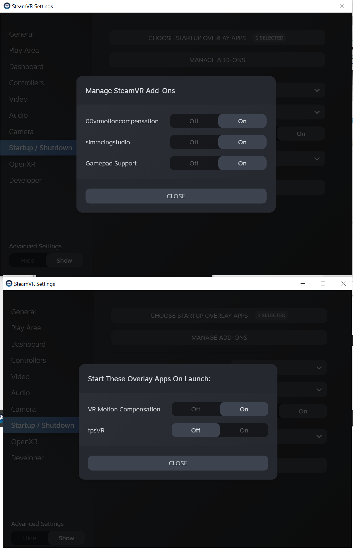

  18. HugoB
    Jan 11, 2019
    15
    215Coins
    3DOF, Arduino
    I tried the 'startdesktopmode.bat', nothing happens.. In task manager there is no program started.. here are my settings:
    I tried turning them on and off and restarting SteamVR and restarting the PC, no luck, no OVRMC 'cog' visible.. I tried uninstalling OVRMC and reinstalling it multiple times, it just won't seem to run. I have Windows Defender turned off completely, during installation and during running. Is there any other log I could look for?
