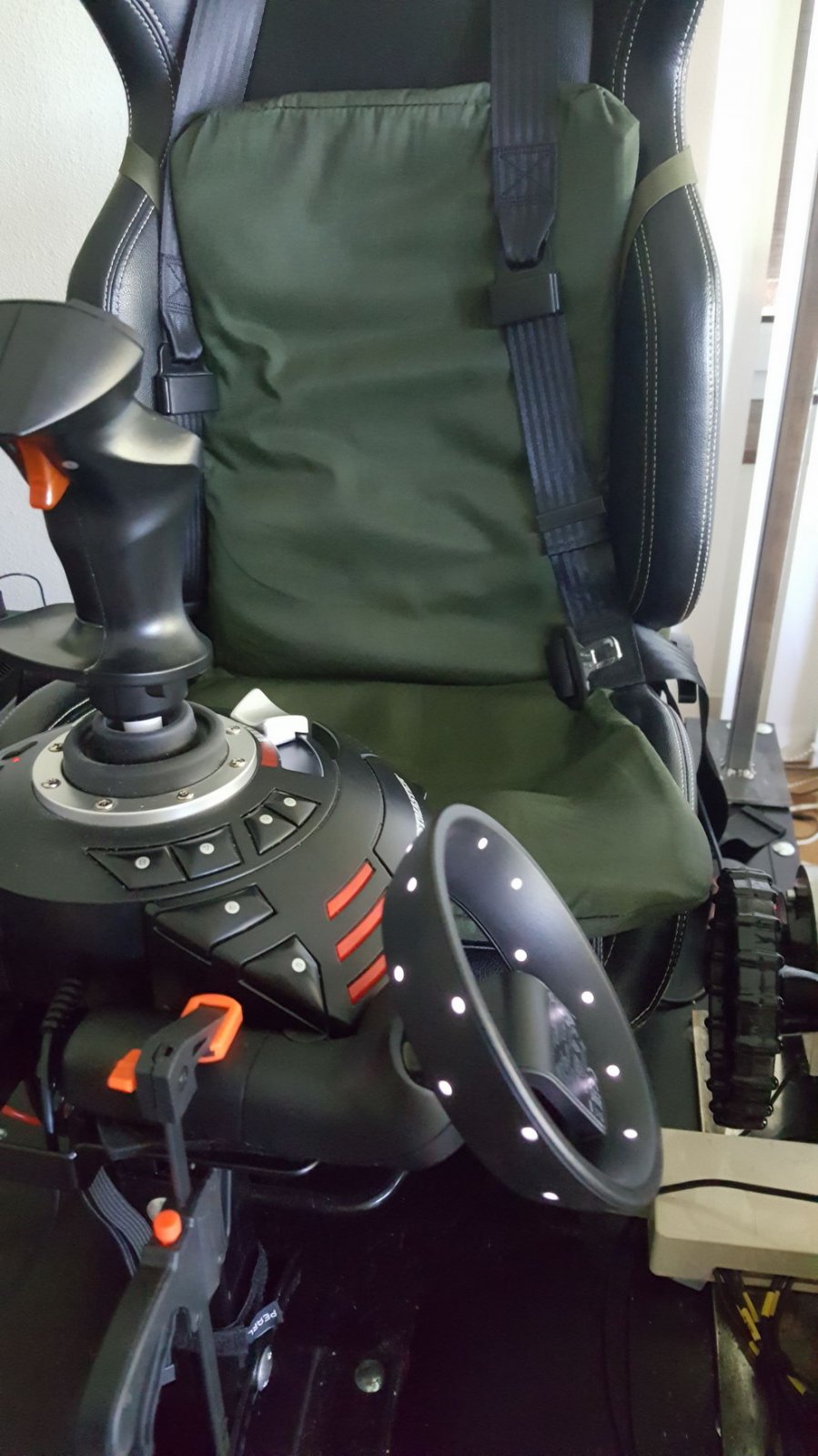

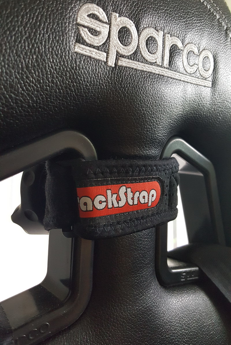

    Before (vive tracker behind headrest):
    upload_2020-8-12_11-45-51.jpeg and after (now) upload_2020-8-12_11-46-58.jpeg
    You see, a rough and ready "temporary" solution, but works so well, that I probably leave it like that...:cool:
    My seat is isolated against the base, thus NOW I can power up Jetseat and Buttkicker about as much as I want, with almost lowest filter settings.
    >>now I‘ll have to figure out a proper mount as well as an energy supply solution to power those insanely hungry LEDs
    @twack3r: I use this special kind of re-charagabels RoHS ( the ones with the inbuilt USB micro port) with very steady 1.5V output. They only have 1600 mAh, thus I have to recharge them after about every 30min Beat Saber session, but obviously the FF is most power hungry, as just for tracking they hold much longer! And charging is quite fast. They're expensive, however, thus maybe you look into Trip's solution.
