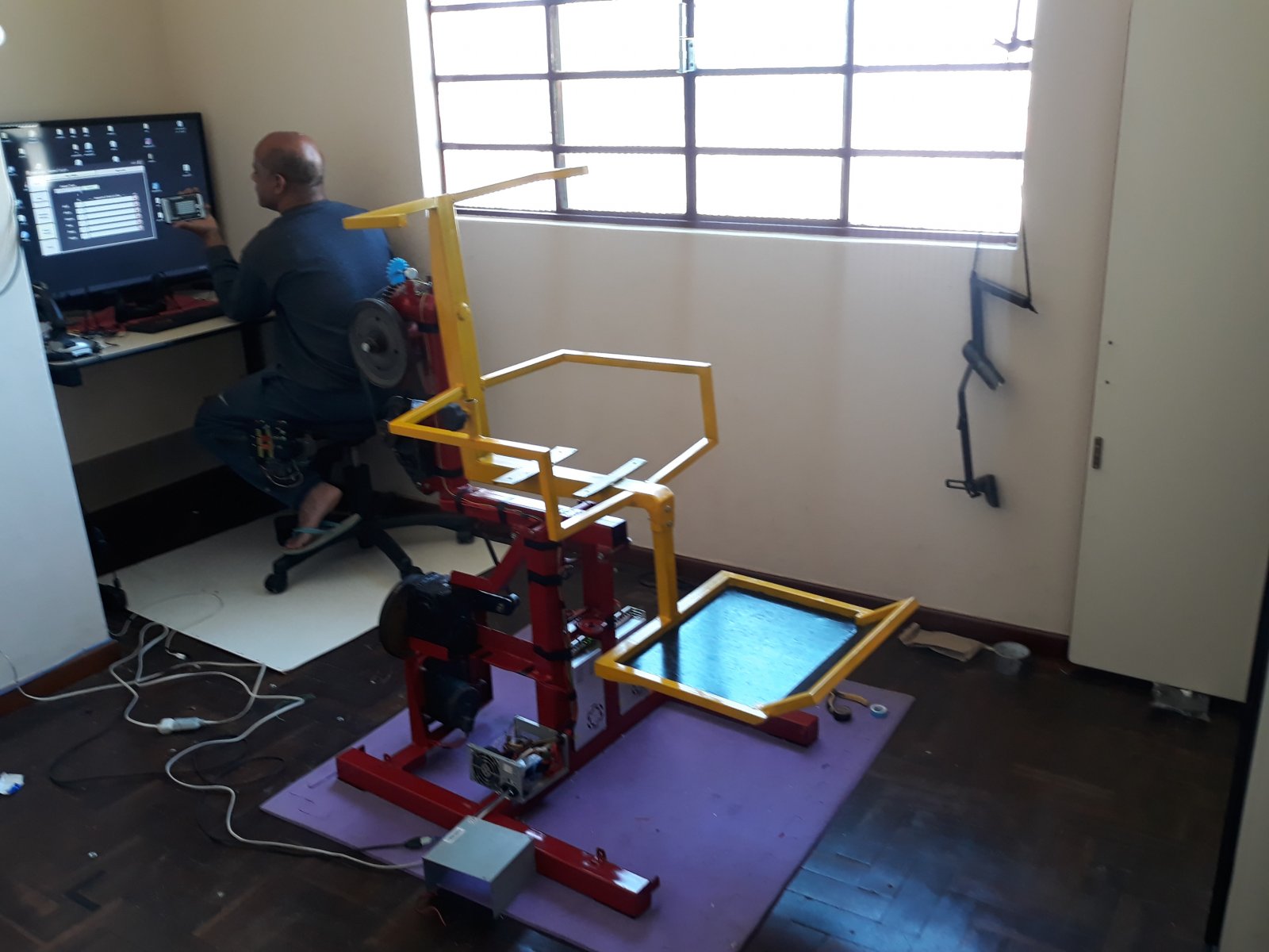

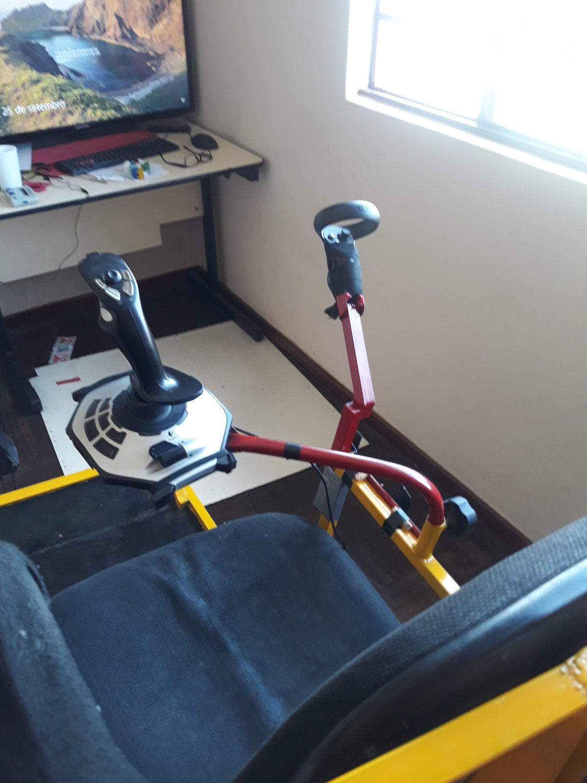

    20200925_150329.jpg 20200906_103047_002.jpg Dschadu, greetings, my simulator rotates 90º to each side of the roll axis and the ovrmc has not adjusted, my head rotates out of the plane because I use the rift s with the right control attached, even though I am trying various filter adjustments. is there any information about the ovrmc working well with 180º simulators?
  7. Dschadu
    Dschadu Active Member
    Jan 2, 2017
    109
    1,938Coins
    +146 / 1 / -0
    This is an Oculus specific issue. Somehow they bypass the OpenVR functions for position and use their own rotation.
    No way to fix that from my side, sorry.

    thank you my friend, soon i will receive the hp reverb g2, i hope it works, otherwise my platform will be useless.
