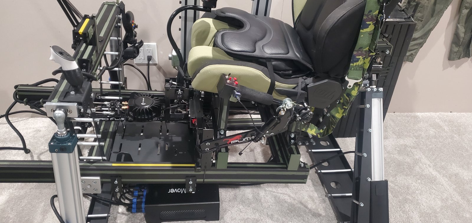

    Have you got a photo where your is placed at all :)
    Cheers

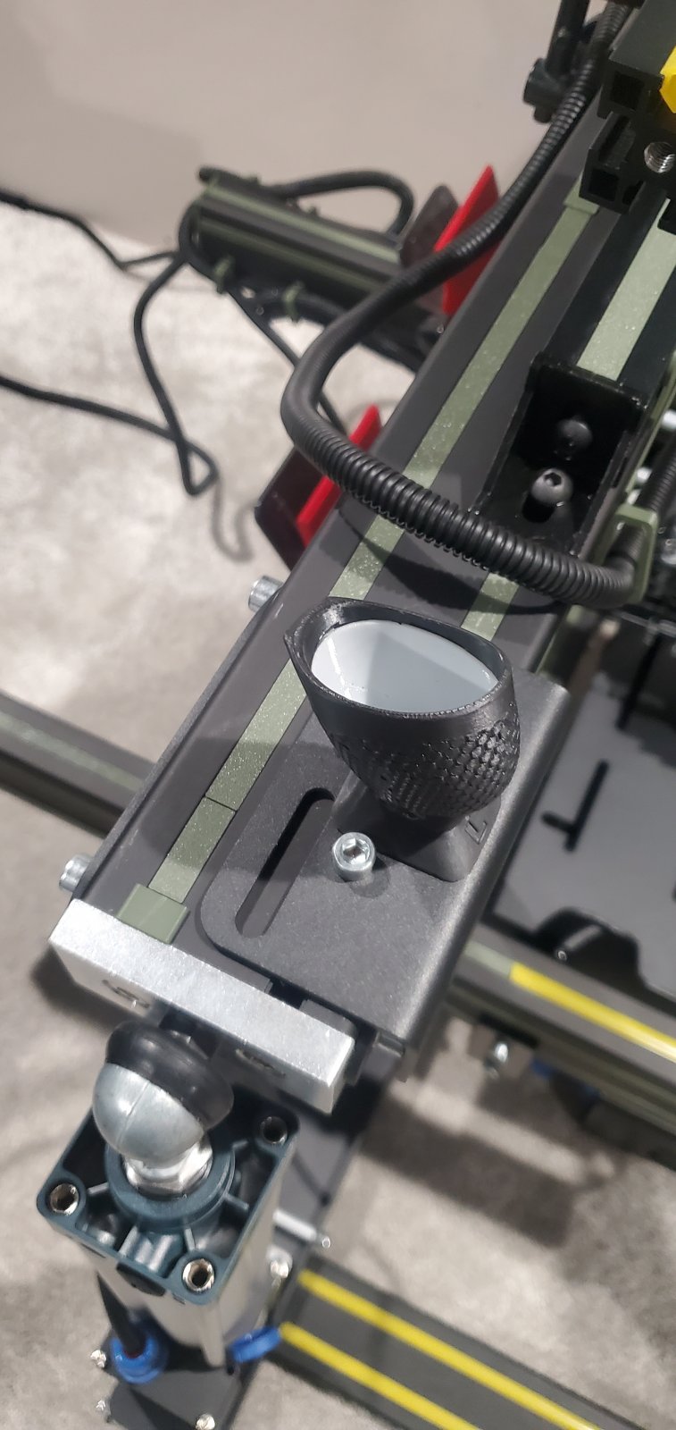

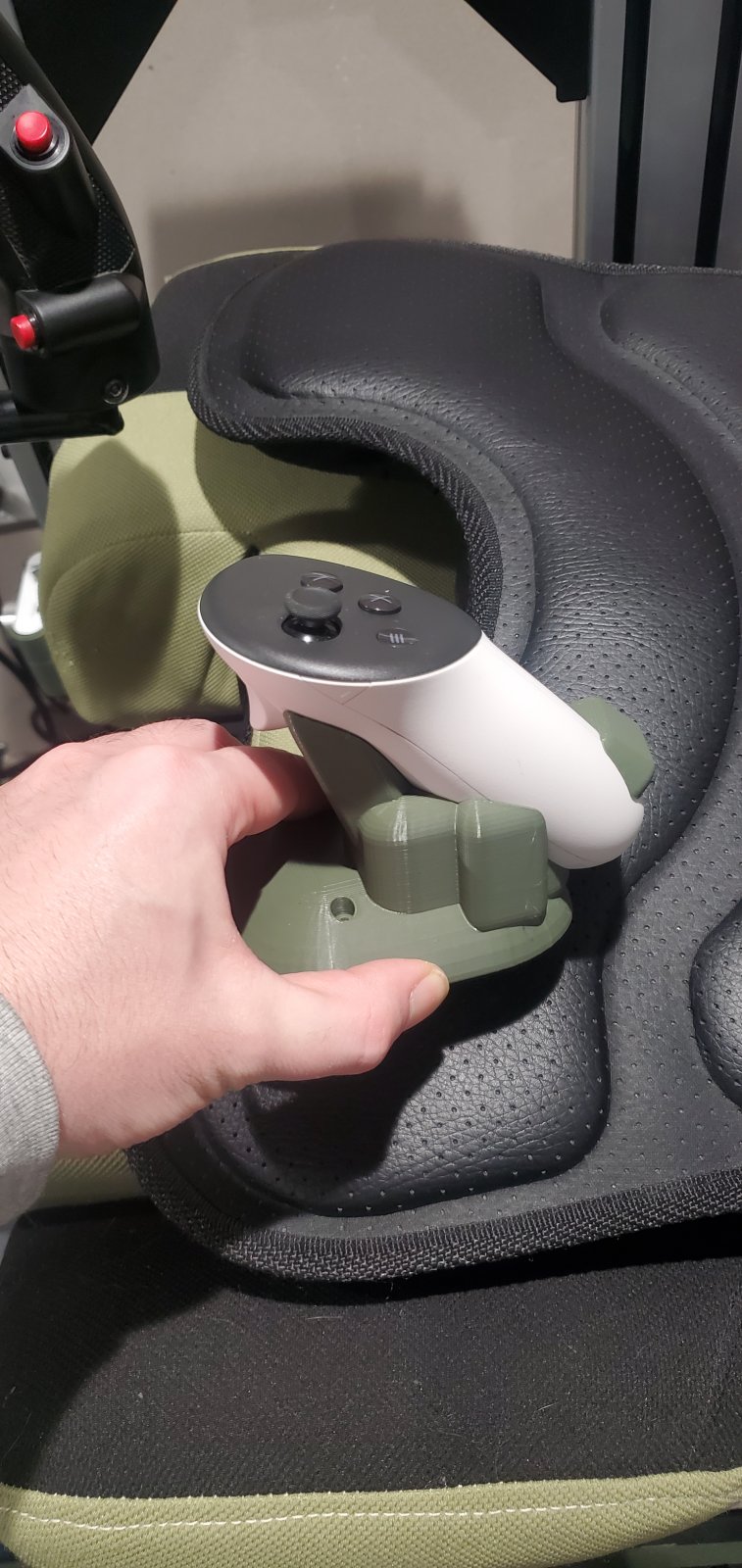

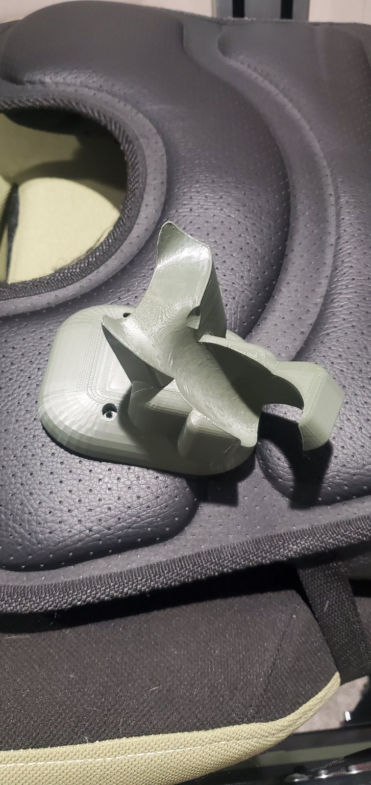

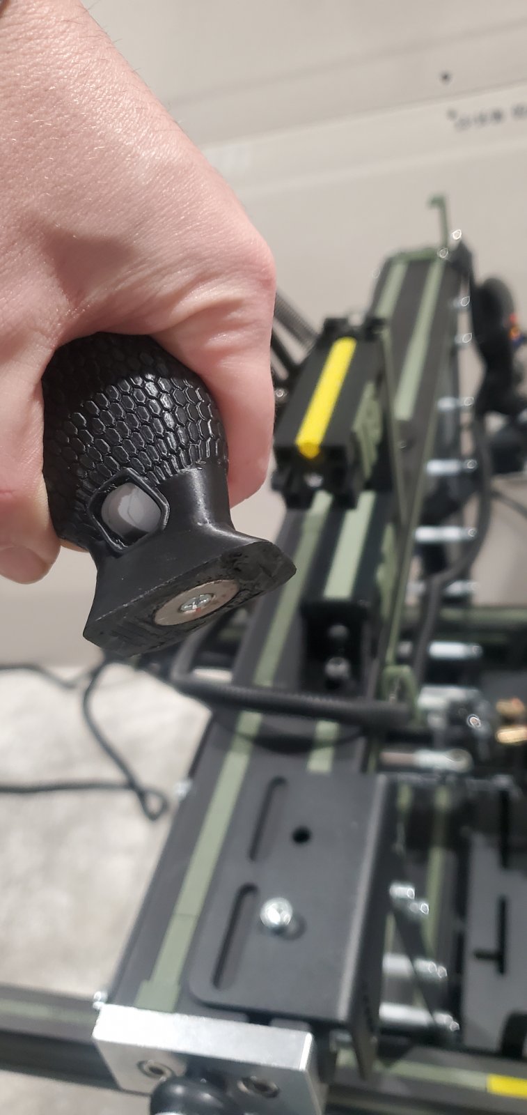

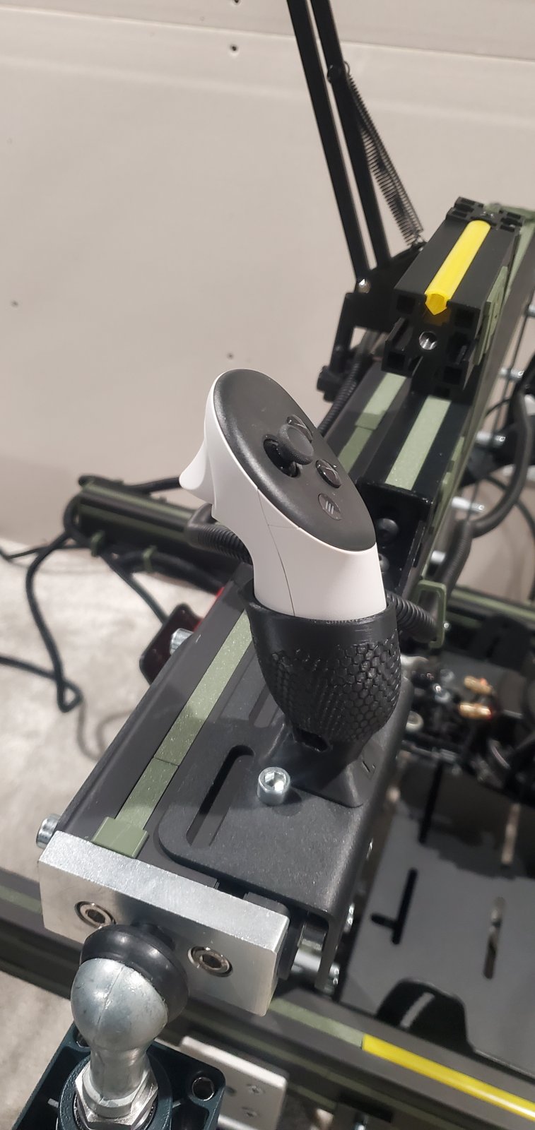

    I currently am using a 3d printed gun stock quest 3 cup with a strong magnet on the left of the rig. Works perfectly, and due to my haptic transducers I use the "left control + \" for stabilizing motion which works perfectly. I also 3d printed the green quest 3 controller but haven't tried it yet and am currently printing another holder and I'm gonna compare them.
    This method works perfect for me so far.
