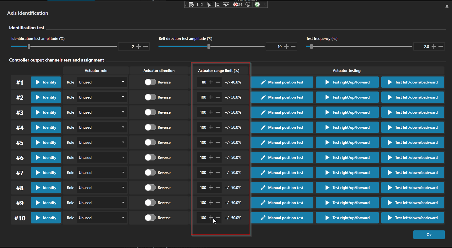

    With thanos controller; this image here which I got from page 1;SIMHUB MOTION FOR SMC3
    Why can you not change the actuator roles; to surge , sway etc
    it only allows you to choose; front left; front right, rear left, rear right.
    Simhub is so limited that if you have your bespoke rig, you cannot use the software for motion.
    but would be good to use it for just virtual tracker only, (motion comp)
