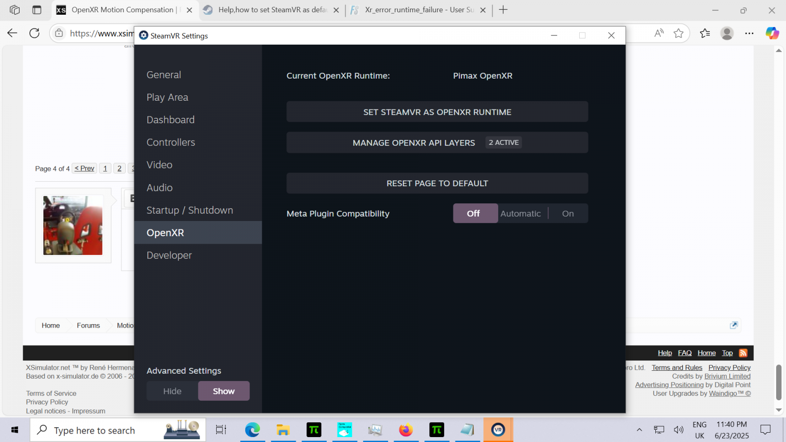

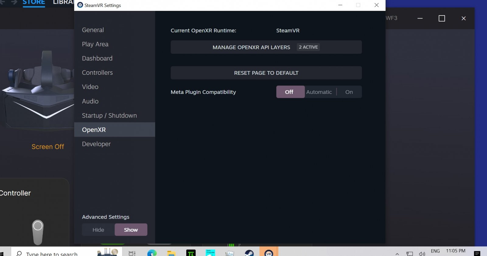

    thats the issue, when " Click on “Set SteamVR as OpenXR Runtime”
    it gives this:
    current openxr runtime' steam vr; then when running automobilsta through steamvr there is no 10..9... countdown.
    I am even using opencompsite to force openXR in steam.

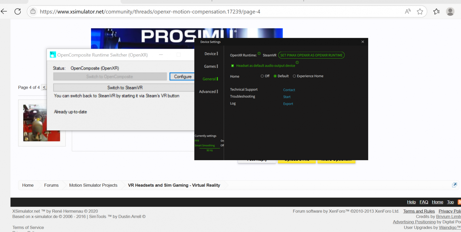

    Can u send the screen of opencomposite? And with Pimax play can you launch games?

    i now got this error:
    : XR_APILAYER_NOVENDOR_motion_compensation layer (beta - 0.3.9.0 [x64]) is active
    : Using layer: XR_APILAYER_NOVENDOR_motion_compensation
    : xrCreateApiLayerInstance failed with XR_ERROR_RUNTIME_FAILURE
    Sure photo of opencomppsite below' it forces both steamvr and AMS2 game;
    also i can launch through pimaxplay but i have been launching it through stream; have not tried launching it through pimax play.

    Try with Pimax as openxr runtime and launch trough Pimax play
  8. Fahim
    Fahim Member
    Dec 11, 2008
    477
    553Coins
    as soon as i switched to pimax xr in the pimplay software and then started the game through there i got a countdown; 5...4... then error sound following by game crash;
    the error code was : error - tracker::ViveTrackerInfo::Init: runtime does not support Vive tracker OpenXR extension: XR_HTCX_vive_tracker_interaction
    What i then noticed when going into steamvr; the run time was pimax XR; Open composite was still switched to OPEN XR.

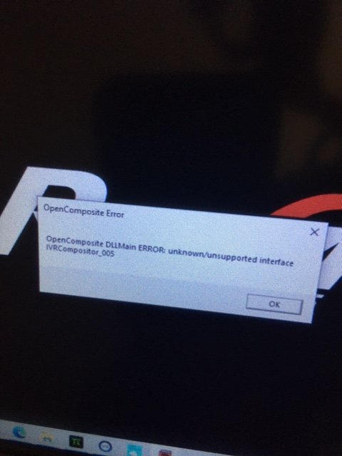

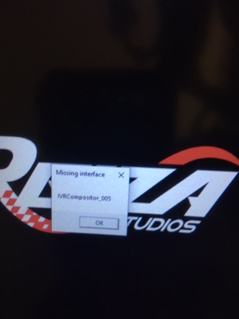

    thanks for helping me getting it running. i do get two errors though which mean I have to take the headset off and press return to remove them, then motion compensation and the game starts.
    chatgp says the "
    OpenComposite DllMain ERROR: unknown/unsupported interface IVRCompositor_005
    This means the game you're launching (e.g., AMS2 or another sim) is trying to access an older version of the SteamVR compositor interface (IVRCompositor_005), which is not supported by the version of OpenComposite you're using."
    but the link it gives me for the FORK version is broken;
    Recommended build:
    https://github.com/ezio84/OpenComposite (OpenXR Fork)
    Download the latest “OpenComposite OpenXR” binaries from the Releases section (not the original GitLab version unless you're sure it's OpenXR-compatible).

    Did you try this:
    1. Remove or rename the original openvr_api.dll in your game folder (e.g. openvr_api.bak).
    2. Copy the new openvr_api.dll from the release to the same folder.
  13. Fahim
    Fahim Member
    Dec 11, 2008
    477
    553Coins
    Yes but i did not change the old file to.bak, i Just put it into a new folder called "older version" which I created.
    I thought only the new one would be used. Not both together.
