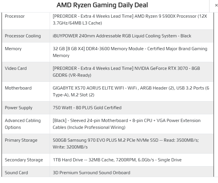

    How about something like this ?
    20,567
    145,220Coins
    +10,782 / 52 / -2
    That is a pretty powerful computer that should let you push simulation titles pretty well on a Quest, with some headroom for the immediate VR future.

    Thanks a lot ! Should also have room to grow ? +- I used you specs as a guide line. Their is some time to ship delay (about 4 weeks ) and it would be under $2700. Sound about right for our times ?
    So, are most of the games more tied to the net or can they be down loaded and played off line?
    20,567
    145,220Coins
    +10,782 / 52 / -2
    By room to grow I mean things like the motherboard, CPU and RAM are likely adequate to support this and next gen GPU as a possible upgrade path.
    On price all you can do is shop around, keeping in mind that there may be end of financial year and other pending sales, which are often a good time to buy, if you know what you want.

    Your configuration looks good. It may be necessary not to force too much on the details and the supersampling.
