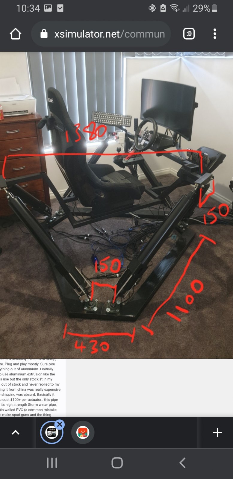

    Thanks for that chris also i can see on one of you photos you have the dimensions of the base plate. Are you able to do the same for the dimensions of the cockpit frame? Also is there anywhere on this website that shows you how to tune actuators using flypt or are you able share some settings as im gonna use the same 500mm ball screw length as yours

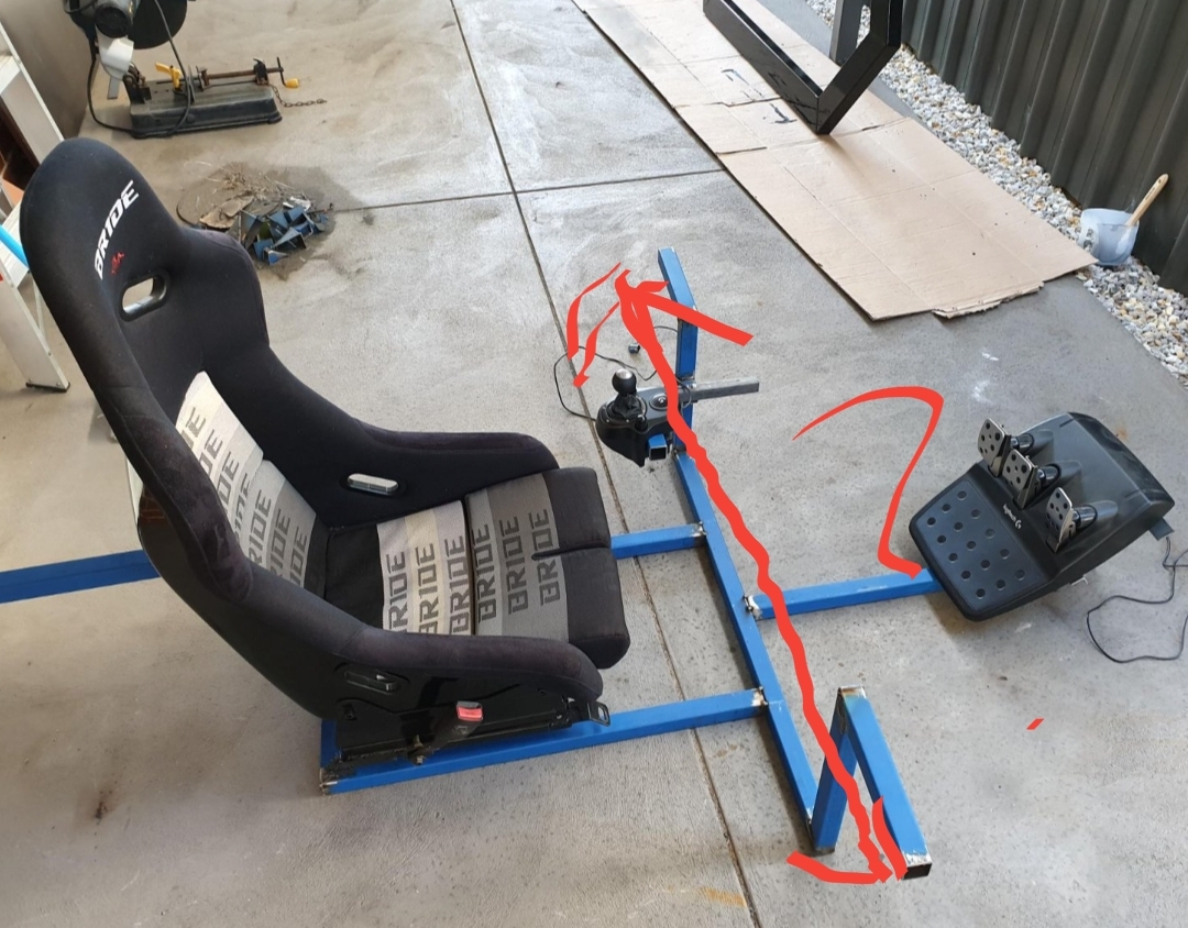

    Hi peacemaker can i ask a quickie.
    Attached photos what is the distance from left bracket to right side is it the same distance as side bracket to the back bracket shown in 2nd photo. TIA

    Hi I'm not sure if you have seen his YouTube channel but look at the thanos controller review at 29.30mins and it has his flyPT mover dimensions which will help you with your dimensions. I think it does anyway
