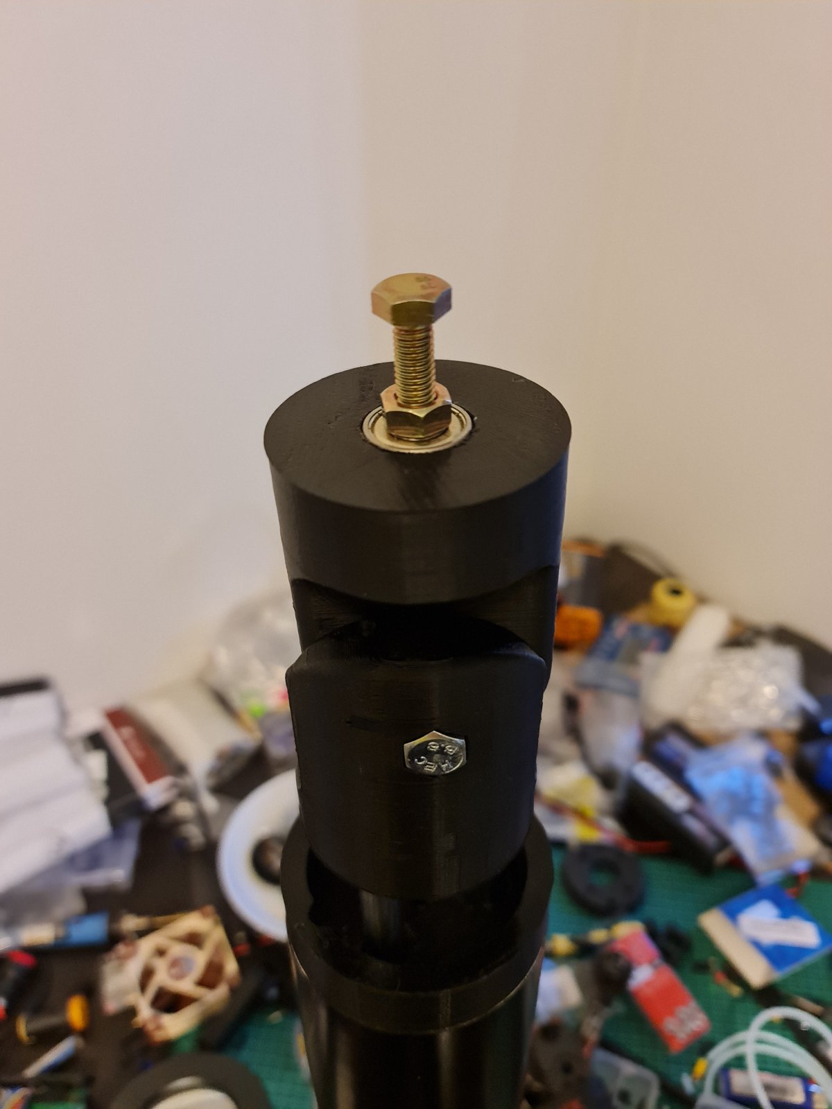

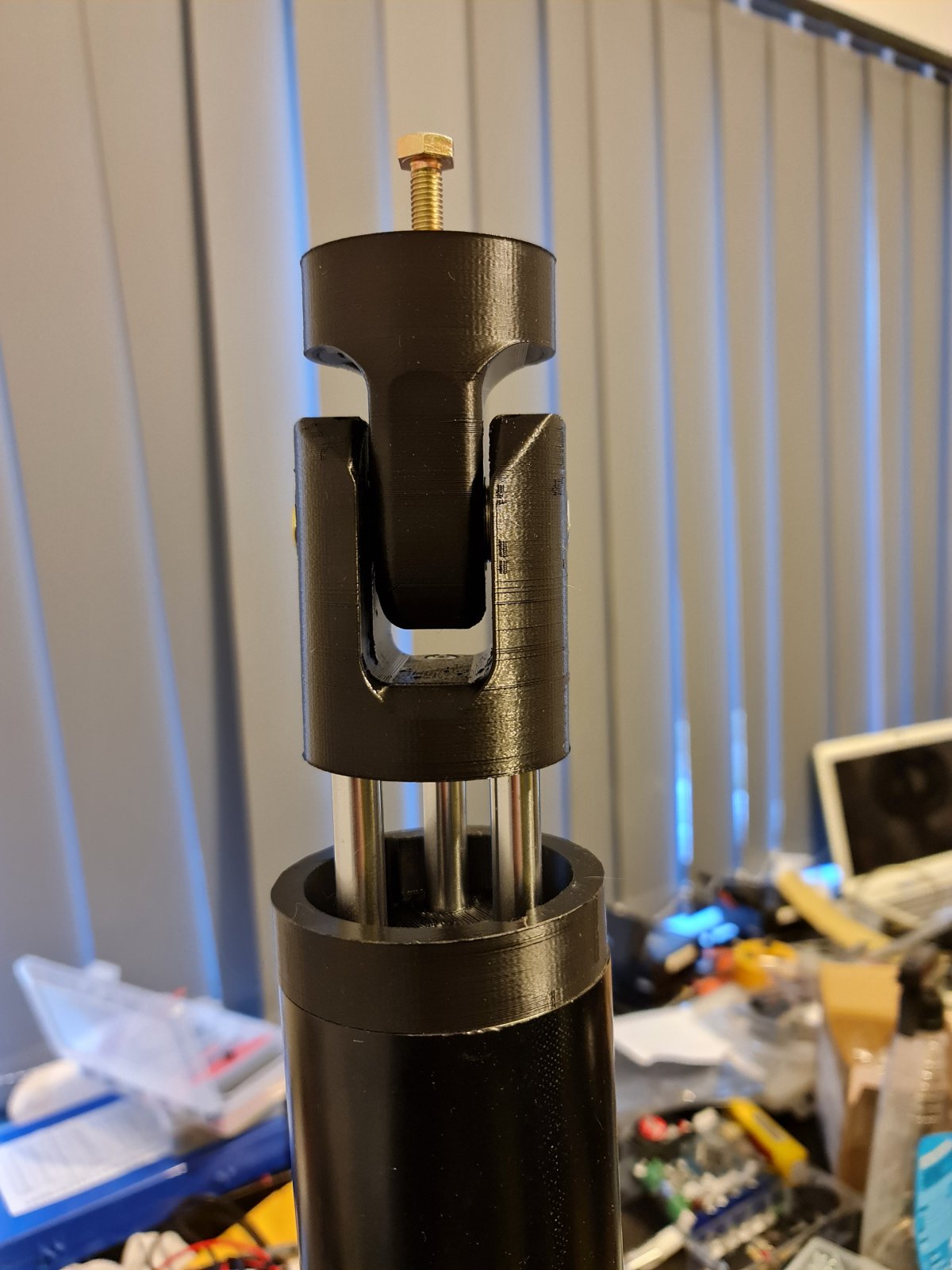

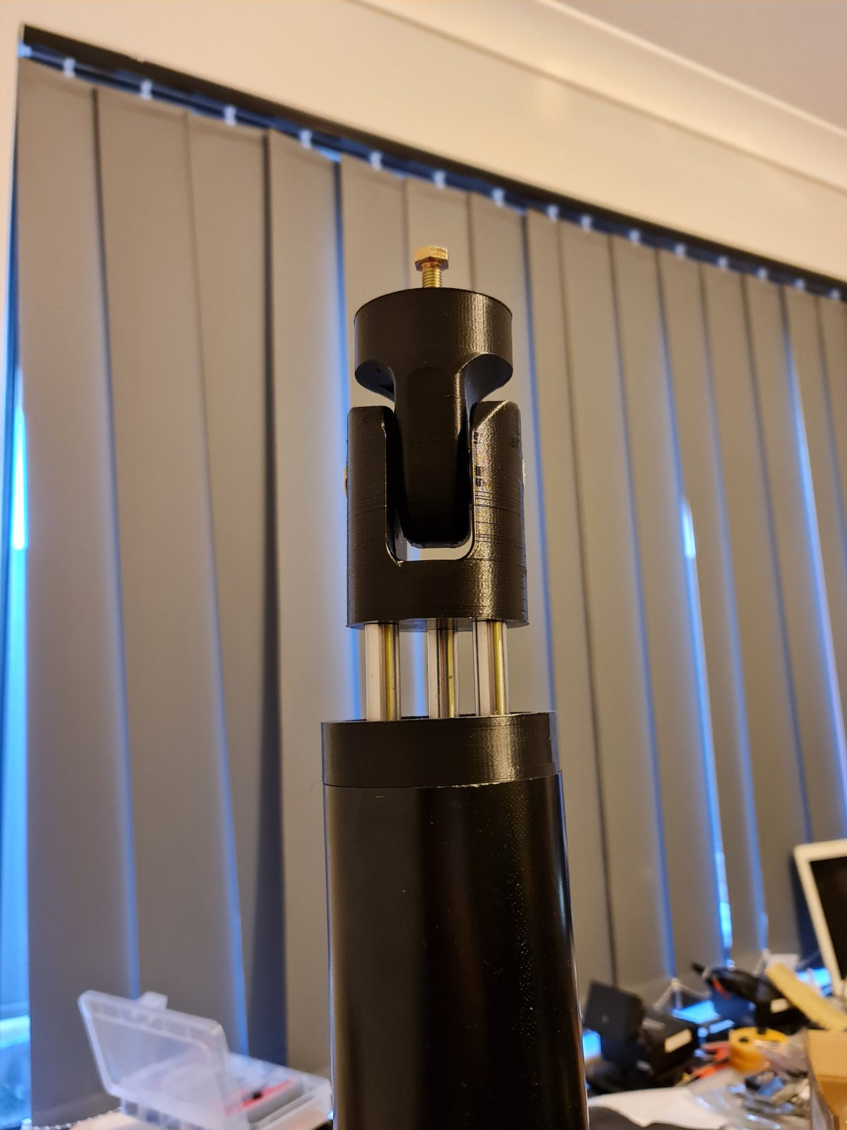

    Here is the prototype top joint I might use in the final setup. Rotating universal joint inspired by PT Actuators. One at each end.

    Am I seeing this correctly...is this a joint that can only move on one axis? Is that enough, or do you mean to make it rotatable with a center bearing at the screw-on point?

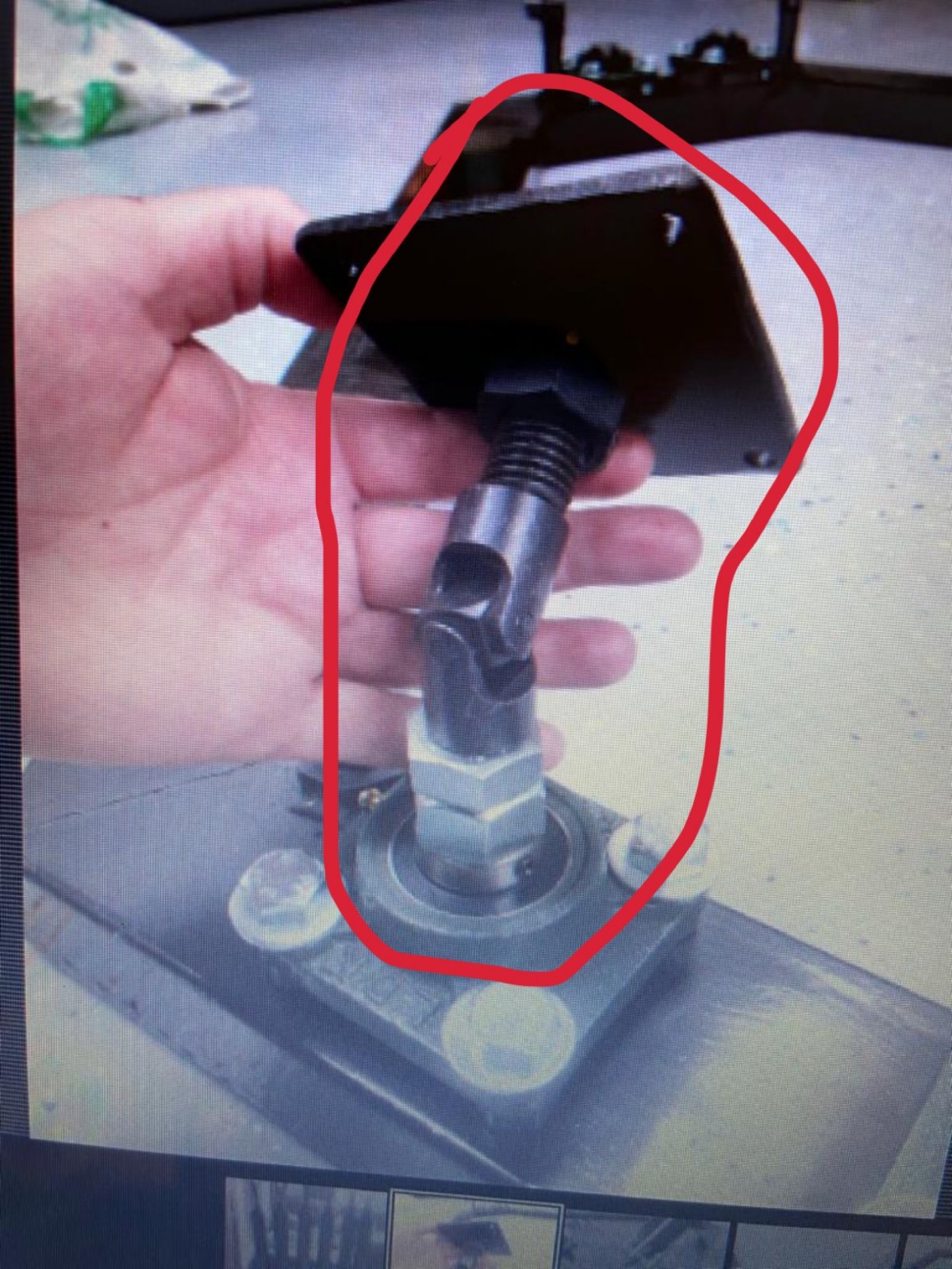

    Motion platform, 6DOF
    Hi there,
    Hope you are well, just a query I’ve bought the pillow flange mount but I’m struggling to find the joint that goes into the mount and would be happy if you could help link me to helping where to find it as I know it’s a crucial point in building my 6dof.
    Many thanks

    I think you need something more beefy than that, like this universal joint with rotation:
    http://www.pt-actuator.com/products/p5/53.html

    Hi
    I think you need a different bearingblock Single row bearingbllocks cant handle axial and radial forces.
    You need a doubble row angular contact bearing for it, and they sit in a FK10 /FK12 bearingblock.and bigger
    This bearing sits also on the PT actuator joints Thanos is given you
    regards Ad
