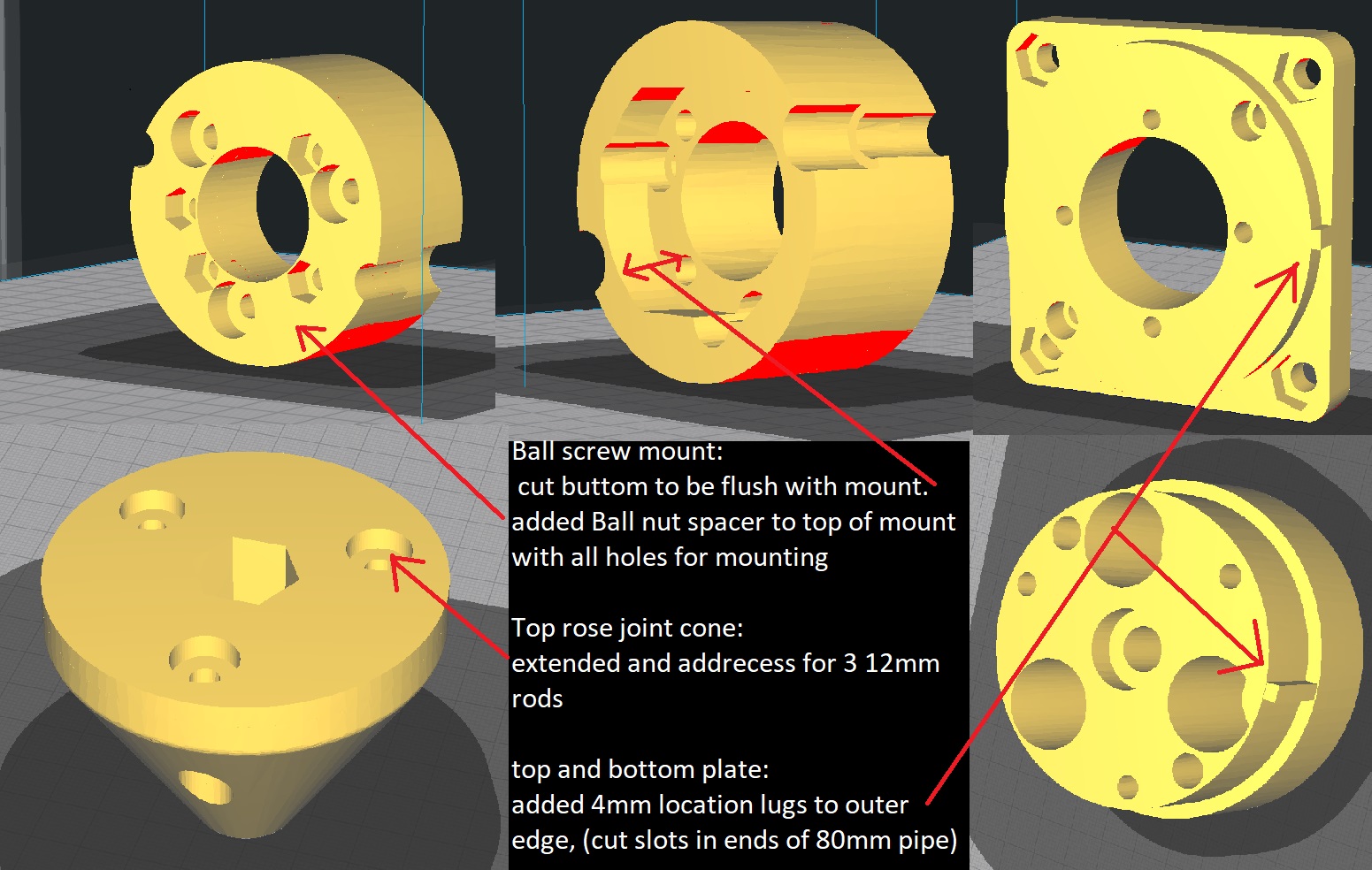

    Here are my modded files, not perfect, but you can work with them, and they fit together ok
    Cheers

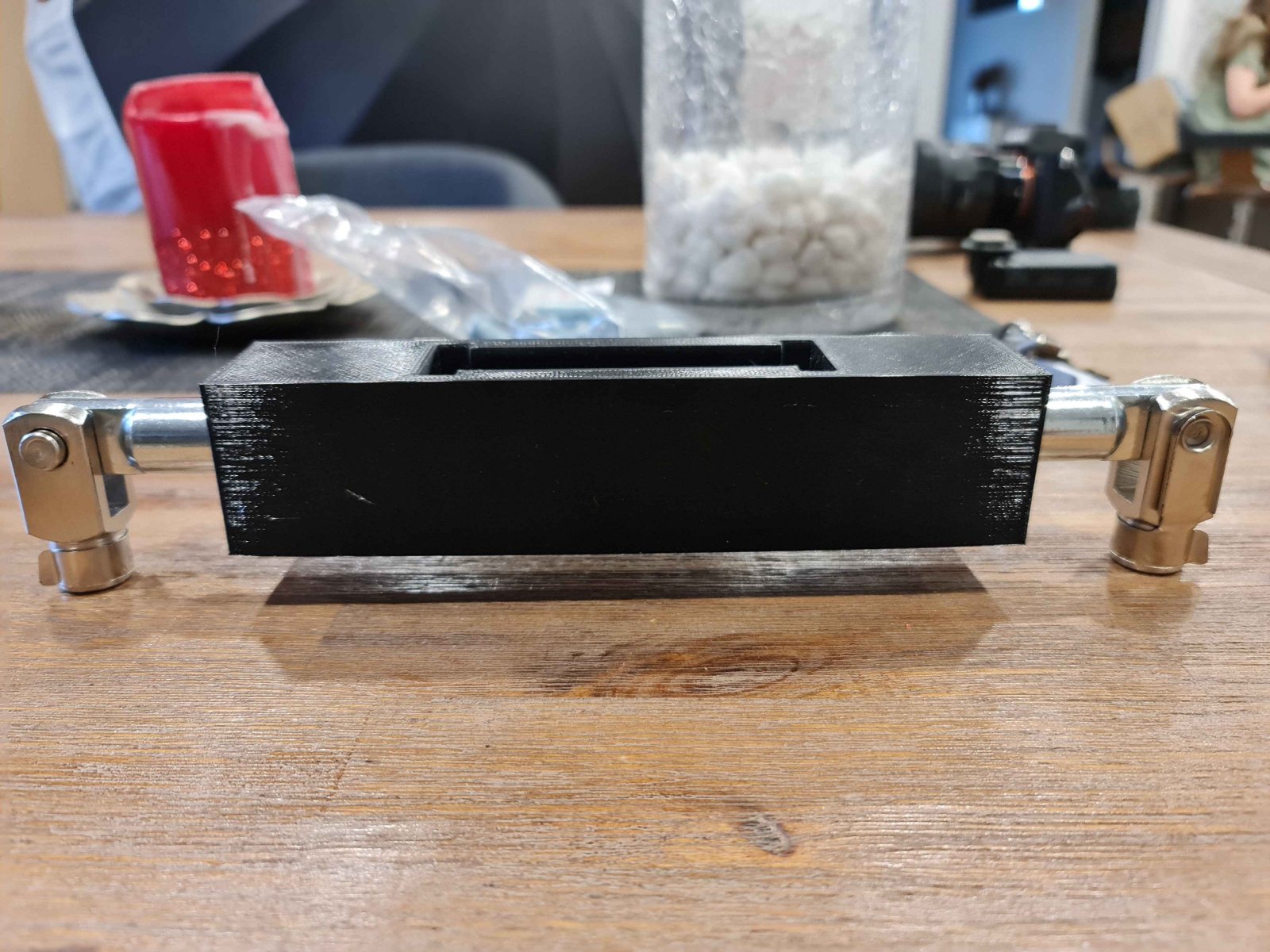

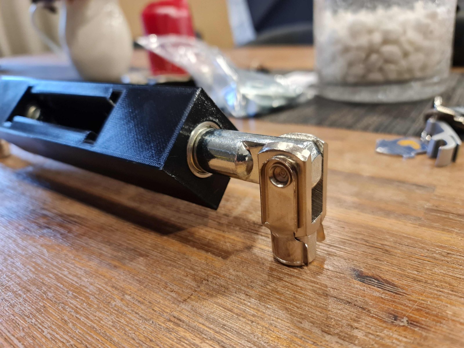

    Here's the new Clevis joint system i designed to replace my Rose Joints at the top of the actuators. These have like a 120 degree rang of movement so shouldn't have any issues with binding/jack knifing. :)
    20220726_160957_compress45.jpg 20220726_161007_compress13.jpg 20220726_161023_compress25.jpg
    But to install them i'll need to do 2 actuators at a time.. and with the weight of the rig now its no easy task.. I have ordered a Scissor jack for my racing simulator. Sounds funny that i need a jack for my fake car lol. but hopefully this will take the weight of the top platform and allow maintenace and modifications in the future alot easier. Previously i would remove one actuator at a time ad stick a piece of wooden dowel under that point.. but with the weight of the front now with the screens its pulling up the rear actuators when i try to get the actuator back on. It gets real sketchy.. if you dropped it during that process you would destroy the rig and actuators and it would be a total mess.

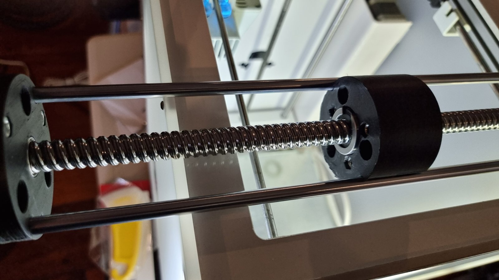

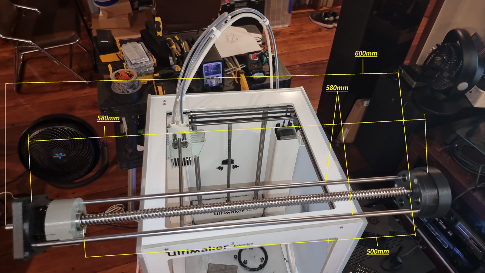

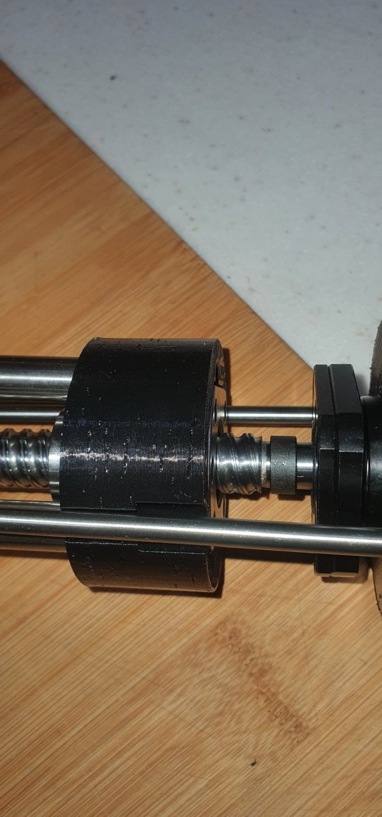

    Hi Peacemaker105 firstly, Thank you for sharing your project. I have started (slowly ) building the actuators.
    I am now fit checking the parts.
    This is where i encountered a weird issue. I'm hoping you could advise me on this one.
    I have part lenghts correct based on your specs., but when i placed them together , the ballscrew doesn't reach the bearing on the top hat. I know I can mod it by placing a washer .. But probably, but I'd hope to get your opinion or maybe I missed something that may be right infront of my face :confused::) .
    I attached 2 pictures..
    The first shows the dimensions and the second is a close up shot of the ballscrew end showing it's shortfall to the ball bearing .
    Hope you could shed light to my error...
    Cheers
    Jaime

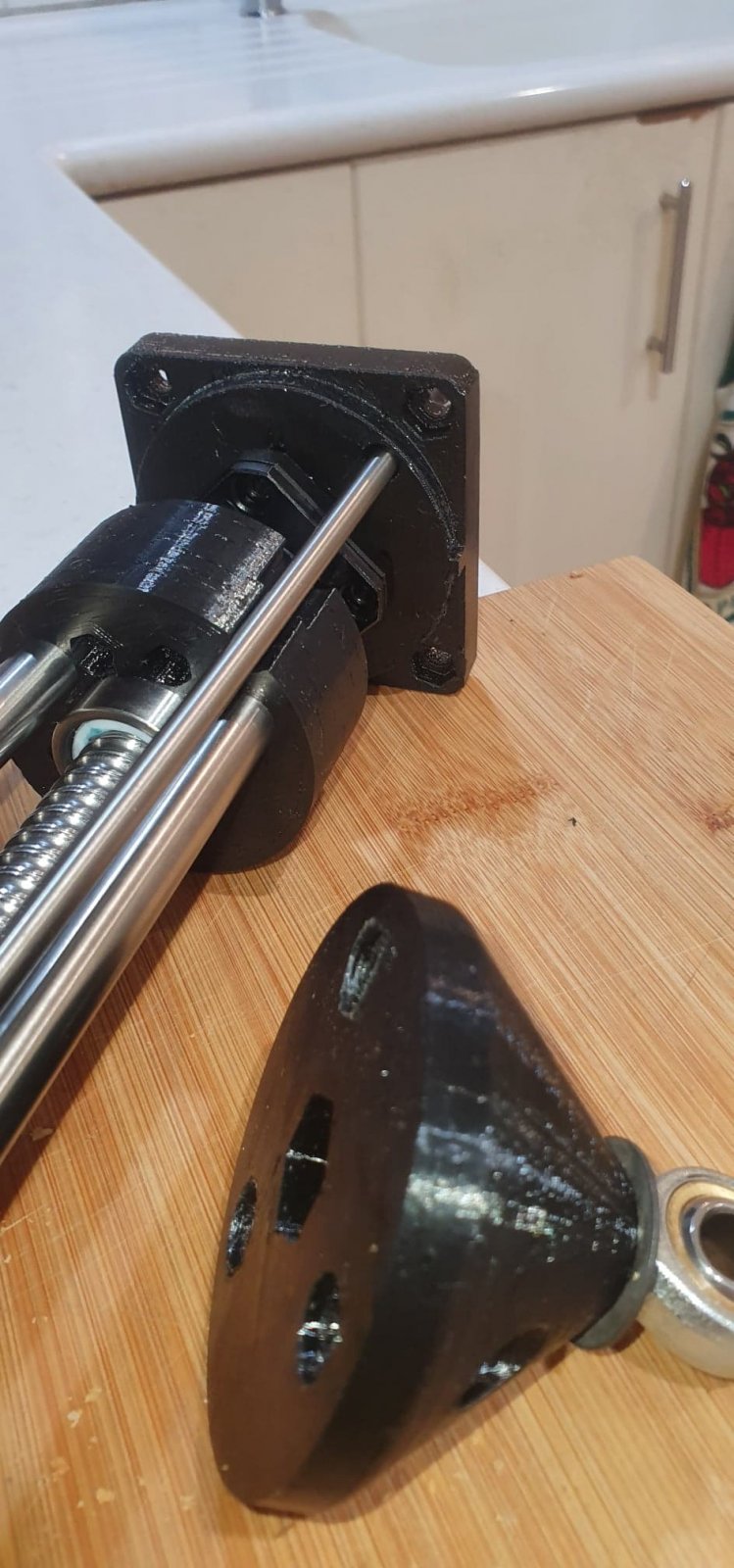

    I modified the top mount, so I could use my 500 mm guide rods and 500 mm outer casing, so I did not have to cut and re-tap them.(I have 500 mm ballscrews)
    Hi, you could put these in the top mount to lower the bearing into the the lower bolt on piece of the top mount.

    Ahh damn, I must of messed up when i measured it all. bit rough trying to measure it while its assembled lol. Thanks for raising it. I add 5mm to the bottom plate and the bearing will now fit into that piece instead. will this be enough you think?
    Try this file attached: you'll only need to print the small plate obviously but I removed the bearing hole in the big one as well while I was at it. I added a special one for you with the cut out for the nuts deeper so you can still use your bolts otherwise you'll obviously need 5mm longer bolts haha.
  10. Peacemaker105
    Jul 18, 2017
    197
    Perth, Aus
    2,006Coins
    +362 / 2 / -0
    ** I should also stress that the PVC outer tube should be 2-3 mm longer than your rods just so when you tighten it down it will actually pull tight. but not too long that your ballscrew end comes out of the bearing :). I have adjusted BOM to reflect this. All this stuff you keep remembering later is annoying but yeah. if you have already cut them and when its tight the tube still spins then you could just drill out the holes for the rods a couple mm longer also. Best thing to do is assemble it like @Jaime Godinez has done above and then measure the length from top to bottom seat where the tube will go and then cut a PVC tube a fraction longer :)
    Files have been updated to have:
    1. Ball nut mount (single piece instead of 2 piece design)
    2. Top end plate bearing relocated to bottom half
    3 Top end plate bottom half extended 5mm to better mate with ballscrew
    EDIT
    4. Updated ballnut mount with correct hole spacing :D

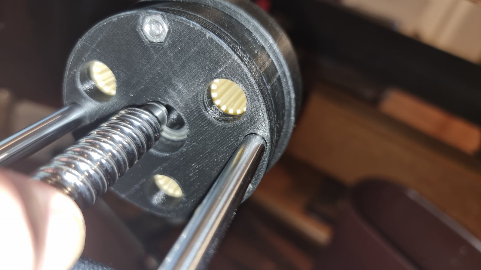

    Hi Chris, I forgot to mention that I first printed your top mount, Ball nut mount and separate spacer to try them out and the holes for the three rods were out of line by a fair amount, so the top mount would not slide through the 3 rods at all. I used your top mount as a stencil and remade the holes in the Ball nut mount, so that they line up correctly. The ones I made are in the zip I posted if you want to check it out ? Cheers

    Hi Chris, Thank you for the updated files, I printed the single piece Ballmount and the top endplate Bottom V2 with File Version 3.1.1 and the bearing now sirts on the ideal location. Travel now is at 490mm I have not yet tried the 12mm rods since it still has not #@% Arrived hehe....When they do I'll do another fit check using 3.2.1.. Cheers

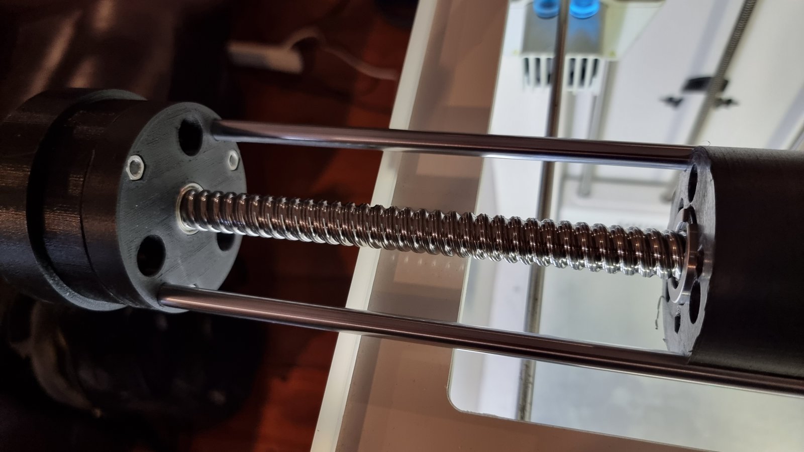

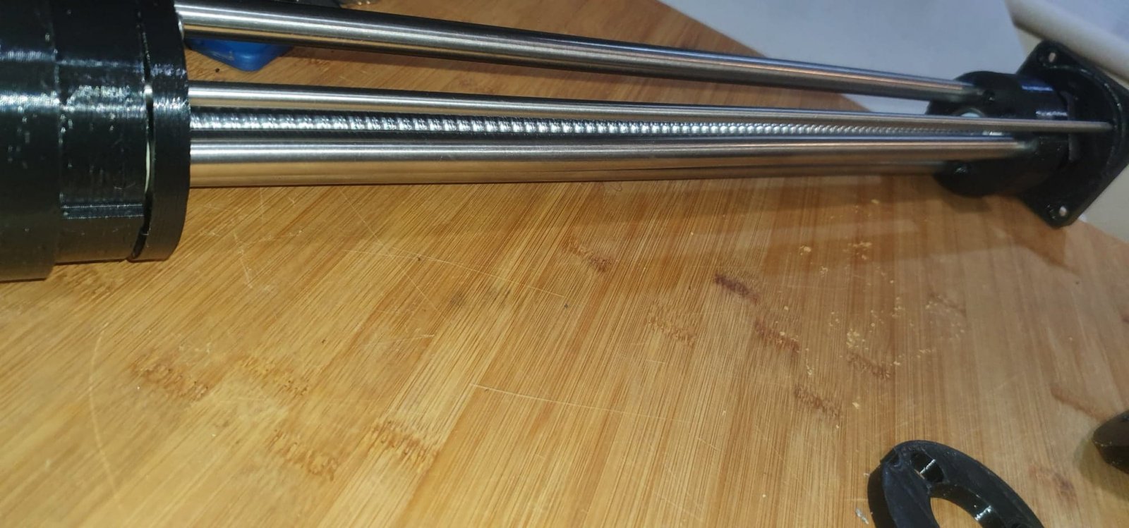

    Just wondering if you could share where you got your C5 ballscrews... I got mine from Aliexpress... it all seems ok , but when i loop the actuator medium and slow speed .. there seems to be a vibration..
    Initially, I noticed a wobble when the top end plate wasn't connected , then the wobble got tamed as i placed the top end plate and then better with the pipe on... but still not that smooth when running the actuator... it does have some vibrations especially towards the ends.... I just want to buy from another supplier to compare or rule out the issue.... Cheers
