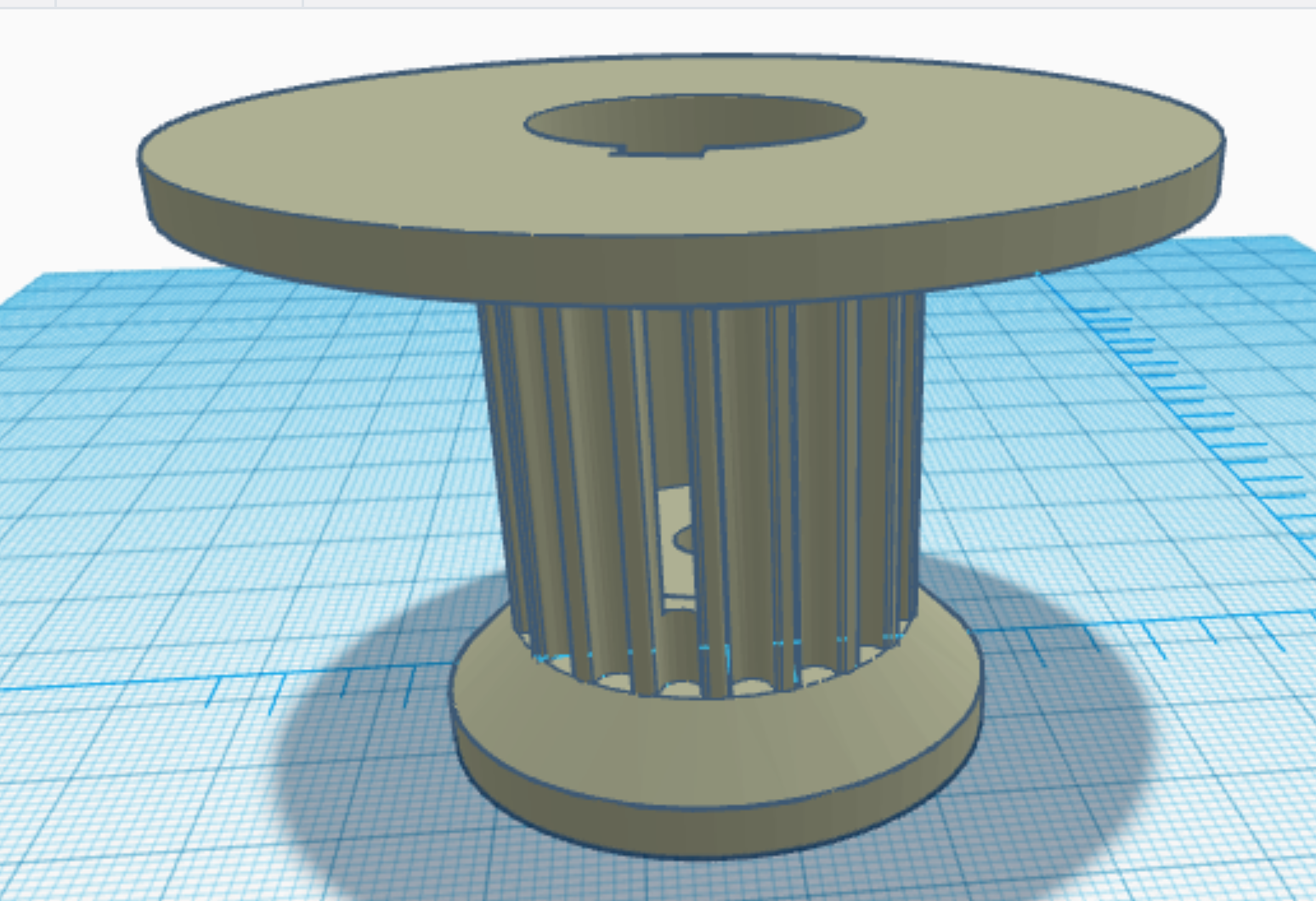

    In Tinker cad I created a shape with your part which removes all additions and mods to original and creates a solid part, I just sliced this in Cura and there were no gaps. cheers
    File deleted as it was incorrect and Chris is now supplying this part with the kit..

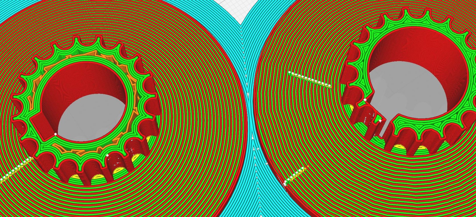

    Hmmm.. I still get the gap. I wonder if it is my Cura settings :think I'll post both on my Cura .... My file on the left

    Ok.. I kinda found a solution, I went back to Fusion and rotated the shaft and key by 5deg , it centered the key slot between the belt gear peaks :grin

    You were correct, sorry, I just looked from the underside of the part... once I stripped the slice down to half way I had the same thing. I just tried moving the keyway, so the corners are at the widest part. This still protrudes into the belt grooves, which will be a problem when the belt runs over it... I wonder if Chris added an extra slot to the pulley making the outer diameter wider, allowing for the bigger shaft ? I will wait, and hopefully he can set us straight on how it is done.

    Ok, here's a version that i got to work on. I rotated the shaft 5deg to the left and i needed to move both holes by about 0.9mm back . I was initially hesitant on moving the holes off center, but then realized that we will not be spinning the spindle like a linear actuator... :D Anyway , please check the file if this is alright for you.

    This one is centre bored and has correct keyway size for 80ST. Still has the smallest .2mm gap on one of the lower gears. I sent it to Chris who made the originals and asked if he wanted to see if he could fix it on his cad program and add it to the other files for others if they have the same motor as us.
    I am only using Tinkercad so it is not great for tiny details.
    This part takes just the right amount of pressure to push onto my motor with zero play once all the way on the shaft.
    Part removed, as Chris has sent out the new one by email to those who need it. I am doing a test print of that file now.
