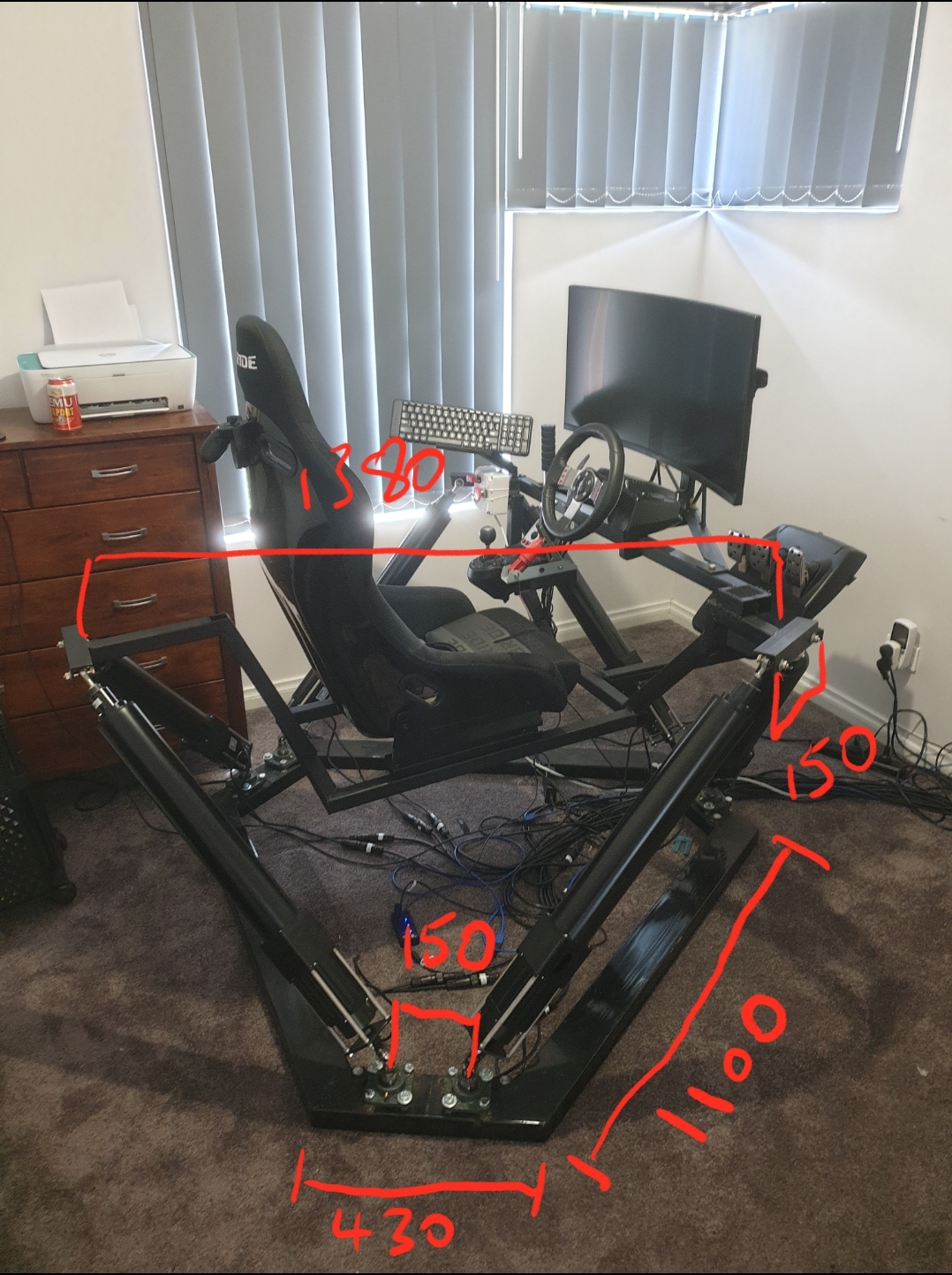

    @hannibal Sorry mate i totally misread your question few months ago lol. Here are the dimensions. Probably a bit late now but maybe others may benefit from it, regardless. :)
    Upper Platform is 35mm steel tube (2mm wall)
    Base is 150 x 50mm Steel tube

    this looks like the best setup i've seen so far! thinking about doing it this way however i have couple of questions/ideas:
    1. have you though about using aluminum pipe instead of PVC one? also, i believe ends could be machined from aluminum instead of printed (cost of course).
    2. assuming you're doing it again from scratch - would you use SFU1610 (10mm pitch) with those servo motors? will they be powerful enough? 650mm length?
    3. if done with 650mm actuators - would entire thing be bigger due to longer actuators? like bigger base and wider upper construction?
    4. what do you recon as lift capacity for SFU1610 with this servo motor?
  10. Peacemaker105
    Jul 18, 2017
    197
    Perth, Aus
    2,005Coins
    +362 / 2 / -0
    Hey mate, yeah it's definitely the easiest setup, that's for sure. Plug and play mostly. Sure, you could do anything out of aluminium. I initially was going to use aluminium extrusion like the sfx actuators use but the only stockist in my country was out of stock and never replied to my emails. getting it from china was really expensive because the shipping was absurd. Basically it was going to cost $100+ per actuator.. this pipe cost me $7. its high strength Storm water pipe, not flimsy thin walled PVC (a common mistake when people make spud guns and the thing blows up in their face haha) You will never break this stuff and i am really happy with it. Plus its round which looks nice and almost 20mm slimmer in diameter.
    I had already spent a shitload on the first DC motor design so was looking to create a cheap and durable actuator whilst still using as much of my parts as possible. Sure you could start doing bits and pieces out of aluminium but it would be more for aesthetics at this point and be way more expensive. I've done about 40 hours so far and all is good (fingers crossed). It's very easy to want to over engineer the actuators and there's nothing wrong with that but i also want to be able to service them easily too so a big part of my thinking when designing them was that as well.
    As for taller actuators, yeah you would want a bigger base and platform for sure.. and a bigger room lol. In the future i'll upgrade to longer ballscrews but for now it's serving me well and i'm glad all that time and money didn't go to waste. I'm 100kg and after a couples hours of racing the max Watts pulled from all 6 actuators is 570w total! i have no problems thinking these motors could handle a 10mm pitch ballscrew even perhaps a 25mm one.. but definitely a 10mm no worries. When designing your rig have a play around with dimensions in FlyPT Mover and get a feel for its range of movement and limits etc and go from there.

    thanks for fast reply! i will go ahead with SFU1610 650mm and i will try to make it all aluminum. i can see in your videos that this whole thing holds surprisingly well! i just want to be on an extra safe side. alloy tube will cost me $10 in Poland... i will also make internal rod aluminum instead of carbon (that will actually be 3x cheaper for me). i will also try to find a shop that can machine alloy end caps for me.

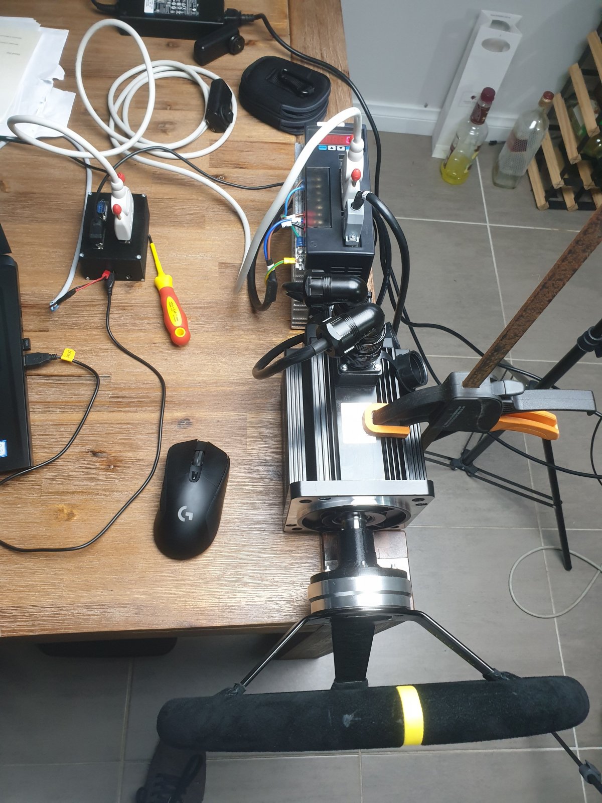

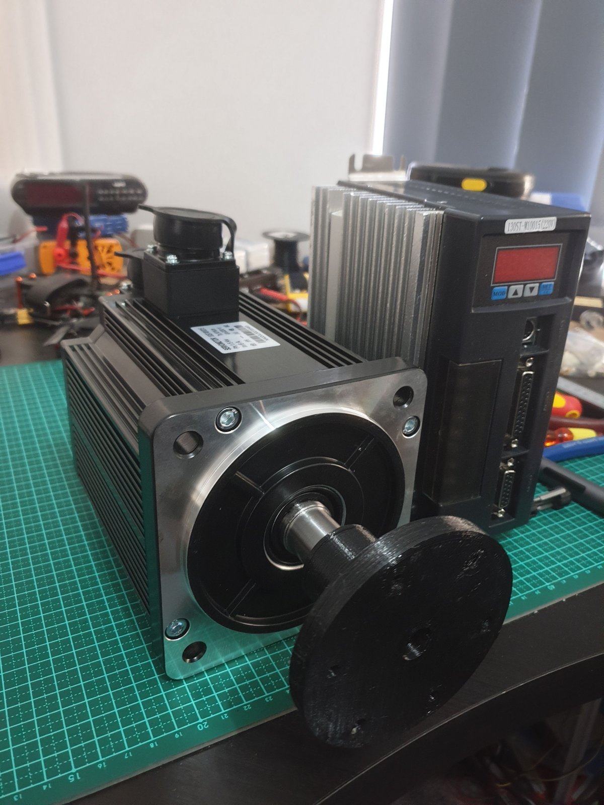

    Here's some details on that next project for that:\
    Cost Effective Direct Drive FFB Wheel Solution
    130ST-M10015 25NM Motor (Medium Mige? haha)
    30A AASD Driver
    STM32 Discovery - Running MMOS
    OMP style flat bottom Rim with 3D printed button box - Mag Paddles + 12 Buttons + 4 rotary encoders
    BlueHID Bluetooth Button Transmitter
    Quick release etc
    All for under $500 USD delivered!
    Stay tuned and i'll let you know how the progress is going. I'll start a new thread soon to document the build in the proper category.
    Final piece of the puzzle arrived today. Sucks because you kind of need to wait for everything to film otherwise i would have had everything built ready to bolt on by now haha.

    Peacemaker, i am interested in your wheel build
    I built a dd dc wheel a few years ago and it worked pretty good bit gets hot after a while.
    Keen to see what you think of your mige wheel and where you got the parts from.
    What made you go 25nm over 20nm is there less fidelity with more torque ?
  20. Peacemaker105
    Jul 18, 2017
    197
    Perth, Aus
    2,005Coins
    +362 / 2 / -0
    Hey! So quick answer.. cost. This was $30us cheaper.. for some reason.. but it has the same low inertia as the Small Mige with more RPM and torque.. whats not to like about it? haha. The seller i use had it cheaper than the small and big mige.. every other seller has it sitting in between for price.. as you would expect.. they must have an over supply or something, who knows. I use seller: Two Win on aliexpress. think they're cheap for me because they post from Singapore, they must have a warehouse there.
    Just got it up and running! Feels good but needs some dialing more dialing in. It also has a noticeable hum/vibration feel when turning.. hoping i can filter that out somehow.. could be because i'm only using a 2500PPR encoder.. not too sure. But even with the vibes it's feeling good. I'll keep you posted soon enough :)
    Edit: yes sorry, you would want something smaller for motion.. this thing is 4x the size of my motors haha. Unless you're building a simulator for Boeing
