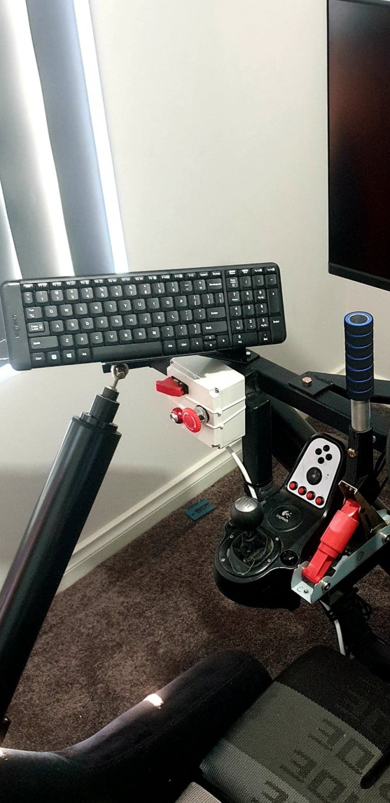

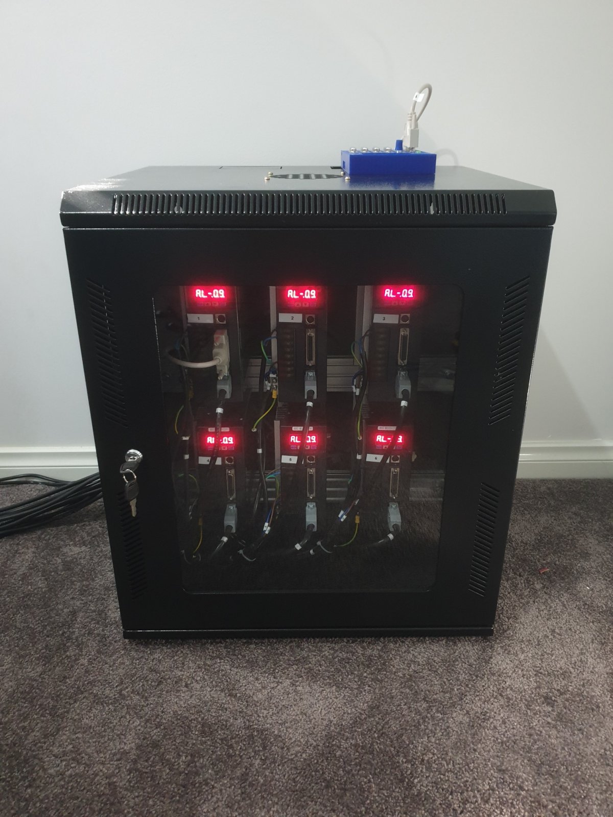

    Hey mate, that button box i purchased of a guy named @Bajer on Thanos's Discord server. I'm guessing the guy i just tagged here may be the same person, we'll soon find out haha. But he sells it in either kit form or built. It's a nice bit of kit and complements the AMC-aasd15a controller nicely and my rig too of course :). I would of made my own but i'm too busy doing other more important things like DD wheels haha.
    Looks like Thanos has got you covered already though for the DIY side of things.
    It's a step up from what i had... i mean it was fully functional but was just a bit industrial for my liking lol.

    Yeah that looks a bit industrial indeed....i guess it works. ....i just had the idea you owned the one with the 3 LEDs in it....
    well i guess i figured it out with the wiring diagram of Thanos...i need to get a bit of time to get me going, but i want to make a new Design of the Emergency Box, using 5mm leds....got a lot of them laying around and easier without the mosfets.
    i will keep you posted... Thanx ;)

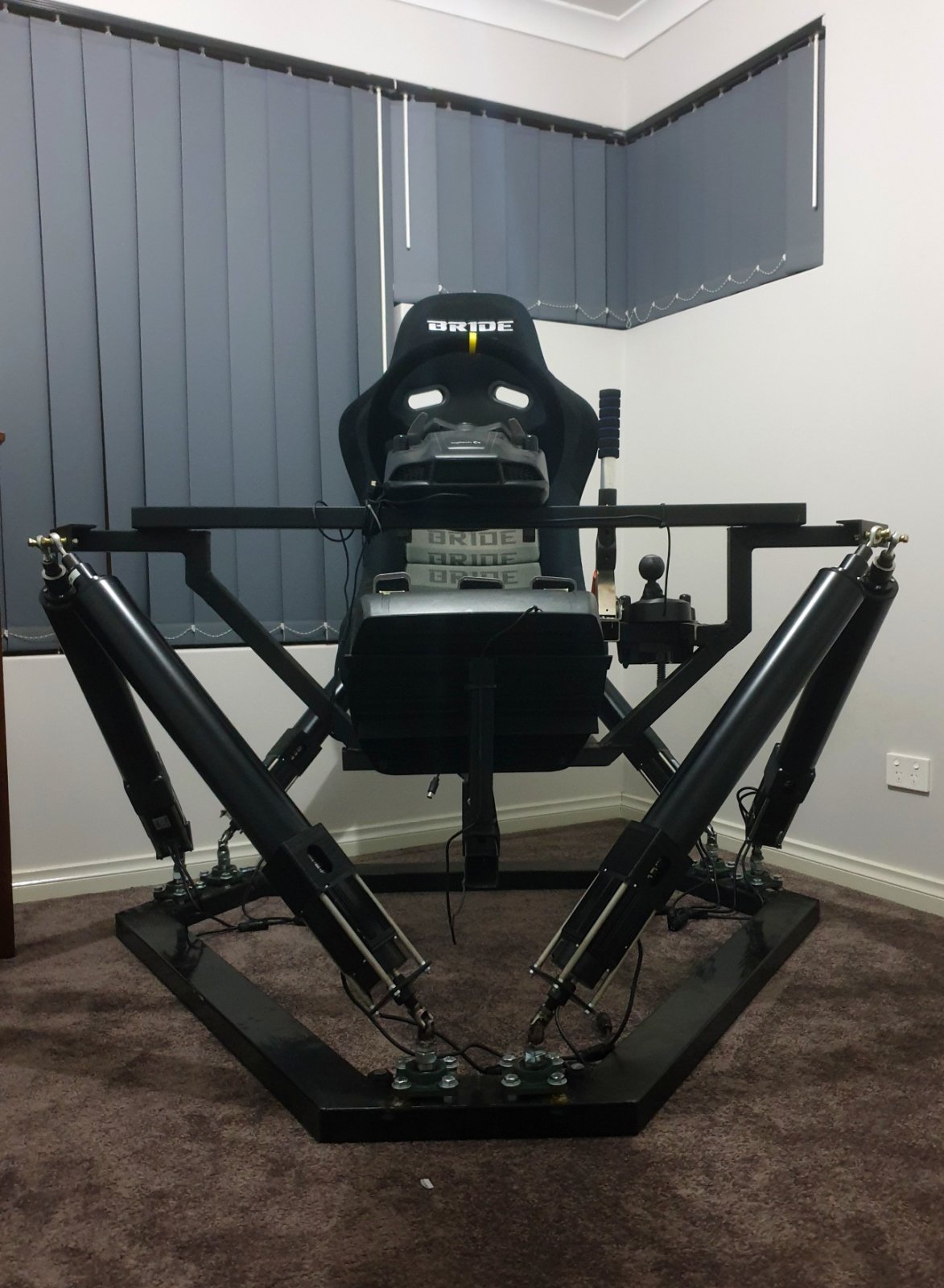

    Am adopting your actuator design and note that you mentioned that you wouldn't have gone again with the cheaper chinese ballscrews. Have you considered what you would have gone with instead as an alternative? There's a huge price differential between ballscrews. Hard to tell how to pick a good one other than country of manufacture and price. So seeing if you or anyone else in the community have got a suggestion for a reasonable but not over the top pricewise ballscrew suggestion?

    Look to be honest i'll probably just go cheap chinese rolled ballscrews again. The cost of expensive ground ones are just way to hard to justify if you ask me.. and for a noise benefit we haven't had proven yet. My main issue i think was i ordered mine through 3 different ebay sellers so probably from all different factories. Next time i'll probably just make sure i order all 6 from the same seller, maybe one that's got some decent reviews etc. That way if 1 ballscrew seems sloppy or a bit off you can tell them that 1 is not right and that the other 5 are fine and they can't sit there and tell you thats how its suppose to be because you have 5 others to prove otherwise haha.
    I would like to try incorporate some sound deadening or something in the actuator build instead. But i have no issues with the noise. once game volumes up you don't (barely) hear it.

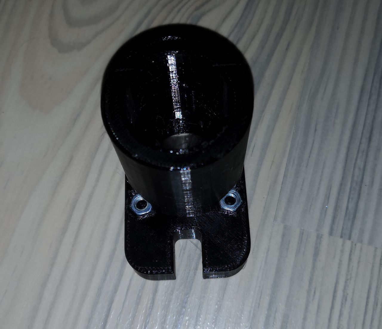

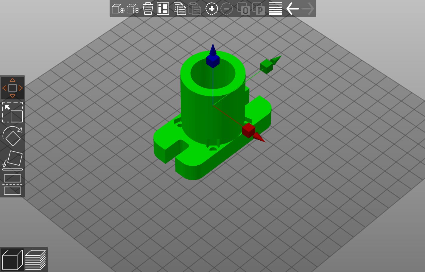

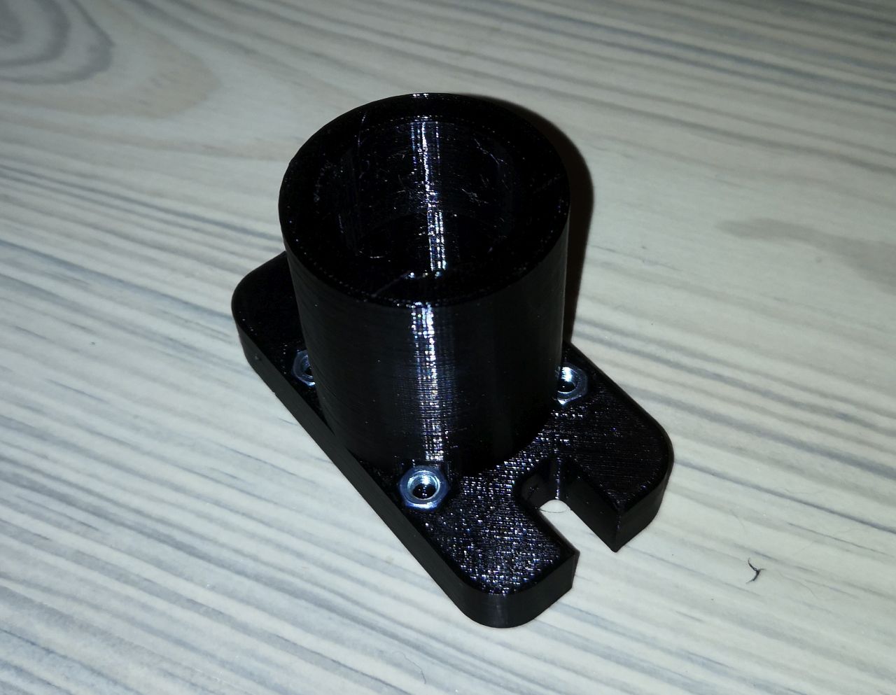

    Hi Peacemaker105
    Thanks a lot for your ideas ;)
    i modified the slider a bit so i can insert the carbon rod directly.
    the upper ring has a hole of 25,5mm so there is enough space for the glue ;)
    it looks like this:
    Here it is: slider-tower.zip
    Kind regards
    Peer

    thx. That simplifies things

    Cheers for uploading that man, Simply Awesome! Will help out many, i'm sure :) Even me for when i go 600mm screws :D. Cant wait to see you get one built.

    Definitely go 600mm if you do more flying. 1610 for the extra speed would be nice, you can always dial speed down a bit. as for dimensions don't be too worried, just scale it up 10% or so, she'll be fine :)
    I lathed my motor coupler because i could and saved me ordering all new ones.. and they're not cheap. You can just contact the supplier and ask for the correct sizes made no problem. And the rod to ballscrew joiner i lathed because thats how i did it back in the day but as posted above there is a 3d printable option for that which incorporated the slider into the design.. so no need to lathe anything :)

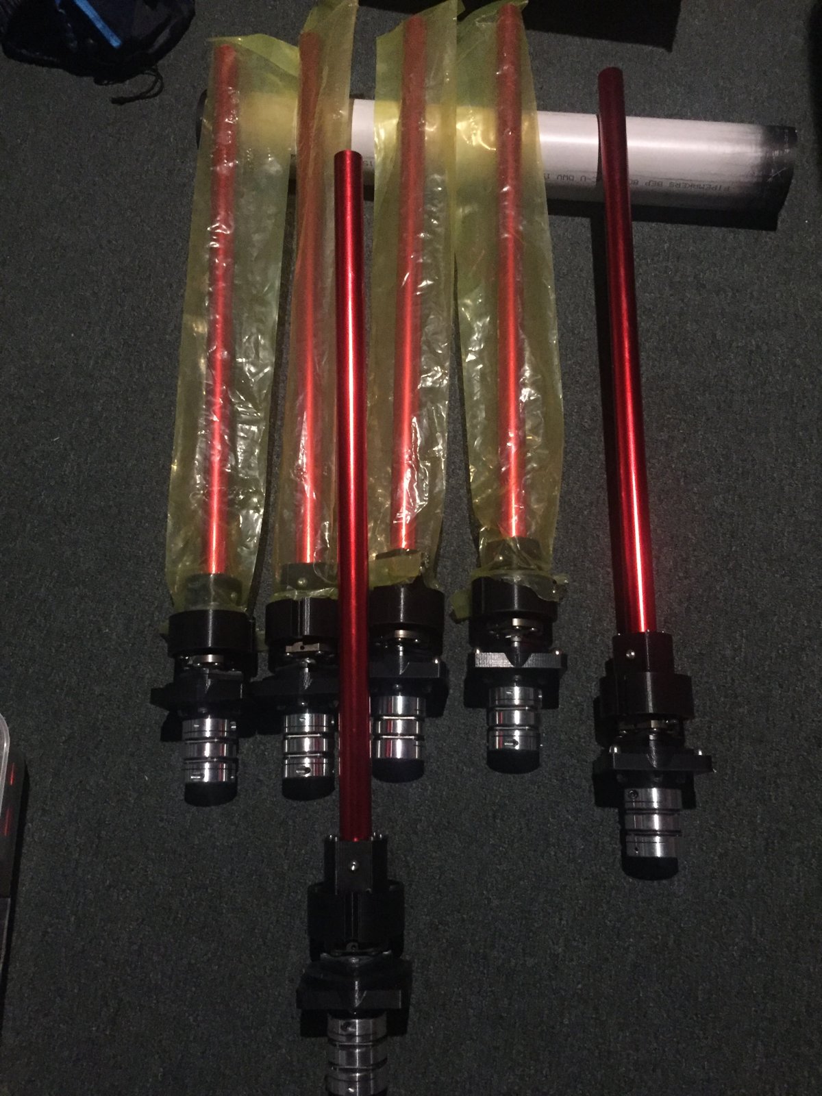

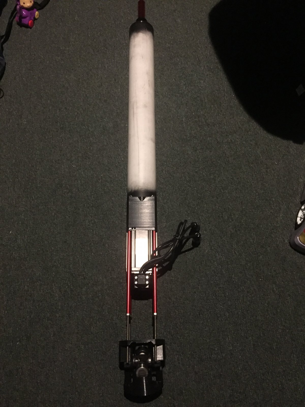

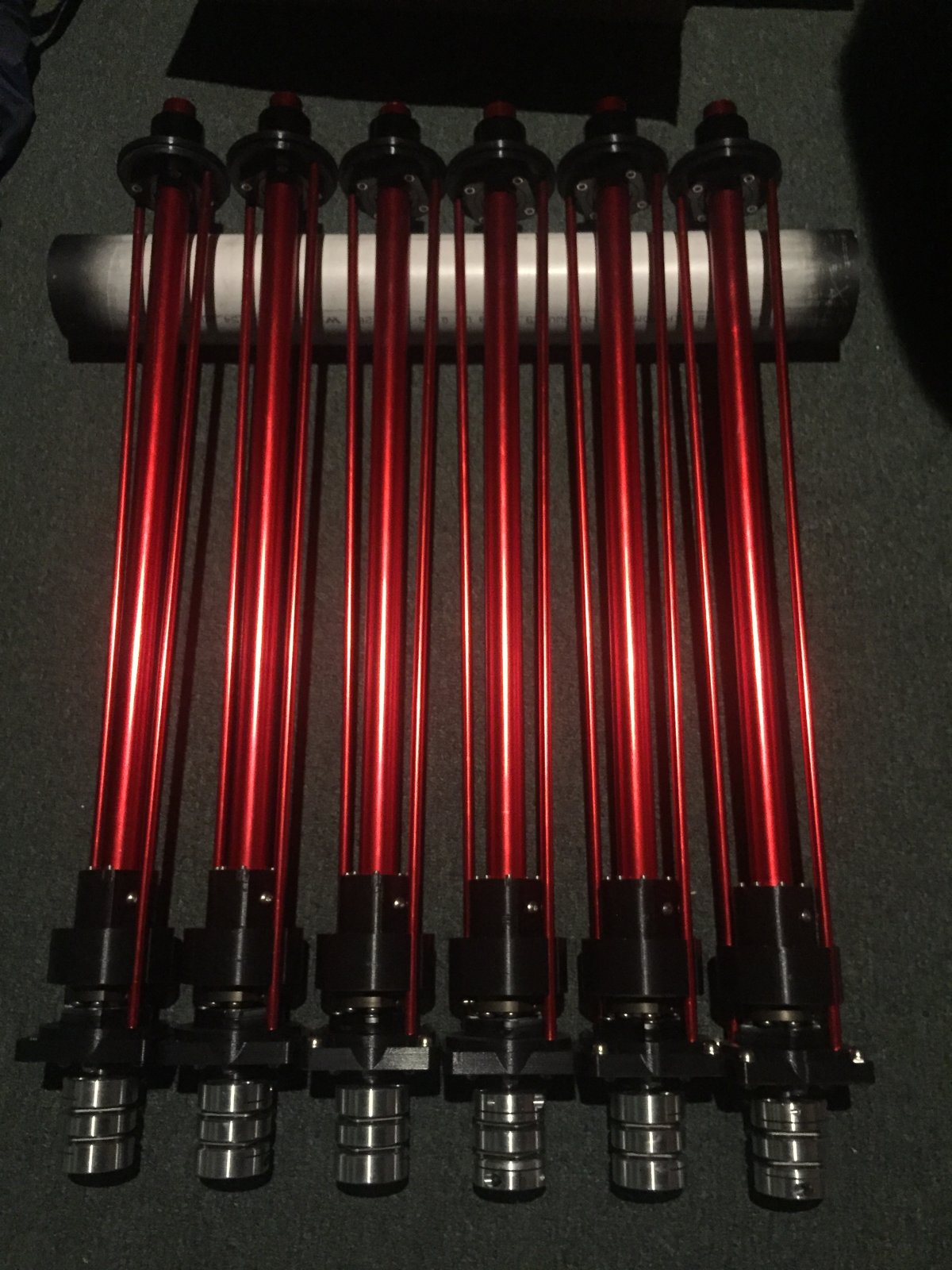

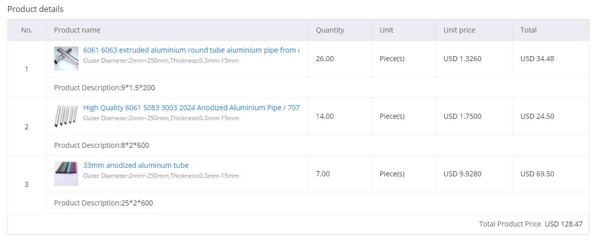

    @eloverphx, thanks. I am contemplating polycarbonate cover tubes...
    Here is a screenshot of the order.
    I used 600mm ballscrews, I could have gone 640mm ballscrews and still used 600mm PVC and aluminium tubes as there is 100mm clearance between the top of the ballscrew and the top of the aluminium tube (the threaded inserts I used are 35mm, so that gives me 65mm of room for longer ballscrews).
    I'll start a thread soon, when the build is complete.
