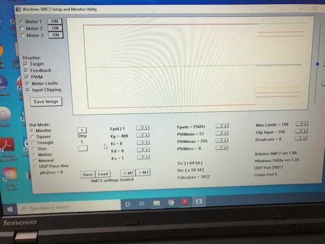

    I've been through the SimTools manual and at the moment just want to use the axis testing before i load a game to make sure everything is working, although i can't work out how to get it to move (still working fine in SMC3).

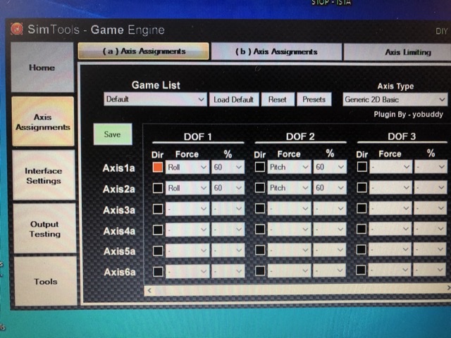

    I've got two motors at the rear of the rig, so set up the following axes:
    and tried the following interface:
    That's with the rig connected directly from the Arduino to the laptop (which is running SimTools).
    The only thing i did notice is that it won't let me click the save button on interface for some reason, although did let me create the preset.
    Any ideas guys?
    Thanks in advance

    For SMC3 your Interface Output for a 2DOF should be: [A<Axis1a>][B<Axis2a>]
    Set 10bit binary output
    Baud rate 500000 BitsPerSec, N , 8 , 1 (10ms delay)

    ok, i feel a bit silly now as i had missed the output string [A<Axis1a>][B<Axis2a>].
    Have put this in and able to save and have comms!
    However, i'm now struggling to get proper movement on the motors.
    I've tried a few different settings for the axes assignment but cant get this working.
    It seems a bit strange as i can slide the roll/pitch or try the specific axis output which does nothing, but as soon as i cross 0 and go to the other side of the axis, even just by 1 or two it sends the motor spinning to it's max range.
    I've attached a few screenshots as below, any pointers appreciated!

    You do not need a b designation in Interface settings for a basic 3 axis rig.
    For SMC3 the SimTools Interface Settings Bit Range should be 10.

    Noorbeast THANK YOU!!!!!
    turns out it was just the bit output set to 8 instead of 10, we now have movement!

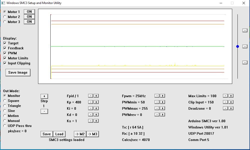

    Further to this, it’s actually not that jerky but seems when the motors are moving past their middle point upwards, they don’t move until I move the sliders in test mode in simtools to around 45-50%, I have no idea why!!
    Have tried changing Kp and PWMmin but hasn’t made any difference
    21,714
    151,991Coins
    +11,061 / 56 / -2
    It would assist others and troubleshooting if you post pictures of all of your settings.

    2C6BBF92-B955-4CBE-923D-54C1FBD20AA7.jpeg Pictures of cute settings:

    Uploaded a video showing the dead zone on pitch:

    getting movement in game but seems to give up after around 5-10 seconds and motor one just drops to lowest position, not quite sure why....
    pitch still has the deadZone problem if anyone has any ideas on this?
