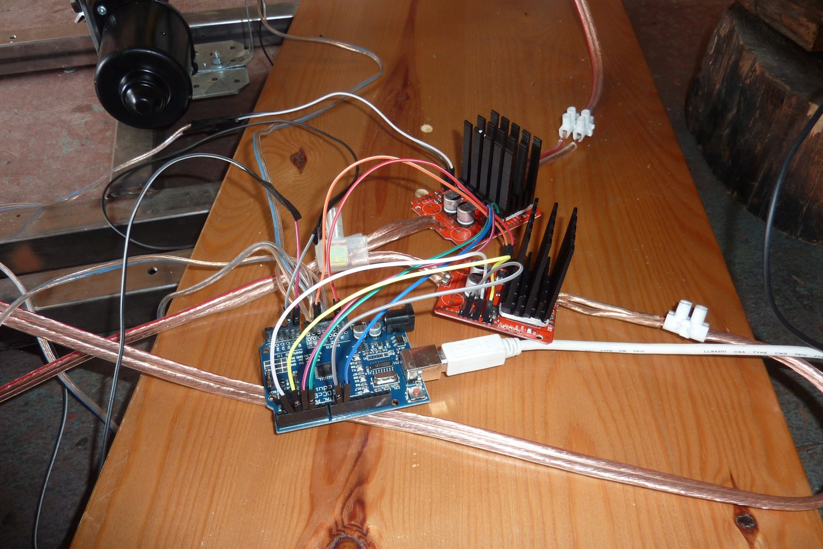

    Hi all.
    Finally got MM's to work (someone should update the documentation...) It was not an easy task because zero out of 4 worked as they should.

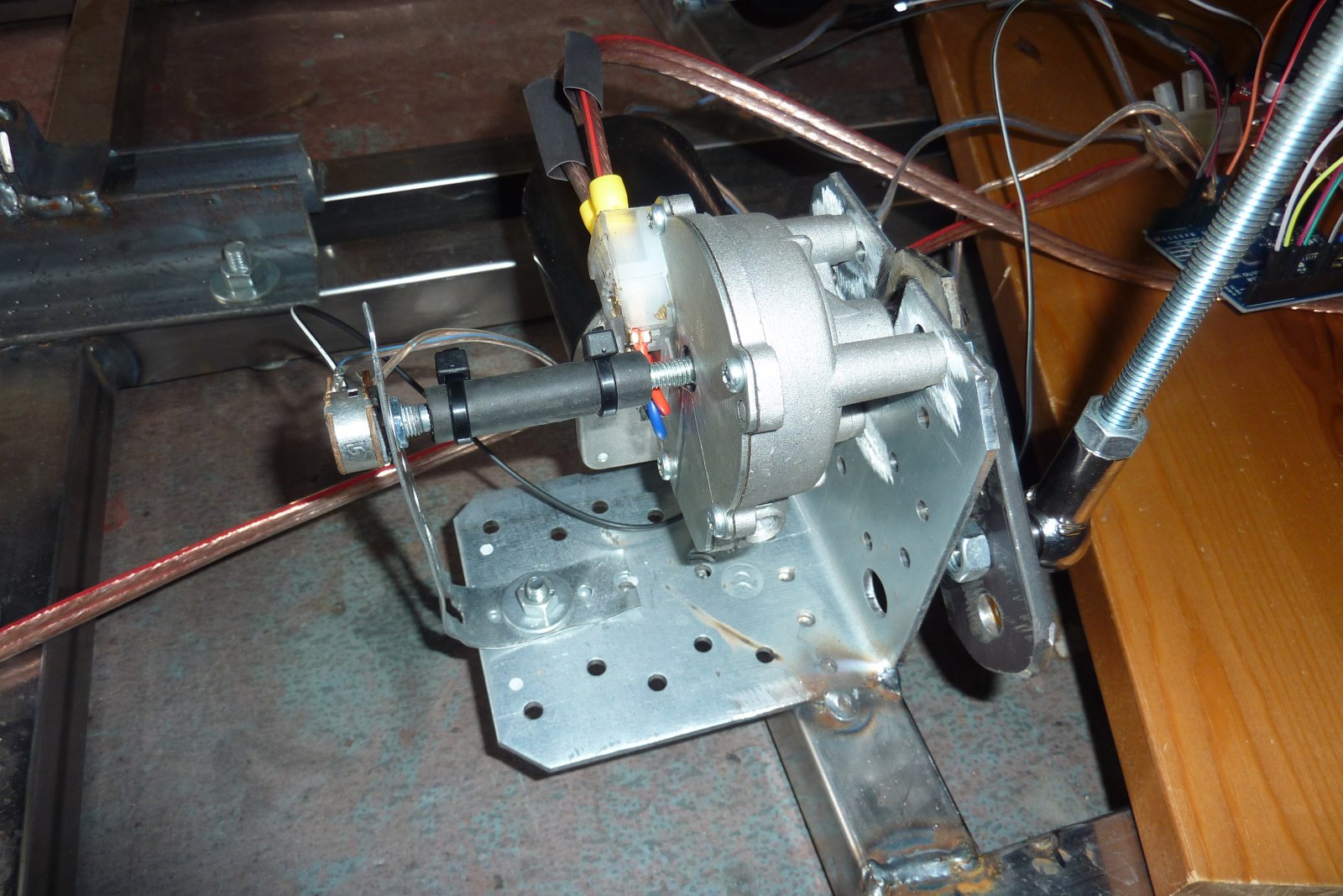

    But after hours and hours fiddling i got 2 of them working together (1 channel of each could provide enough juice to motors) -> I ordered some IBT-2's, hoping if they would work better. Heatsink is mandatory with these drivers, they get hot instantly after power on, but after applying these heatsink they don't get even warm (still temporary wiring in pic):

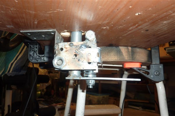

    During tests with smc3 util, i got mechanical problems and then decided to change pots to the backside of motors with flexible tube-mount:

    Finally got my motors changed. From 30W to ... 40W? Maybe, but they actually are not rated. Criteria for choosing these was that they had fixed lever, so it was easier to weld cranks. I connected them with new ball-joints. These must be more silent than my first ones, which had small play on each.
    After few test round, it was clear that one of my MM's couldn't drive all needed power to other direction, it acted very lazy. So, i took another job and wired IBT-2's. I'm so glad i had ordered them...
    After many hours, got most electric parts boxed...and CV-joint greased.
    It all seems good at the moment (i remembered to change smc3's mode from 1 to 2), just needs more tuning with software!

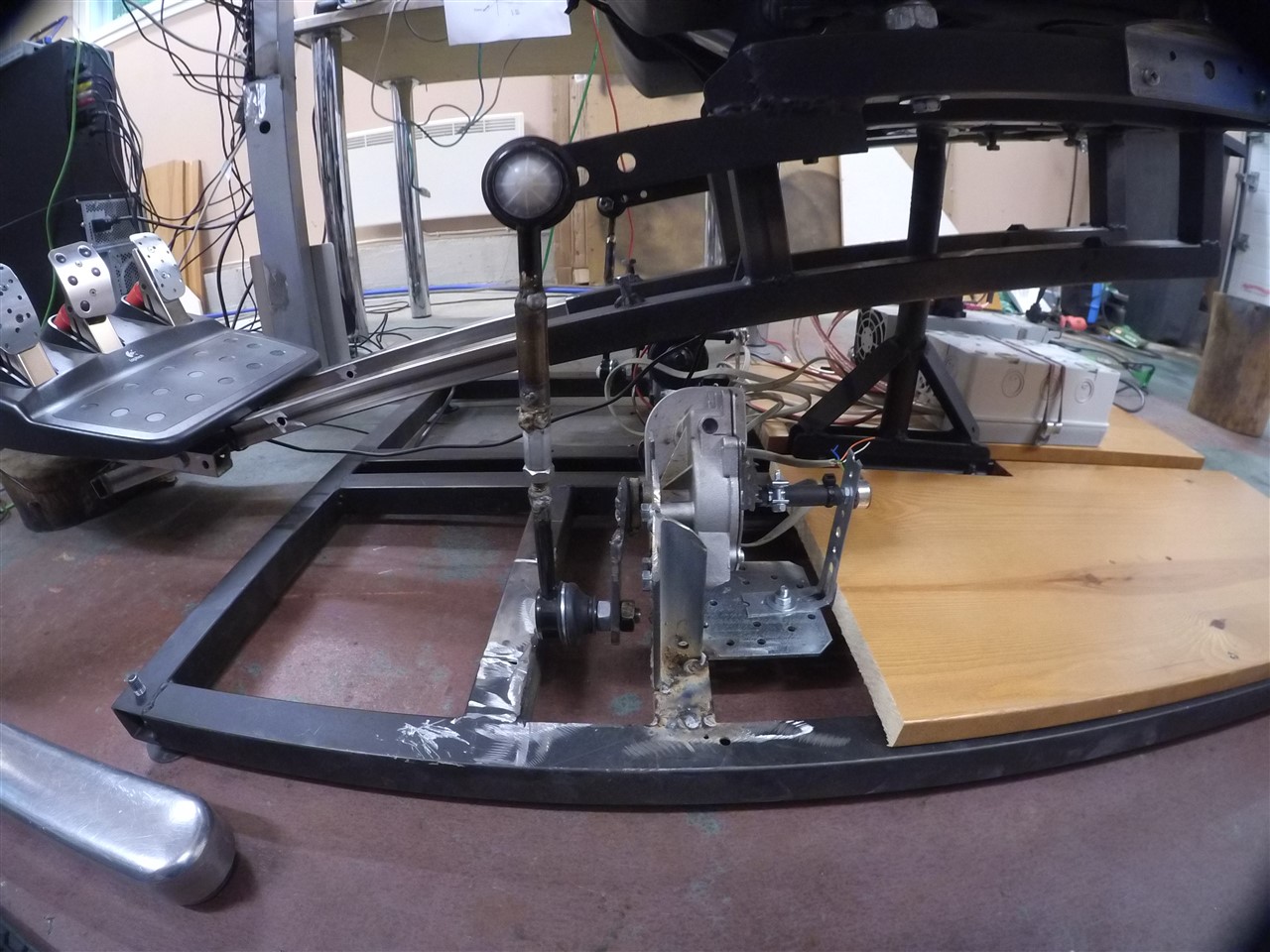

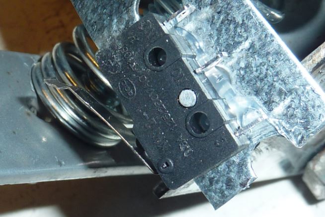

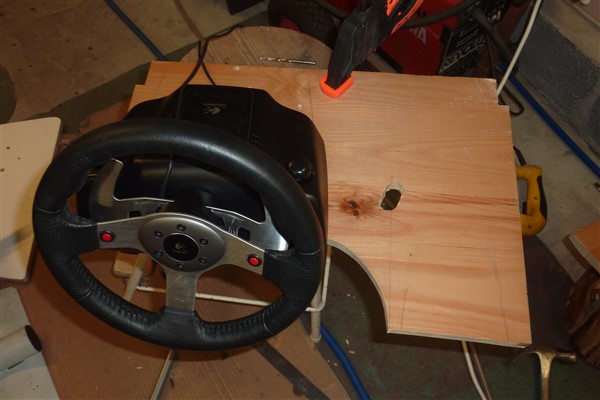

    Oh, i totally forgot that i made handbrake, because can't rally without it...
    New mounting plate for wheel and shifter, hole for handbrake:
    under table...
    microswitch with flexible mount...

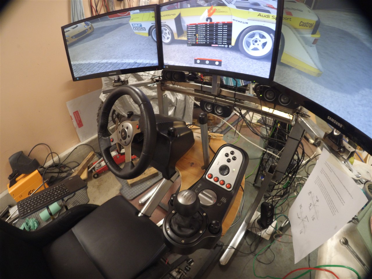

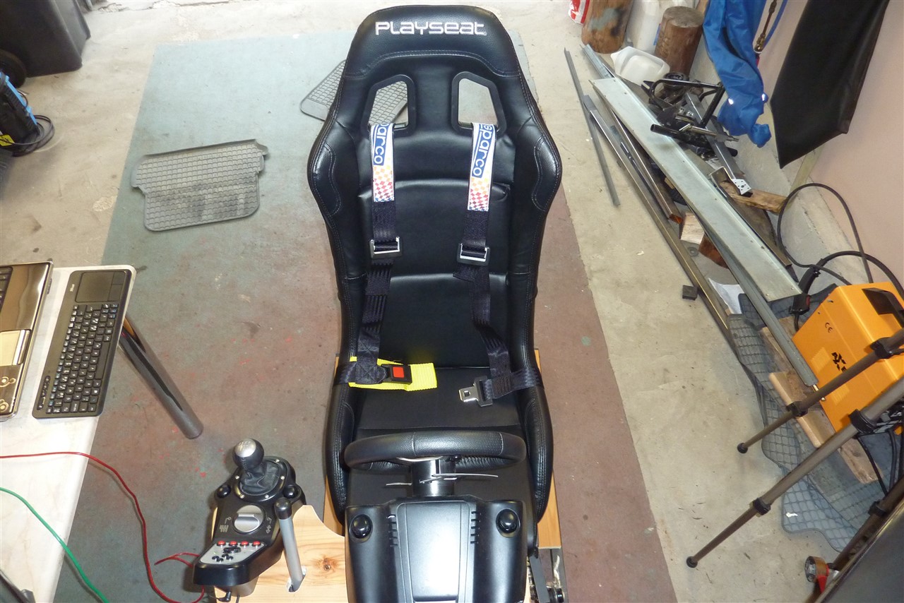

    I've been busy driving, so not a lot of updates lately.... But i finally got harnesses installed. It sure helps to get much more motion-feeling, though my setup is quite lively even without. I had to add clip limit, because inertia took motors over to cut-point... just a small adjustment.
    It is so hard to decide weather to keep whole frame in motion or just transfer it into seat mover...
    This thing is too big with monitors to go 'inside' the house. Basic problem of construction is that monitors has to be too high (me being tall and seat being high enough that pedals can tilt forward), so no ordinary table suits under.
    I think that because i basicly only want to do Rallying, it needs to have 'g-force motions' and i'm afraid that seat mover don't have it enough. It is true that these harsh movements makes driving only more difficult, without helping to feel the grip to road, but i think that is the point.
    We'll see...
