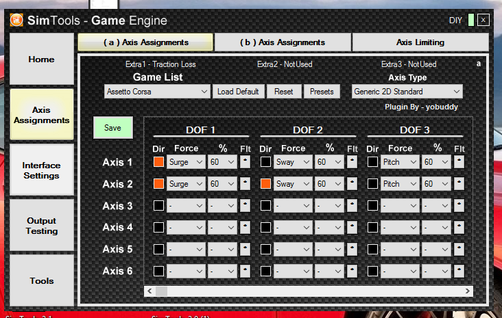

    OK - is it possible to not invert any force? I tested all forces, and all go in the same direction - or there is something beyond my comprehension.

    now jump I n iracing for instance and test . it should all be in accordance with your findings

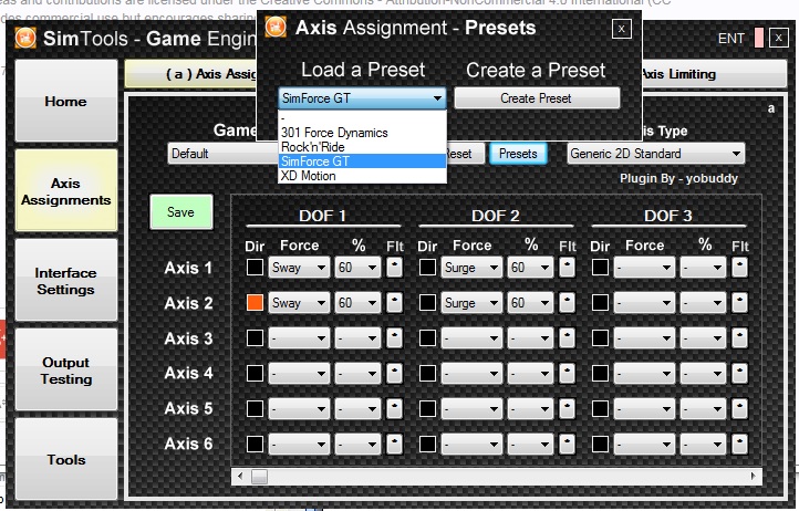

    @TPS,
    I'm guessing you have a 2 dof simulator?
    If so, there is a preset that may help you get started with your axis assignment settings.
    The directions may need flipped, but it will get you started.
    All ProSimU needs to do is post/send you an Axis Assignment profile for that sim.
    And setup would be dead simple for their users.

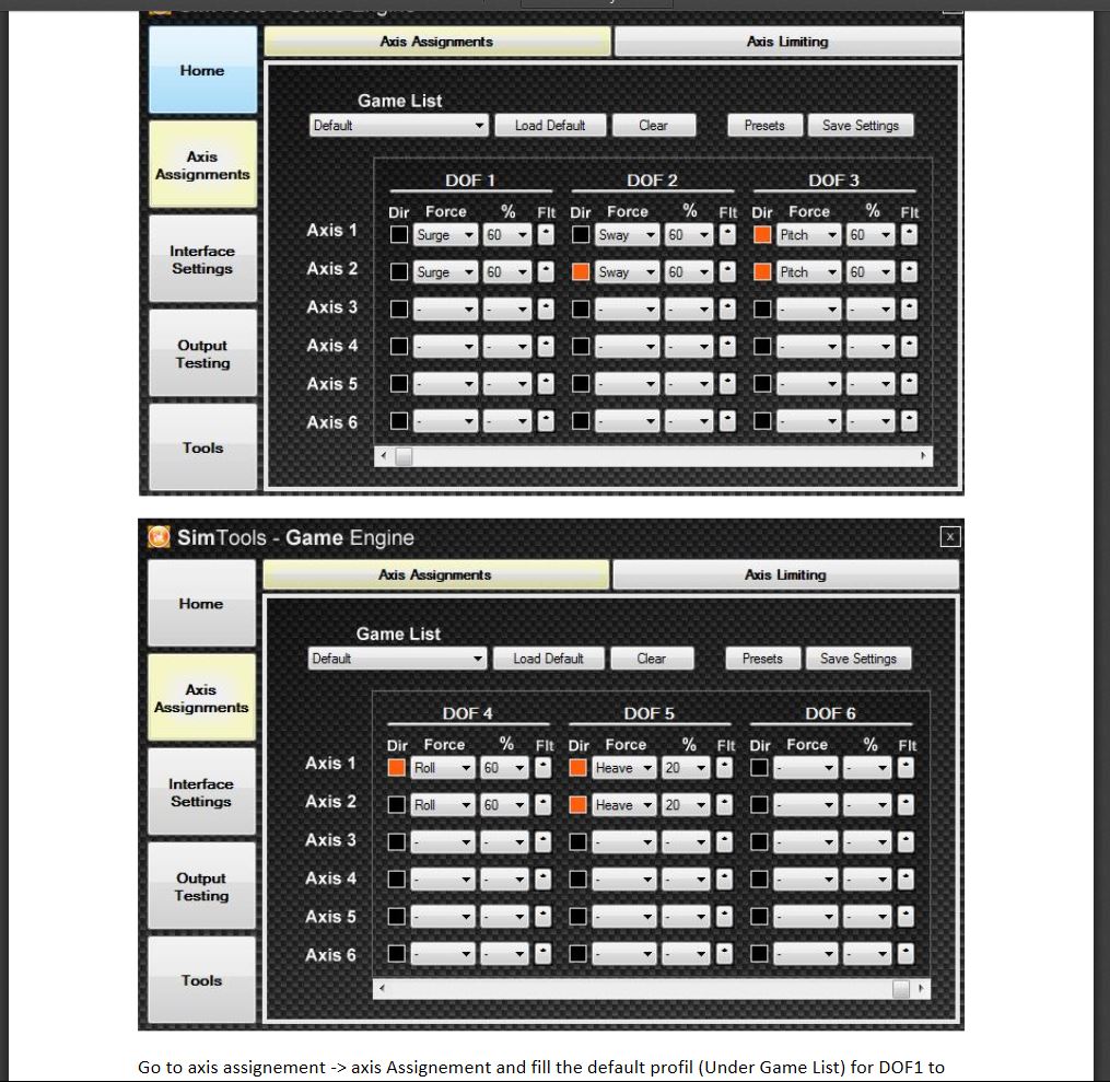

    Here is the Prosimu preset BUT ONLY for front actuators in 2DOF
    I must admit that DIY and turn key product are two different elements. I cooled down, and now I think my main concern and homework is to understand the axis and forces in rear actuator 2DOF simulator.

    I fully understand your point. My gripe was about something else. I received the help from Prosimu. It occurred that what is in manual by Prosimu concerns front actuators. I got rear. Nevertheless my biggest issue was how to change ID of com5 after I added another converter and make ST work with my scn5s. From this moment commercial rig by prosimu with one converter became DIY project with two.

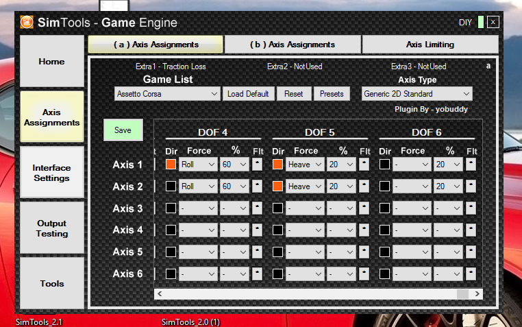

    OK - as a summary of my struggle with ST here I present the setting of ST concerning axis.

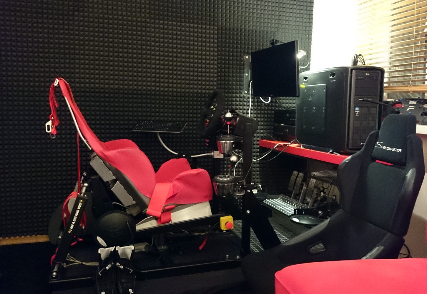

    I have 2DOF based on SCN5 100 mm at the rear of my seat mover, looking like this (no more GS4 seat)
    As far as the game manager I prefer all values higher ,but this is just minor tweaking.
    The 2DOF works very smooth, as I have never experienced such a motion before. Nothing is jerky. The car is felt the way it should IMO when compared to Lince with one USB/converter.
    I will explore more, but for now the main problem is solved.
