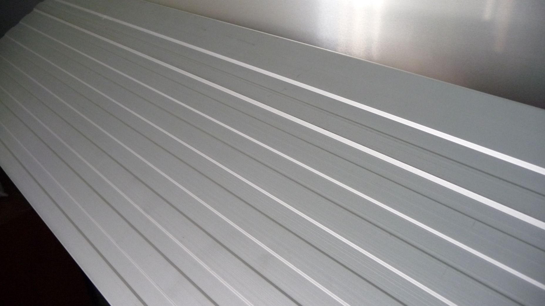

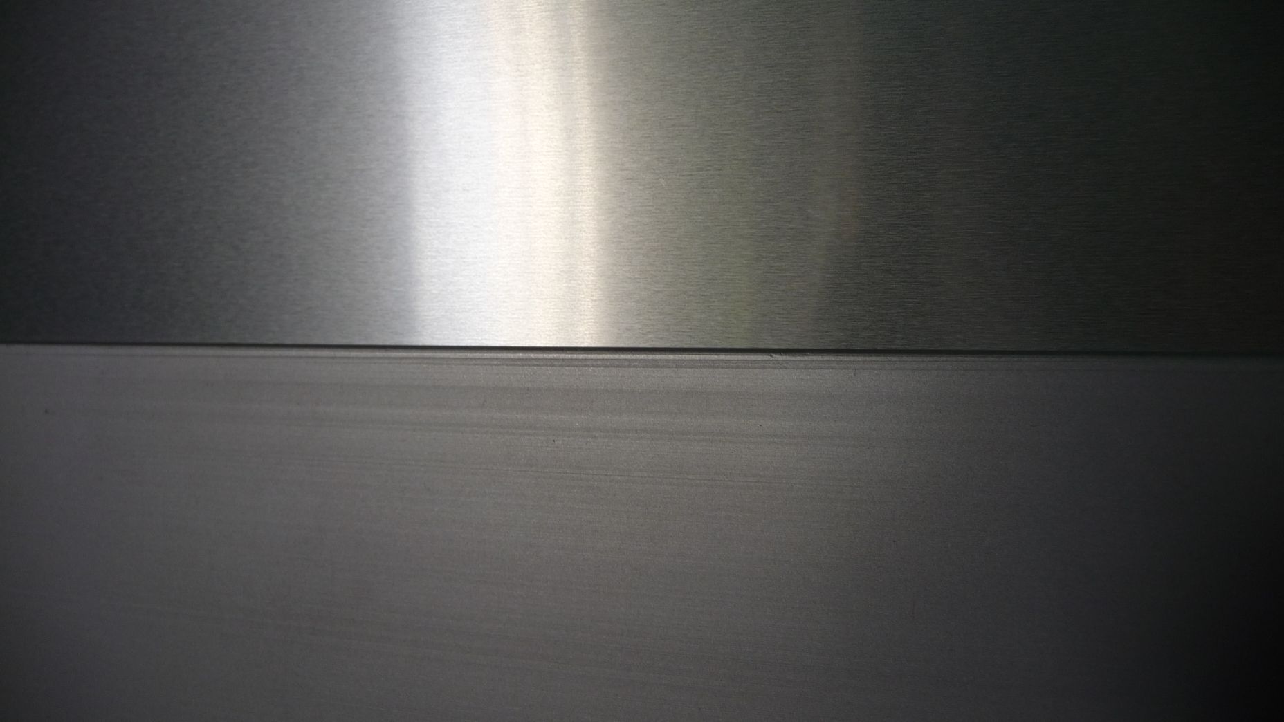

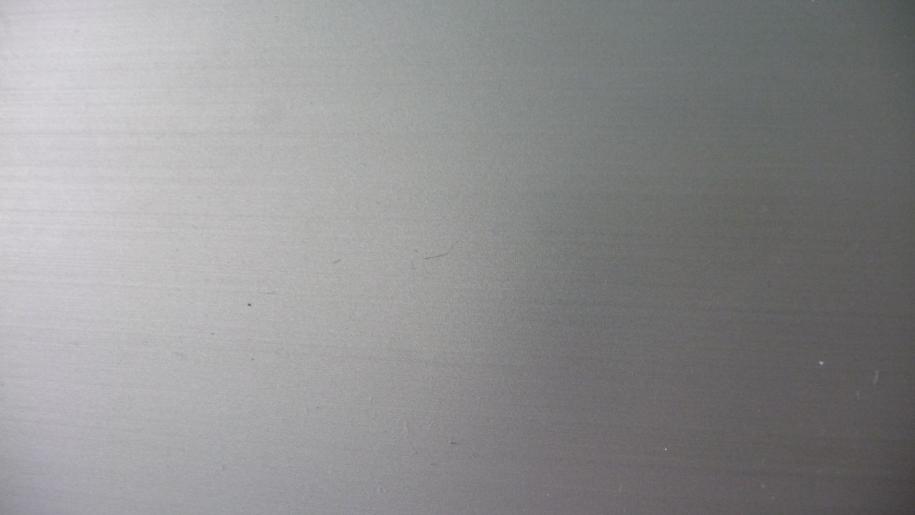

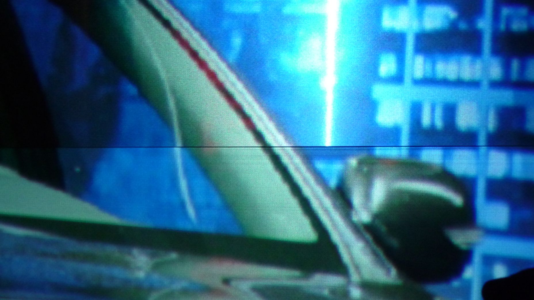

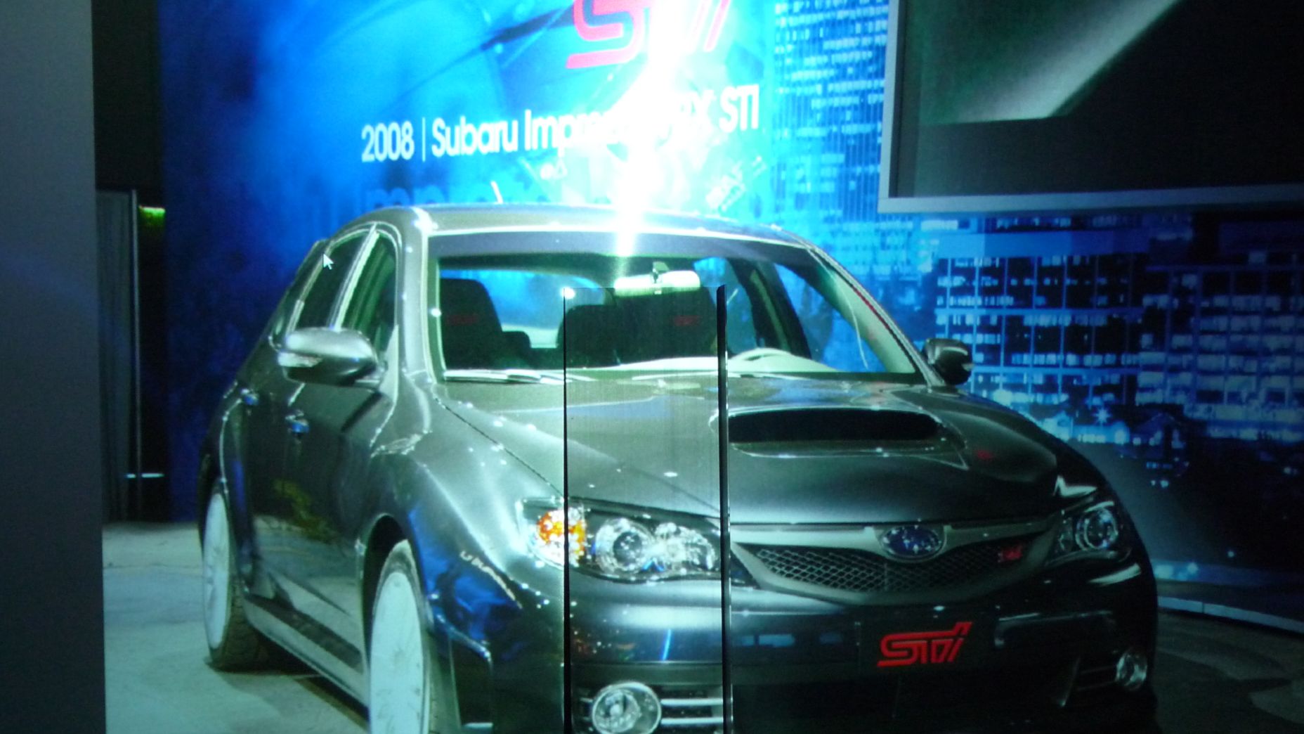

    Found different type of aluminum sheet. This one is ANODIZED ALUMINUM. Thing is that this one is completely dull - doesn`t reflect any light! Surface is clear (smooth) enough to get high quality picture and very tough (hard to accidentally scratch).
    I don`t see any picture differences between that what i was using lately. Even better - now i don`t have to struggle with shape of the screen to get proper brightness without any disturbing me reflections. Screen can be finally flat which means no problems with sharpness. That was small issue to the last (curved) screen. When it is shaped this way - side parts are with the different sharpness of picture than center of the screen. That also makes problems when comes to set properly 3D effect.
    This might be big step. Only thing to find out is how much it will cost to get size about 2500x1500.
    I`ll let you know.

    Good job! Do you loose any 3D picture quality with the anodized aluminum? The extra plating on the sheet could affect the polarization of the light, which could affect the picture as well. It is great if there are no negative effects!

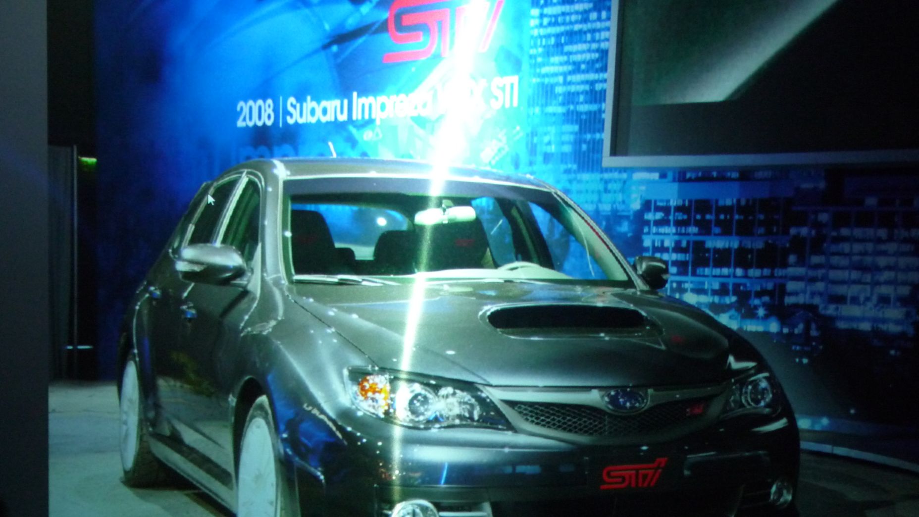

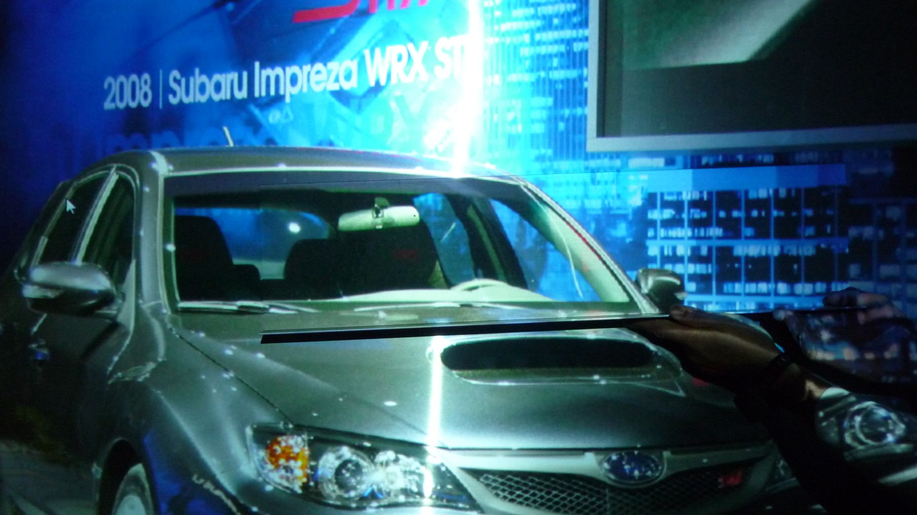

    I`ve put this small board in the middle of screen and played for one hour. Forgot it was there. It means - sharpness, colors, brightness basically quality is the same. I can say - even better because of lack of bright light disturbing you. That makes whole picture equally bright and visible.

    Don`t be mislead by look of the surface - you don`t see this when it comes to 3D. It is kind of strange how it works - suddenly whole picture is getting bright, so clear nothing compare to that what i had on white wall in 2D. I wish to be able watch movies like that.
