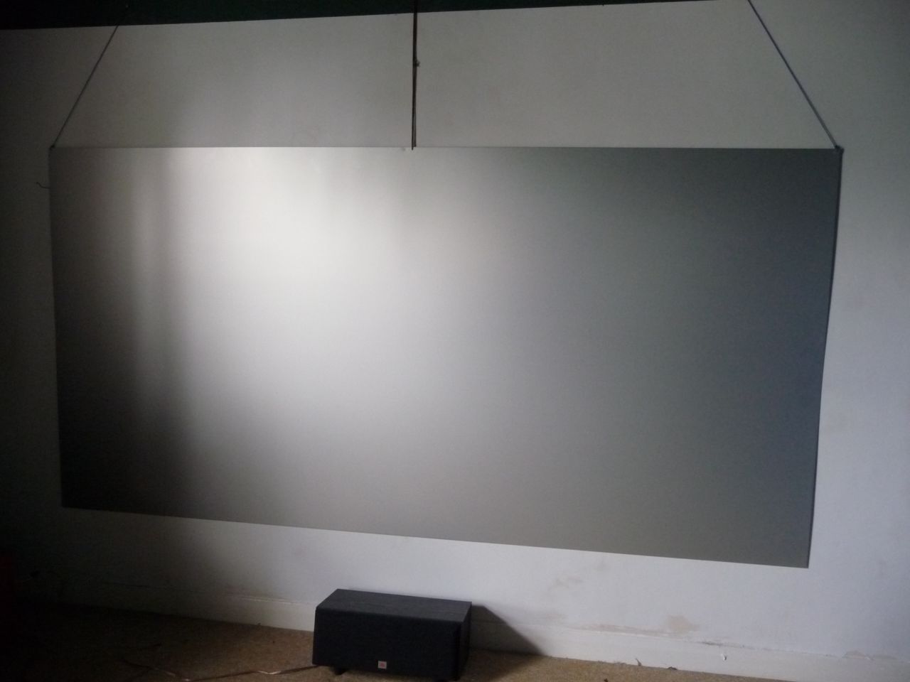

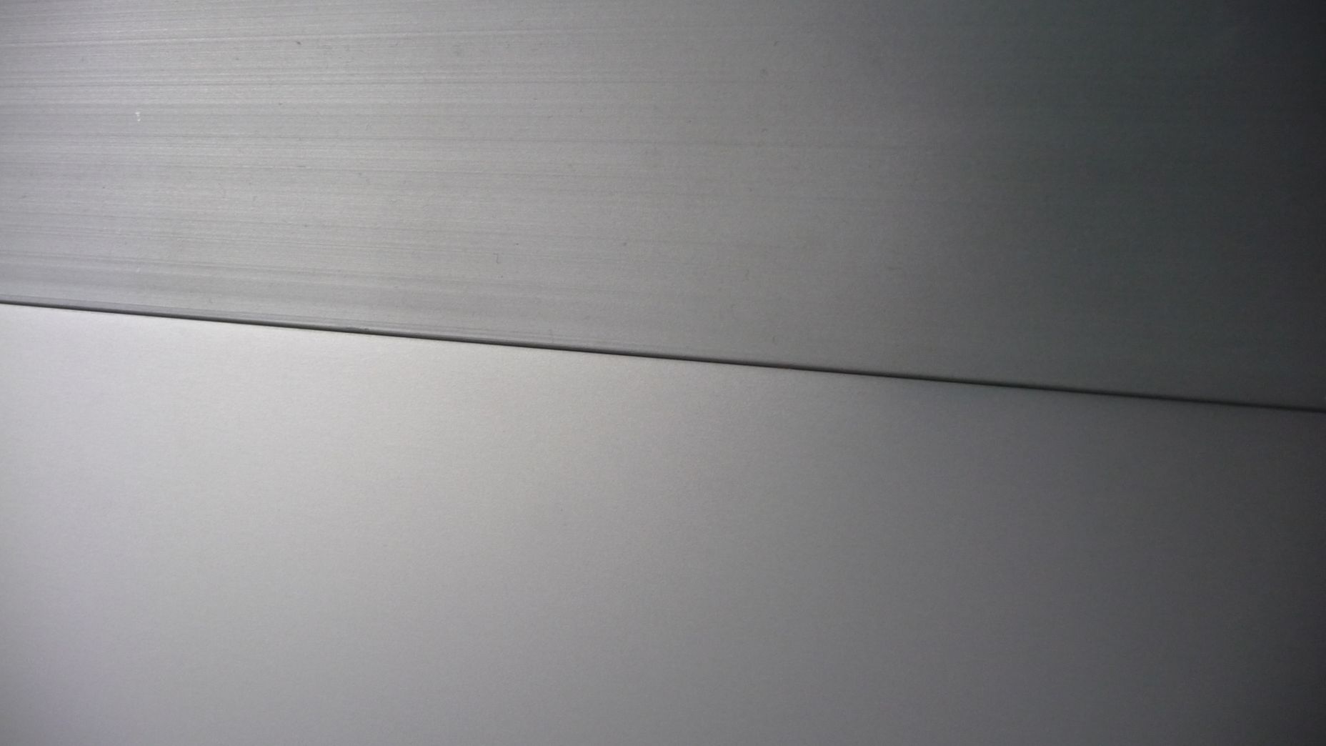

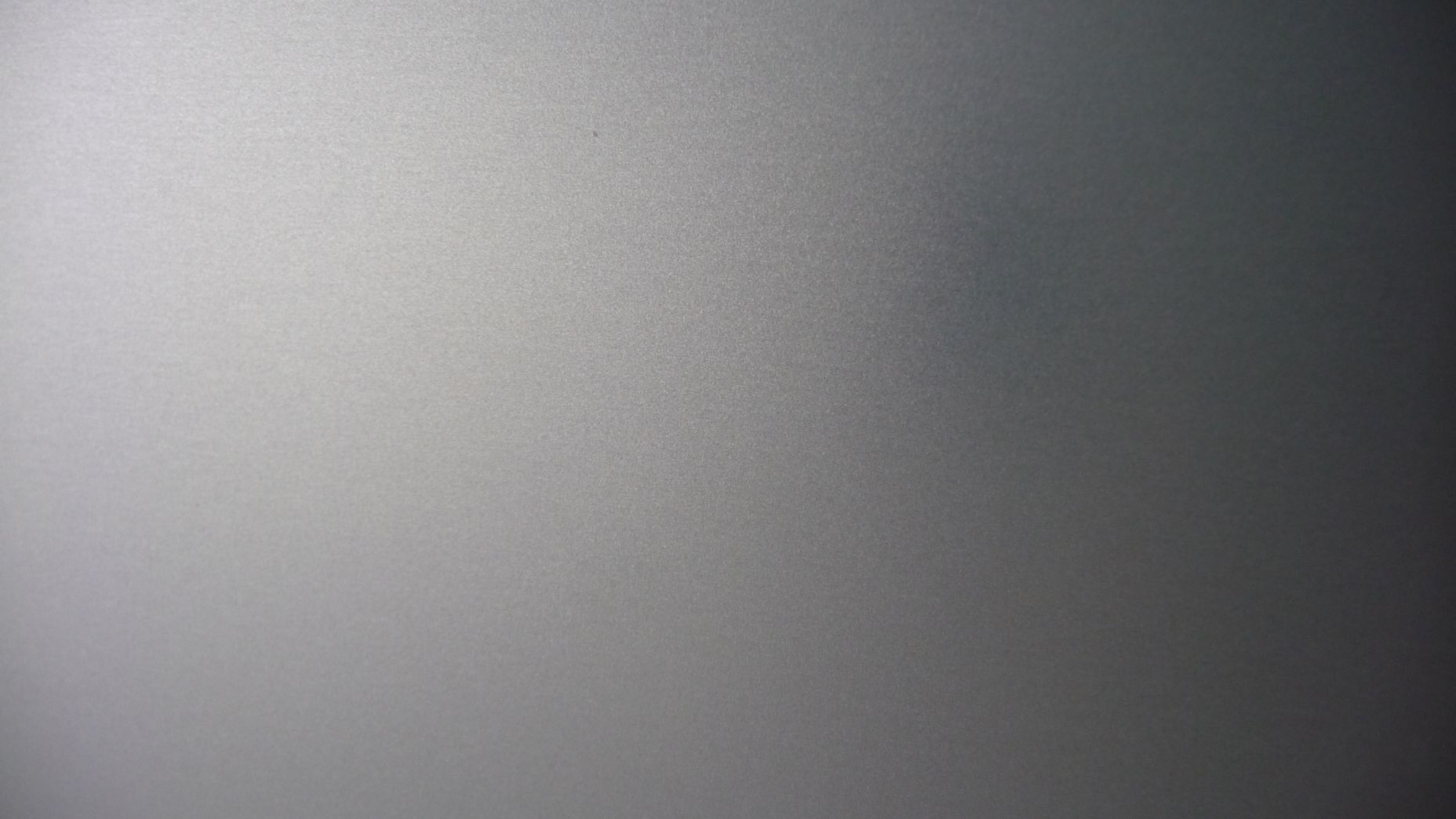

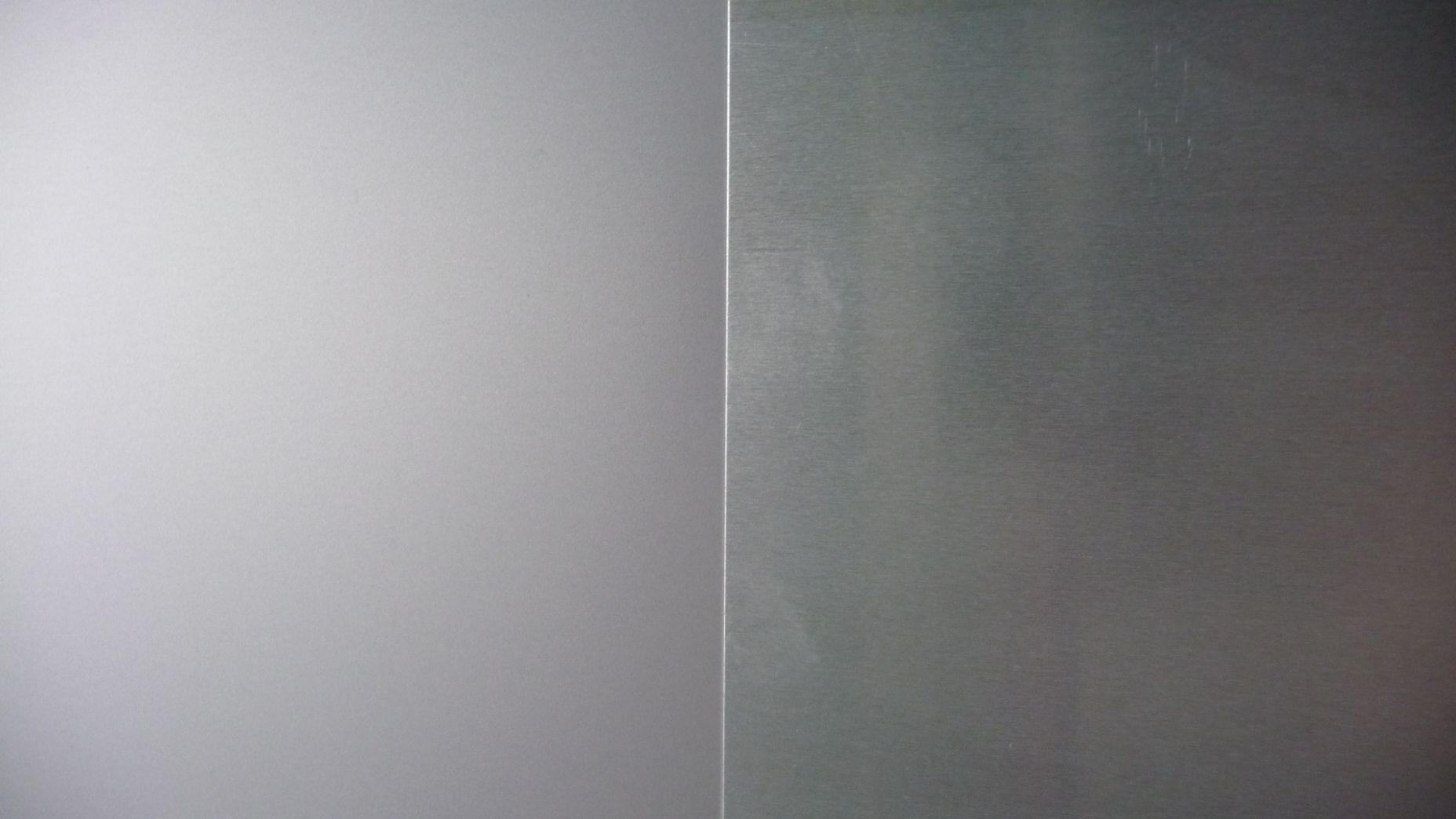

    I`ve purchase anodized aluminum screen. I managed to find one with smooth surface without any straps, scratches - just clear with ideally smooth structure. Like this other anodized piece this one is completely non reflective which work the best with strong light from projector. Finally i can keep flat screen and get properly set 3D effect (now it is very easy to put each picture in the same place).
    Effect is amazing. Everything what i had before can`t be compare to this one. Smooth without even small dots or straps (like usually metal have) and dull, non-reflective surface. Picture looks just perfect. Whole view is equally bright - without dark sides (like it use to be). Sharpness is even better than on white wall - now it feels like big LCD screen (because of kind of glassy effect).
    Sheet is very tough. Surface is very hard to damaged and it is stain resist. Size which i bought gave me about 100 inch size of the screen. It is still great - now i just sit closer.
    Sheet size 2500x1250 (1.5 mm thick) cost me: 88 £ / 105 Euro / 138 $. That is cheap compare to other polarized screens with this size (more than 300 £ saved).
    Because they had this size in stock (already anodized) i paid theirs price. If i would like to go for bigger one i will have to pay for anodizing process which will cost about 100 £ extra (depends on size).

    That looks really good! I would love to see a side-by-side comparison of your aluminum screen and a commercial 3D screen. I bet there is not a big difference in picture!

    It is hard to see any difference between picture projected on snow white, smooth wall and this anodized alu. I`ve been watching 3D movie recently and i have seen the same details as previously on the wall. Still Full HD picture is sharp with all details like arm hairs or wrinkles on face. Even better because of 3D effect.

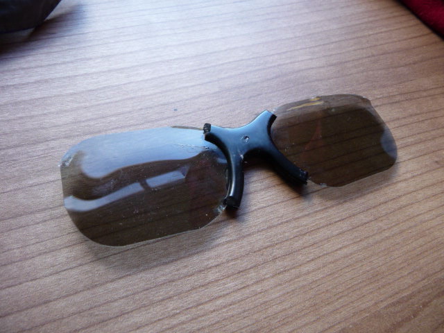

    I remember when Fahim said about glasses - that he can see frames and that disturbe him a bit. I have changed that and i have to say that it makes me feel a little bit more comfortable.
    I have just cut out whole frame arround filters and left middle part which holds them together and on my nose.
