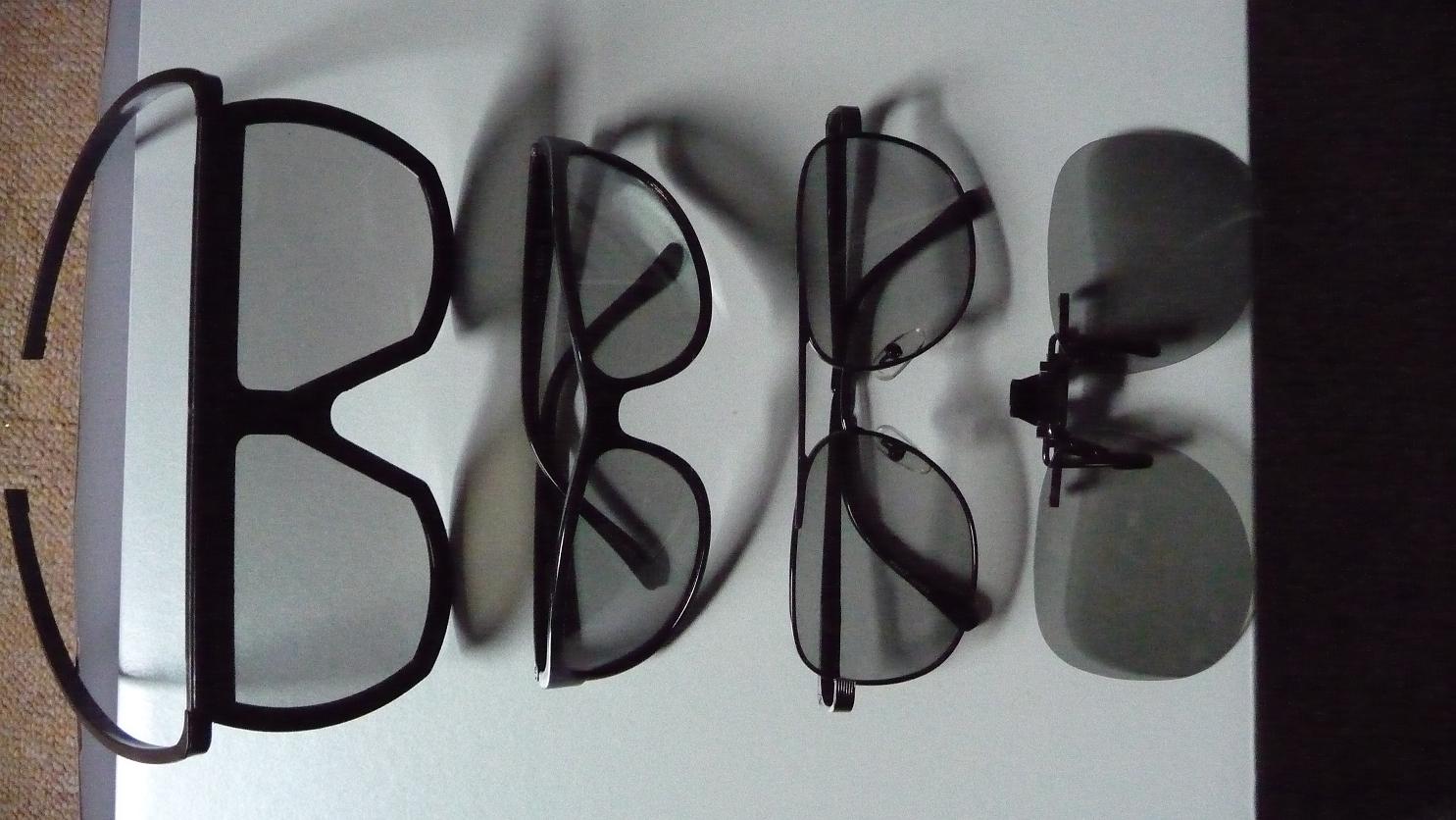

    GLASSES
    These are all glasses i`ve purchased from berezin.com. I wont be very revealing if i say that quality matters a lot.
    All them are Linear 45 degree and all made from plasctic (filter) so they suppose to work exactly the same. Only difference is in case of qualit of the plastic/foil which was used to make the filter. All them are comfortable because they are light and well shaped. Sometimes frames might be visible (didn`t annoy me at all) so frameless ones might be better chioce for some of you. Basically difference in experience is about how dull picture will become and how many distructions will you experienced.
    1. Jumbo Theme Park.
    As first one i`ll pick the worst. These are the only foil ones. Lens is so crappy that everytime when you move you can see all reflections on theirs bumpy surface. Also they are really hard to clean and very easy to damage.
    From other side it is good choice for a movie sessions. Friends wont be stress by you to keep them safe. About 4.50 $ if you buy more then 10psc.
    2. Terminator type.

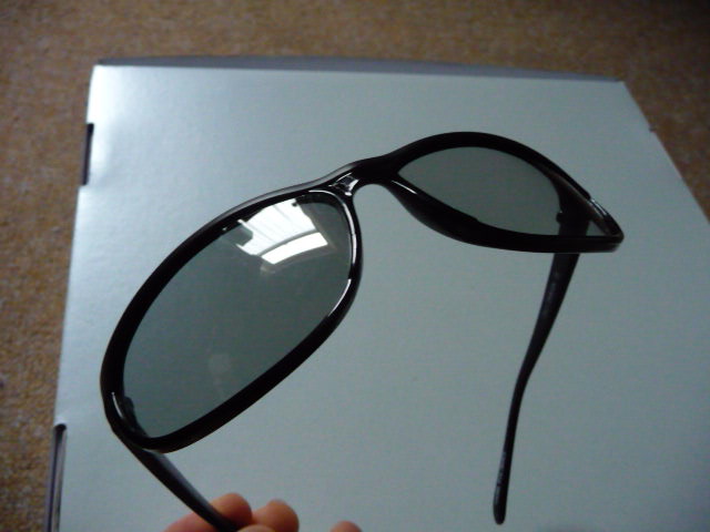

    These are well made and good looking ones (like you need that 8) ). Since shape is nice you have to expect some restrictions. Lens is to small and this means that frame will be seen like hell. More is that they are quite thick so those who don`t like that will definitely complain. Also lens is darker then on the others so be prepered to see bit more darker picture (still a lot better then 3D Vision experience).
    3. Aviator.

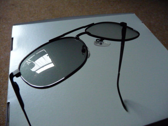

    I am using them all the time. Frames are made form thin metal so they are hardly seen and very strong. Lens is thick and very bright (almost like glass) and also easy to clean. Quality is comperable to those on the projector. Superior visibility and quality experience !

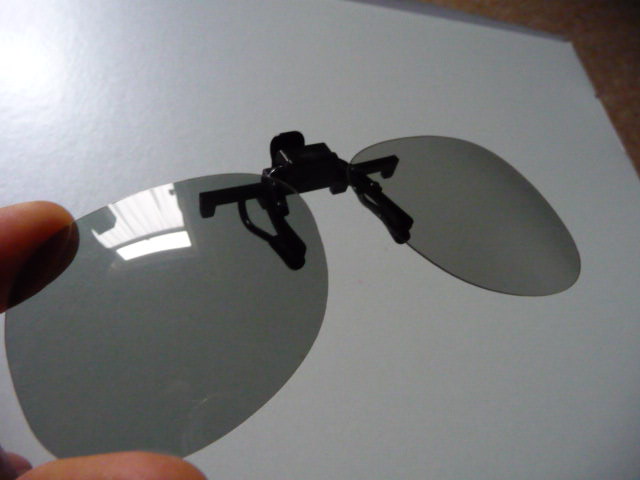

    4. Clip-ons.
    This are basically the same as the aviator just without frames. Great quality in case of lens - no reflections, clear and bright picture. For some of you there might be a problem with this mounting system. Since i still dont know how it was ment to work with my nose - i manage other way. Thin rubber arroun head and glasses attached to it by clip. Also this clip is quite visible when works in normal way so it is better when i flip it up to grab this rubber.
    Basically great glasses and definitely best solution for those who feel restricted by glasses itself in case of Steroscopic 3D.
