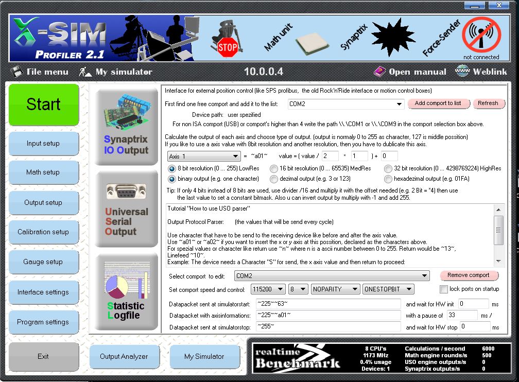

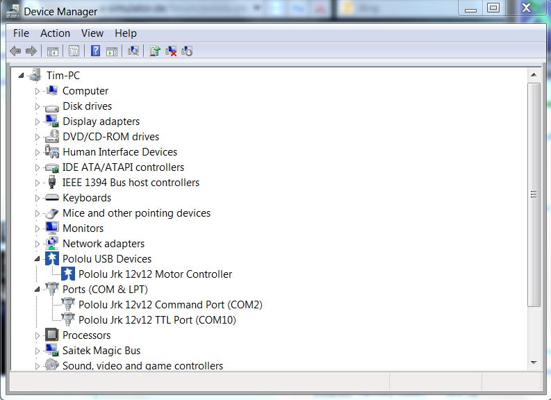

    Hello. I too have switched to using the Pololu jrk 12v12 controller. Don't get me wrong, I am definitely not taking anything away from Thanos as he has done a remarkable job. It's more the fact that I suck at troubleshooting electronics and mathematical formulas. After reading the posts made by Frakk, I was convinced that perhaps it might be easier for me to go to something a little more Dummie friendly. I am trying to use this for FS2004, FSX and IL2
    Anyhow, here is what I have
    two 12V wiper motors from here http://monsterguts.com/index.php?act=vi ... roductId=4
    One 14VDC Power Supply
    Two Pololu jrk 12v12 motor controllers
    Two 100K Pots from here http://www.alliedelec.com/search/produc ... KU=7542054
    X-Sim 2.1.0.3
    Pololu's configuration utility for the JRK 12v12
    I connected everything with the help of Frakk and Eaorobbie's post found here pololu-jrk-12v12-t2697-10.html
    I noticed that when I use the configuration utility the motors function properly using the pots. However in the Profiler it seems that my pot calibration gets out of wack and centering the pots does not stop the motors. When I fire up FSX the motor will turn very slowly in the pitch down and does nothing in the pitch up. I’m not sure what settings to adjust to correct the problem. I’m very pleased to have gotten this far. I hope I have provided enough information. Thanks for any help that can stir me in the right direction.
    Below are screen shots of my setup
  15. eaorobbie
    20,491Coins
    +1,687 / 23 / -2
    well mate i havent tried the cards in a flight sim setup but have found in the uso's with the v2 ya have to replace ~~225~ with ~~221~. And in ya maths plugin ya need to use + and - in the pitch if ya only use + the motor only turns one way.
    Plus i see ya only connected one jrk12v12 to test.
    Mate have messenger and teamviewer if needed.
    P.s one test is to move the slider in maths pluggin to test movement plus this can be done in xp with the pololu config. running with graph output to see what data xsim is sending. plus what are the setting u using in this. Plus also noted in pololu forums the config programme can sometimes conflict with other programs trying to use the card i havent found this an issue under XP.
