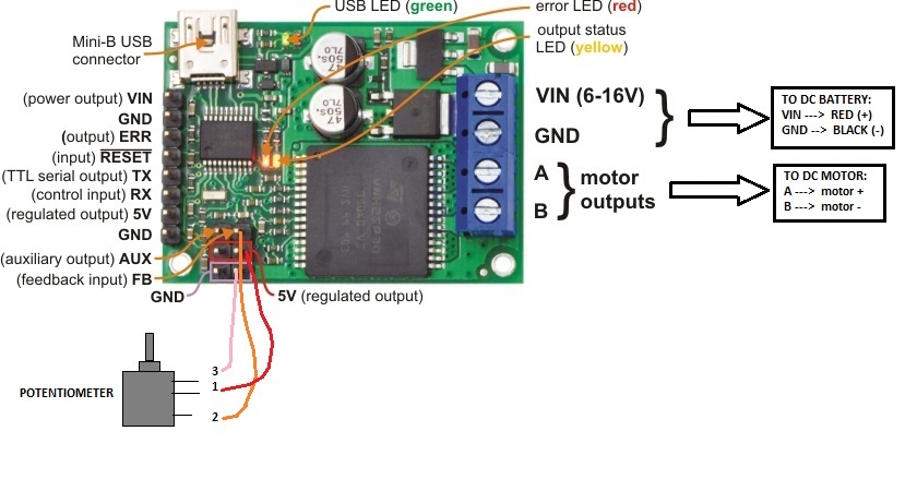

    A little question about the connection between Jrk, motor, pot and battery :
    Look at the pic I had posted, the wiring is correct?

    Aldoz ya wiring alittle out most pots wire to 1 - ground, 2 - signal(feedback) and 3 is 5v.
    Buk jrk12v12 draws its 5volts from usb connection so the 5v for the card is not needed unless you are using another card to communicate to it which defys what the card was designed for a usb motor controller with feedback control. ?

    Hi aeorobbie, mmm I don't sure I understand you at 100%.
    Please tell me if I understand:
    1) I have to connect my pot with jrk in this way:
    POT pin 1 -------> jrk GND
    POT pin 2 -------> jrk feedback input FB
    POT pin 3 -------> jrk 5V
    2) the wire to the jrk 5V is no needed. cause JRK draw already these 5V from the USB connection.
    Please tell me If i am wrong.

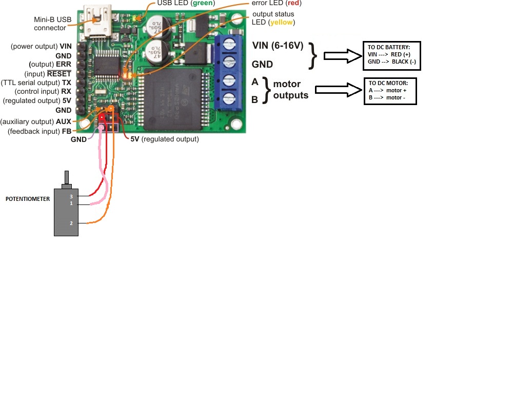

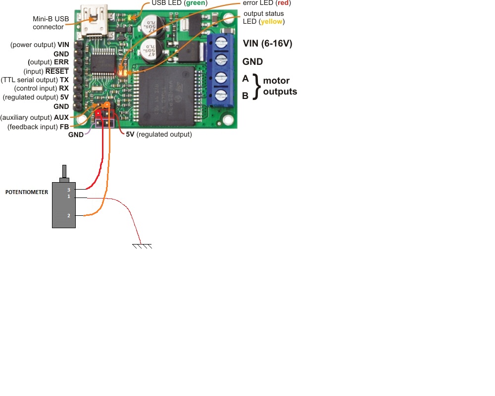

    Thank you mate! Please take a look on the image attached and confirm me if the wiring is correct!
    The Pot terminal 3 can be NOT wired as I use the Jrk connected to my PC via USB, right?
    Sorry If I repeat myself but my damned english it's a really bad and ugly creature :(
    And thank you!
  13. eaorobbie
    20,491Coins
    +1,687 / 23 / -2
    no connect pin 1 from pot to gnd pin on jrk. Then we got it 8)

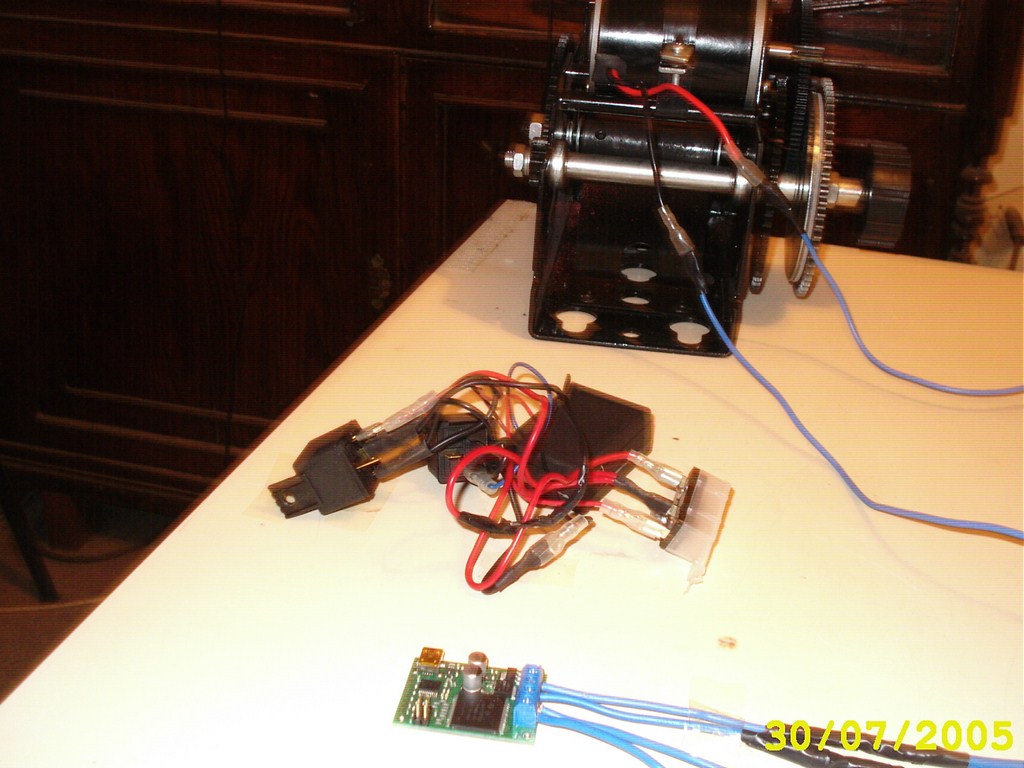

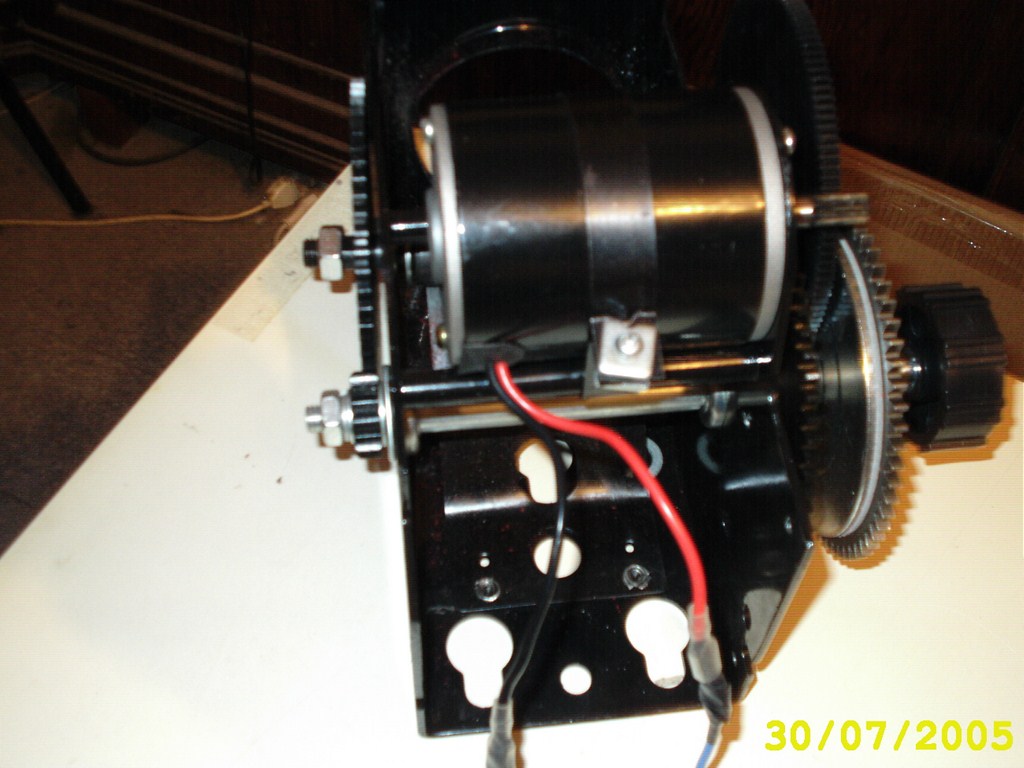

  17. AldoZ
    AldoZ Member
    Aug 26, 2010
    286
    Pc Shop
    366Coins
    +6 / 1 / -0
    Hi eaorobbie!. In these days I made many forward steps, I follow your and the other dudes directives and now I can move my motor using X-SIM!.
    But now the situation get serious..! :)
    So:
    Yes I would that!
    1000 = highest movement point
    -1000 = lowest point
    we will speak later about the speed and accelleration variables.

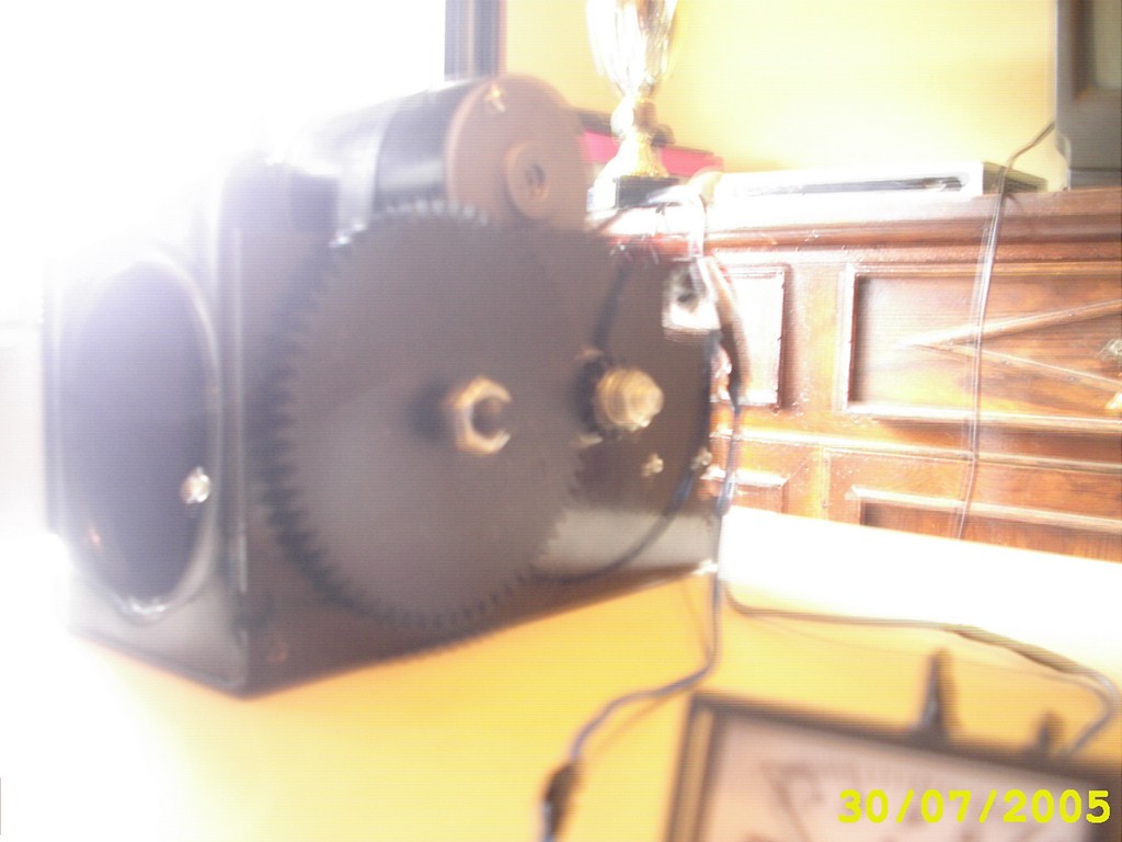

    So I need my pot connected to the arm motor if I want to obtain the correct start and end point of the motor arm movement (and the intermediate movement positions too)
    Ok eaorobbie, for now I haven't my Pot connected to my arm motor. I am waiting my RC heli gear (I think it will arrive me on monday).
    however I show to you my photos about actual situation so you can make an idea (really sorry for the bad photo quality).
  18. eaorobbie
    20,491Coins
    +1,687 / 23 / -2
    All looks good mate.
    Just one test ya can perform without the gearing,
    is to wire the pot to the jrk12v12, as described before. This will allow you to set the feedback values on the pololu software which will enable you to test motor direction and speed. For example once the pot is wired set the maxium forward to the pot turned all the way to left and maxium backward to the pot turned all the way right. Once saved to card, start the motor and because ya pot is still turned all the way right your motor should spin fast to the left.(make sure in the first folder in pololu config is set to serial and the postion is set to middle and automatic.)Then by turning the pot slowly to the left the motor should slow down and eventually stop, this is the middle or the level position, then keep turning left and the motor should slowly increase in speed turning right (the other dircection) once the pot is at its limit to the left it should be spinning at about the same speed as it started but in the opposite direction.
    Secondly i found when opening the motor i found a restistor on each terminal earthing them both to the body of the motor, they need to be removed from the motor or the outside of the motor is live and when placed in a sim chair the whole chair is live resulting in destruction of anything earthing to your frame, i discovered this by blowing up my g25 wheel, ouch that hurt the pennys, sorry should have told ya eariler. This can be tested with a multimeter. Plus i removed the relay and inline fuse from the winch and connected the terminals of the motor directly to the jrk12v12 or the motor only goes one way.(ah ha)
    Again looking very promising and wow what a small world that winch almost looks identical to mine, half a world apart, wow. :thbup:

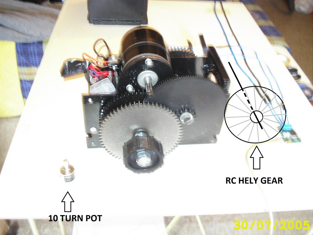

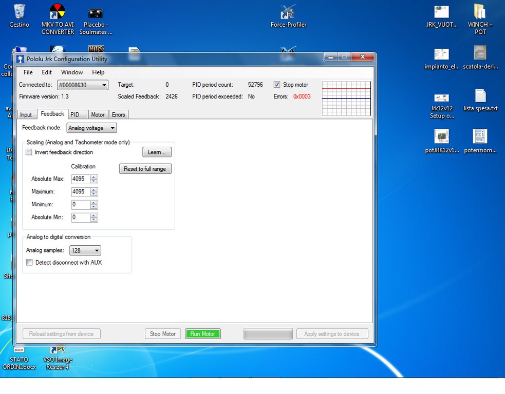

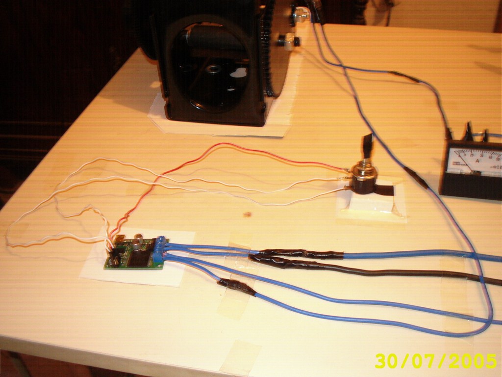

  19. AldoZ
    AldoZ Member
    Aug 26, 2010
    286
    Pc Shop
    366Coins
    +6 / 1 / -0
    :) Thank you so much mate, your help it's really apreciated!
    So:
    Yeah, I detach all the components you'r telling, (see the pic 1) PIC_1.JPG and now only the 2 main cables exit from my motor (see pic 2) PIC_2.JPG .
    Over, I have to remount some iron components to my winch because when I was removing the iron cable, so I disassembled these iron components and now I have to remount they correctly.. but this is an another story :)
    Sure I am sad for your G25 wheel, these are the things can be happen when we make these electrical/mechanical experiments!.. :? :)

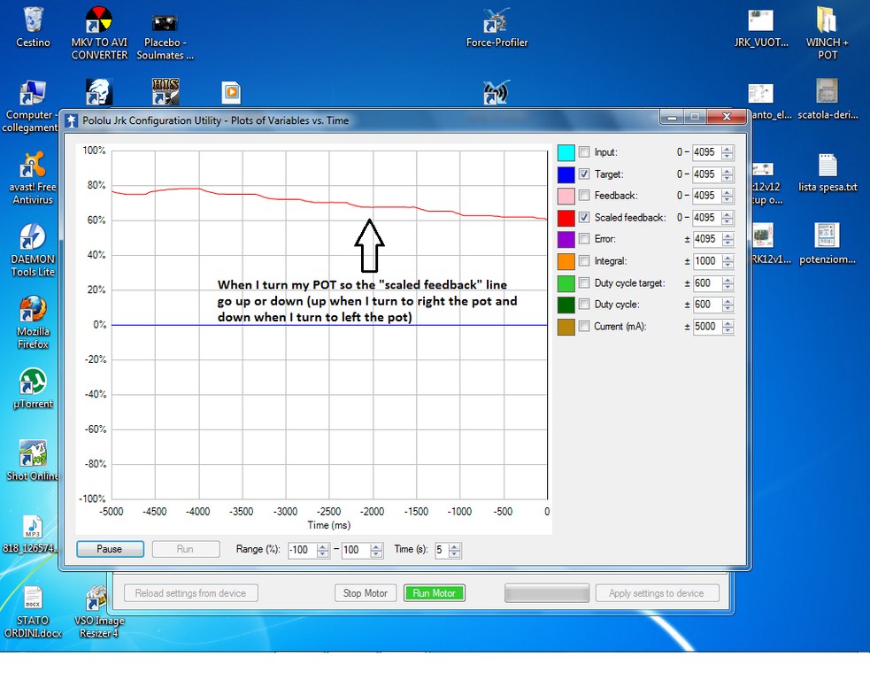

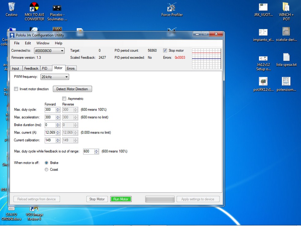

    Ok, now the interesting thing.
    I trying to follow your instructions but I loose somethings.
    These are my steps:
    (real life schema on PIC3B :) )
    2) I run the Jrk configuration utility, and I went to the INPUT page.

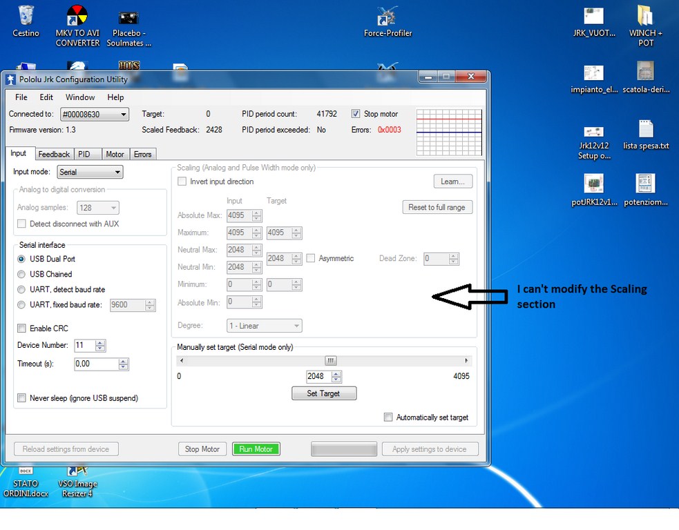

    You can notice that I can't to modify the scaling section of the input page. I don't know whether it is right way or not.
    However when I rotate my pot so I can see (in the plots of variables) the scaled feedback line that go up or down, depend the direction I am rotating my pot. So I know that my pot is wired correctly. See it on PIC 4B:
    But here the problem. I don't understand when you say that :
    When I set my pot all rotated left and when I set my pot all rotated right I need to save, ok, saved. And I repeat I can see the scaled feedback line moving, but how can I attach the scaled feedback line with the target line? (I supose the target line is the line of the movement of the arm (clockwise or anticlockwise)
    But when I start the motor I can move it (clockwise or anticlockwise) just with the manually set target bar (if the bar slider is in the middle position, my motor is stopped). And if I push the automatically set target button, the story don't change. I can move the motor only with this slider, not with my pot!
    Please take a look at my PIC 5 to see my JRK config utility feedback page
    and look at my PIC 6 to see my motor page
    Thank you mate! really. :thbup:

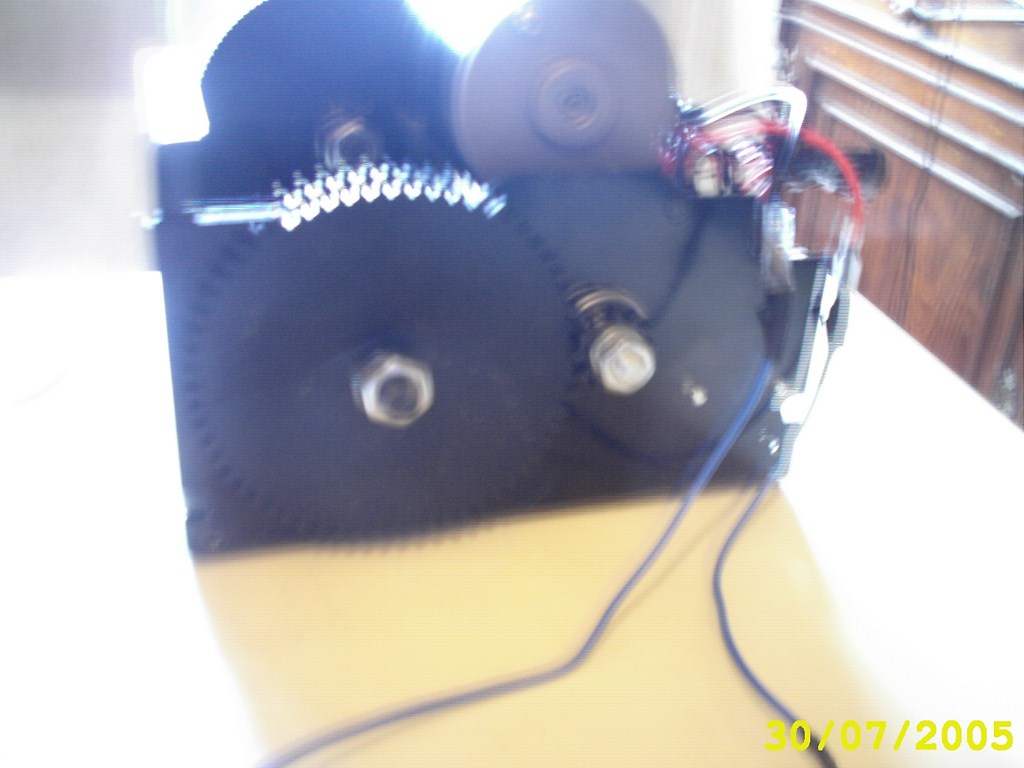

  20. AldoZ
    AldoZ Member
    Aug 26, 2010
    286
    Pc Shop
    366Coins
    +6 / 1 / -0
    Done mate! Now I can move my motor with my POT!
    I needed to set the PID page for that!
    About the discussion of your destroyed G25 wheel, please, teach me, I need to dismount other things for avoid your problem?
