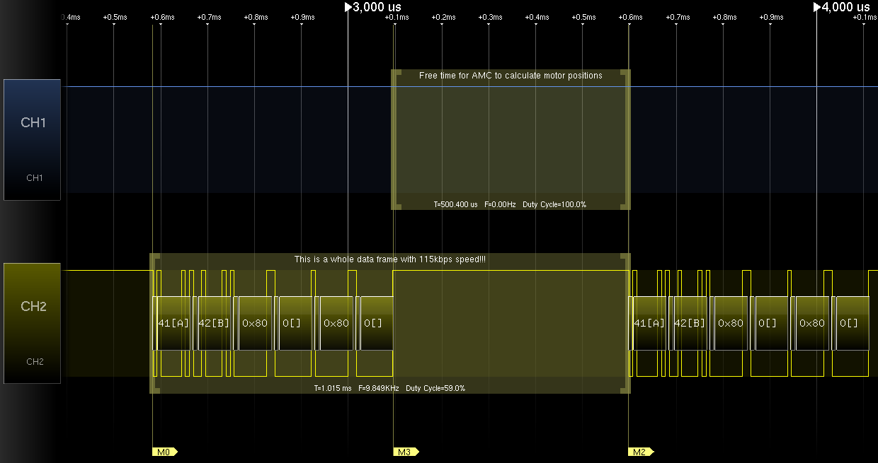

    My tests shows completely different story here... In this capture I show the timing of capturing a data frame of AB<16bit_value><16bit_value>
    As you can see there is plenty of time for AMC to receive data, calculate and position the motors within a 1millisecond (1ms) :mug1:
    Here is the capture file that you can analyze in depth with scanalogic software (free) here: http://www.ikalogic.com/ikalogic-products/scanalogic-2/downloads/
    amc uart data capture (scanalogic).zip

    115kbps obviously faster than 19200kbps.
    the screen shot was taken more than years ago. With AMD Athlon x2 running windows vista 32bit. Long before USB implementation on hardware side. I dont know if my picotech oscilloscope give me a wrong reading but here is my 16bit timing for same baudrate
    Sirnoname suggest me to built my own .dll for my hardware due to windows limitation. But i solve my problem when i use 115kbps to 256000kbps baudrate to comunicate with USB version of my hardware. I push my hardware to calculate PID as fast as 0.2 - 0.4ms. At about 3.00a.m Sunday morning i realize at this speed the controller can run faster than SCN5 if you want. the only limitation is wiper motor itself. I learn something very important that morning. You know what? 1-5ms of delay only can be feel by your body when you have super fast controller to sense that. that why i always use 1ms pause on my hardware. :yes:
    Jrk is good board on the market available today if you want some fun. for accuracy i have no comment.

    Well, its not only to be able to feel it but to minimize the motor overshooting too... Better refresh rate less chance of overshooting the motor aka smooth transitions in direction changes.
    BTW here is some math to confirm my capture:
    115200 / 8 = 14400 bytes per second ----- 14400 / 1000 = 14.4 bytes per millisecond ( I use only 6bytes per ms having space for more)
    19200 / 8 = 2400 bytes per second ----- 2400 / 1000 = 2.4 bytes per millisecond (For 6bytes you need at least 3ms !!! )
