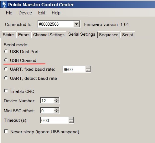

    IMPORTANT n°1 : First of all, please check that the pololu card is selected to USB chained (it works also with USB Dual port)
    Use the pololu configuration software to check this point.

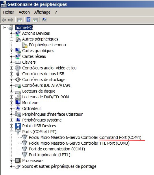

    IMPORTANT n°2 : In the panel configuration of windows, find the command port of the pololu card (normally, either COM3 or COM4). In my computer, it was COM4.
    The pololu works with the command port (and not the TLL). It is important, because during the configuration of X-sim, you will have to add a comport with the good COM number.

    Fill in COM4 (or COM3) in the field comport list, then click add button. For this point, please see again IMPORTANT n°2.
    IMPORTANT : you must fill in something in the field, because the USB card is not recognized by X-sim, you will not see the USB card in the drop-down menu.

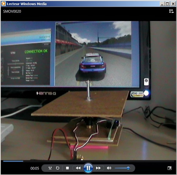

  10. adbgg
    adbgg Member
    Feb 2, 2010
    78
    132Coins
  11. thomasant
    thomasant New Member
    Nov 15, 2009
    9
    0Coins
    Hi Adbgg,
    I watched the video. It is excellent!! :clap:
    I am still having some delay with the FSX integration, because there is additional software involved with getting the data out of FSX to input into the microcontroller. But you have helped a lot. At least I know that I can use the Pololu Maestro to work with X sim. I will let you know when I succeed with FSX. Thanks again, great work!!
    Regards,
    Thomasant
