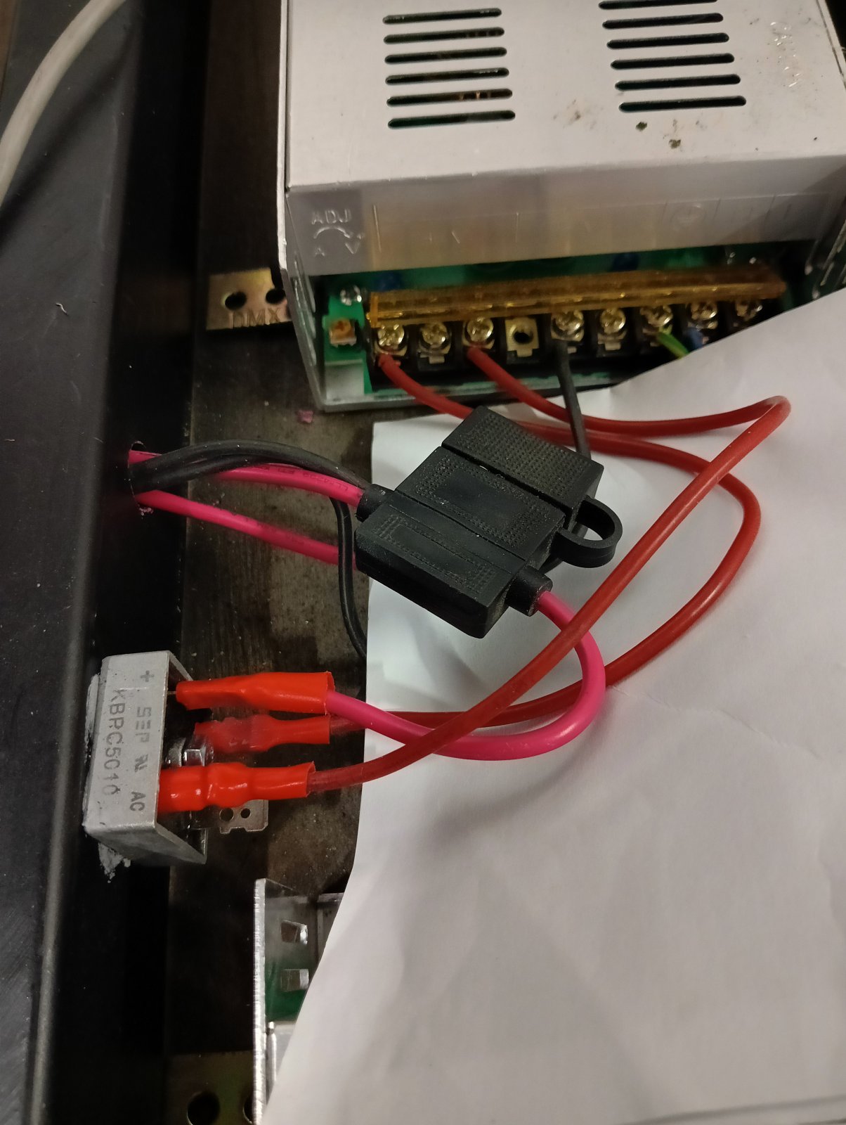

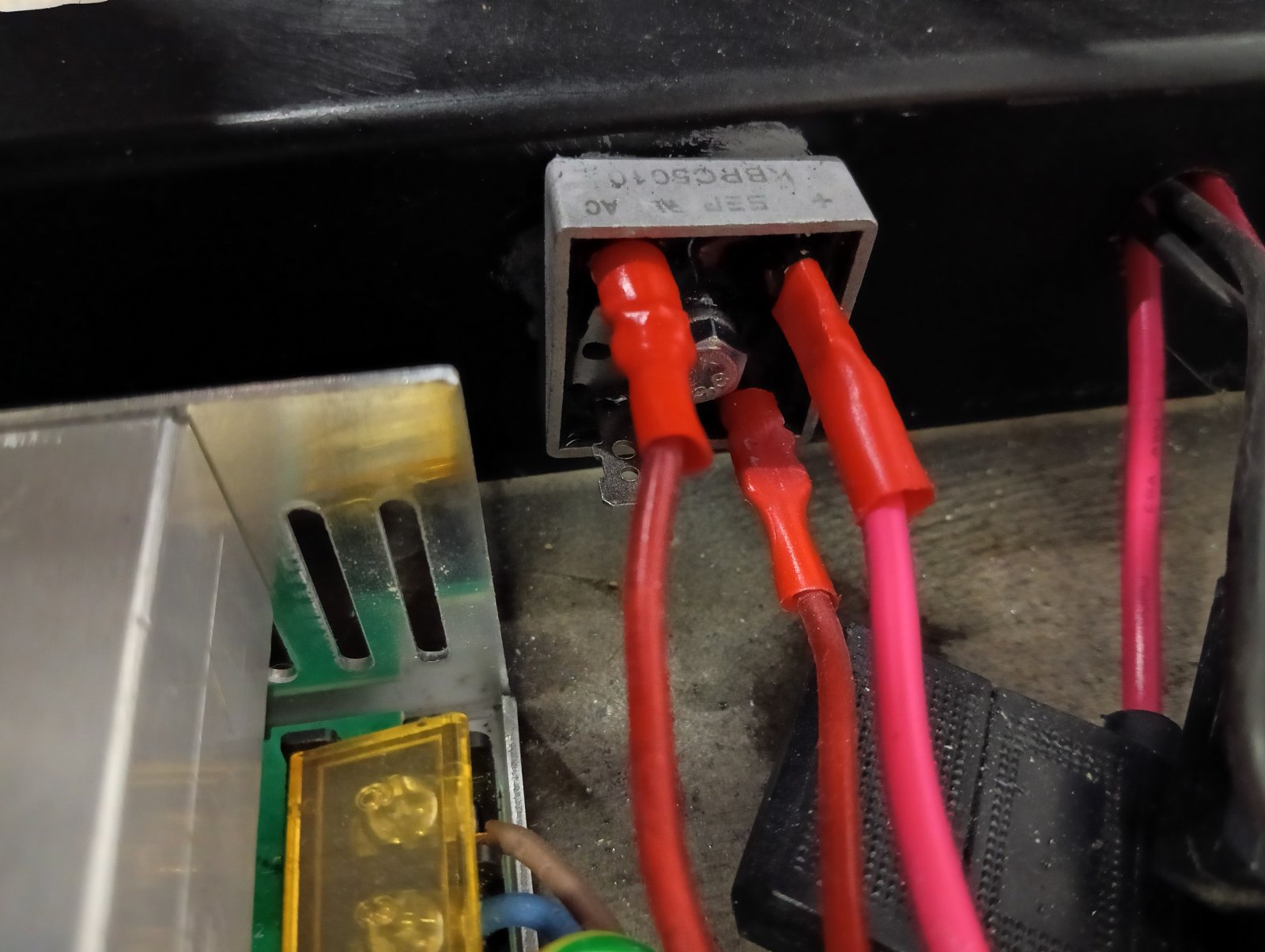

    Power supply 24V connect to both AC pin , + pin KBPC5010 connect to + motor driver, - pin KBPC5010 not used

    The small black boxes between the power supply and the rectifier look like fuses, not overvoltage suppressors. Or have I missed something?
    @Ronan Design I think it would be best to first carry out the test with the rectifiers and LED I suggested earlier. If we know that we actually need it we can discuss what action to take.

    Power suply 24V>KBPC5010>Fuse 20A> motor controler

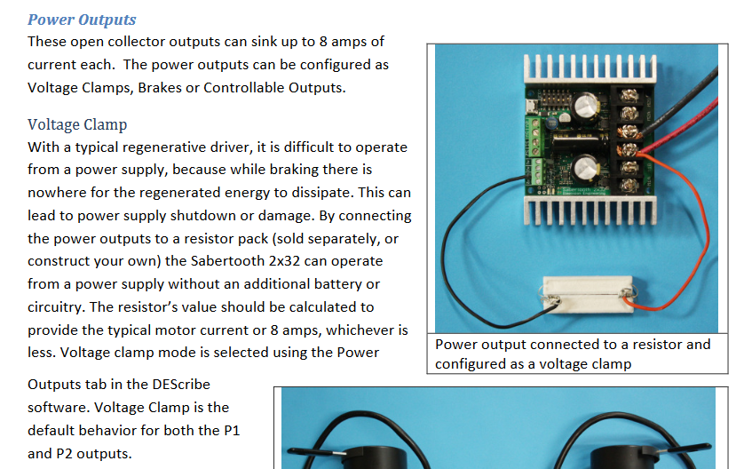

    BTW, I just saw that the Sabertooth drivers include a voltage clamp circuitry where you can connect an external energy dump resistor.
    This would make extra protection unnecessary. But of course, the Sabertooth is way more expensive.

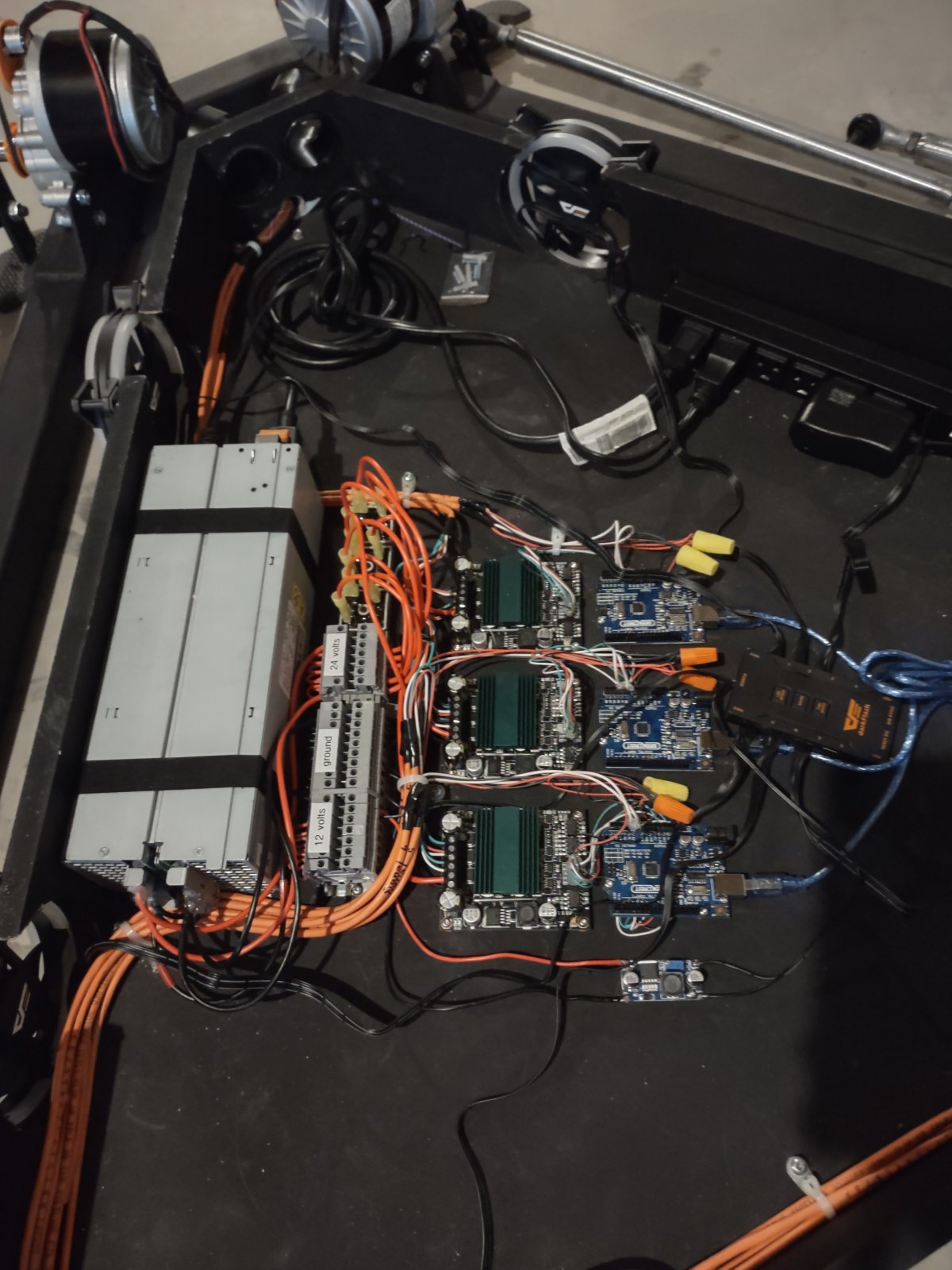

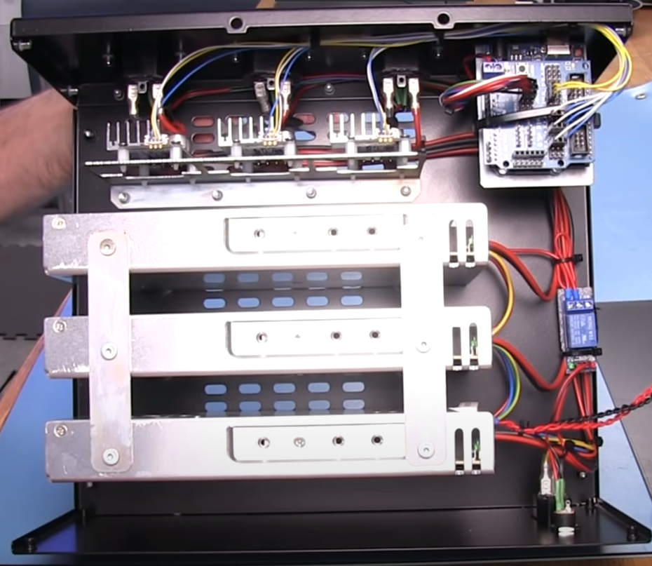

    Does it matter if the fuse comes before or after the rectifier in this chain? The common wisdom is to put the fuse as close to a power source as possible, and I have a fuse box usable for that, but not for putting fuses after rectifiers. So I'd put it as 24V PSU > Fuse 20A > KBPC5010 > motor controller.
    2 PSUs will go into the fuse box, and each will split into 3 circuits so that each circuit will have its own fuse, rectifier and motor driver.
    Does it make sense or am I losing any protection like that?
