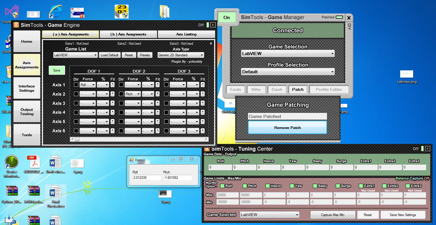

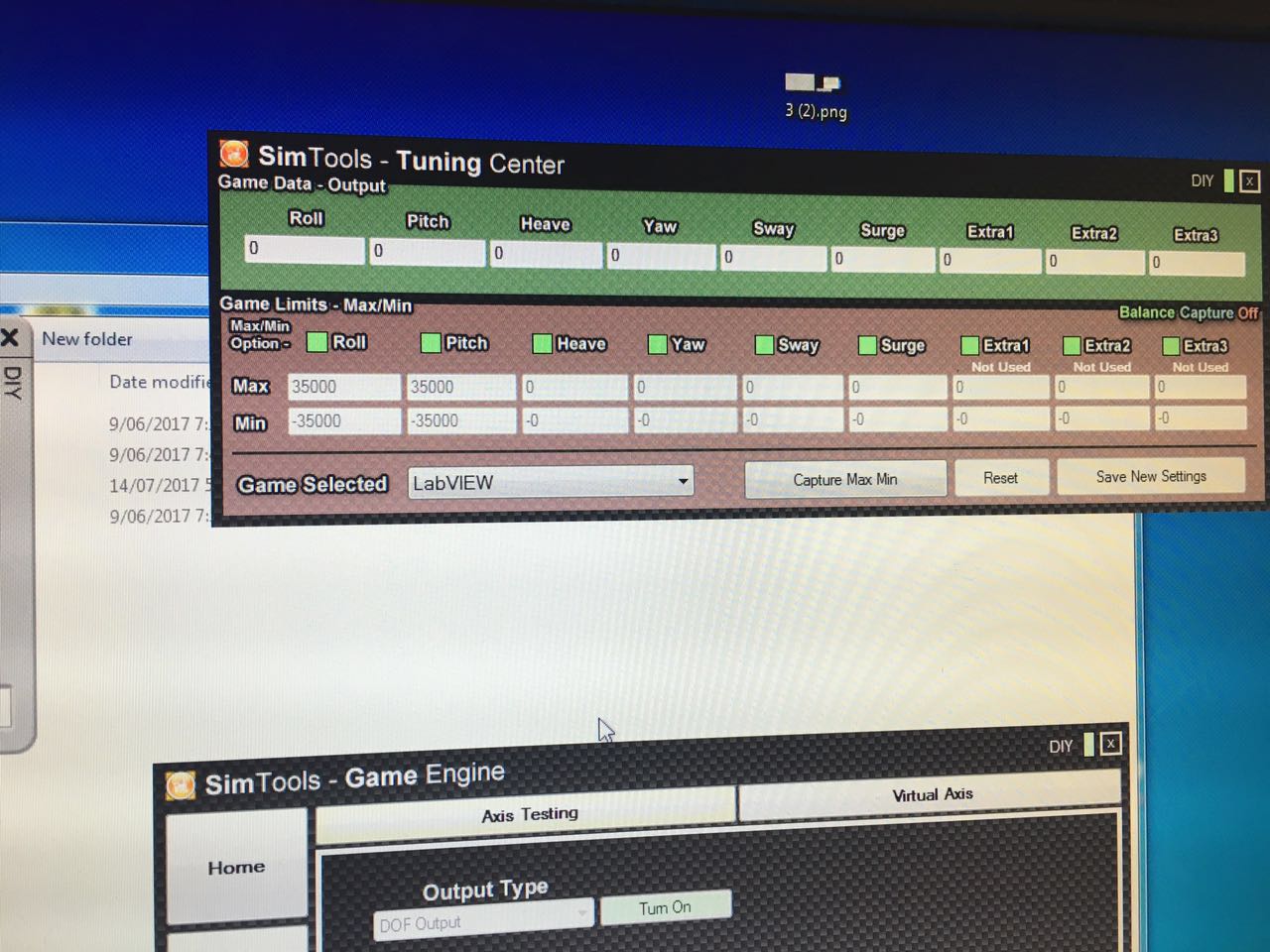

    Hi buddy, I get the DIY license, finally!And I tested your plugin after I updated my Simtools. I patched the game and I uploaded the plugin, and here is the result as it shown in the picture. The little app can capture roll and pitch data correctly, but in Tuning center I noticed the data output of Roll and Pitch always stayed zero. Do you think what's the problem? Is there any possibility that because I took the wrong settings or something? Cheers.
  3. yobuddy
    51,681Coins
    +5,204 / 19 / -0
    Close the test app buddy, both apps can't collect the data.
    I bet the test app is taking the data meant for the game plugin.
    let me know how it goes buddy.

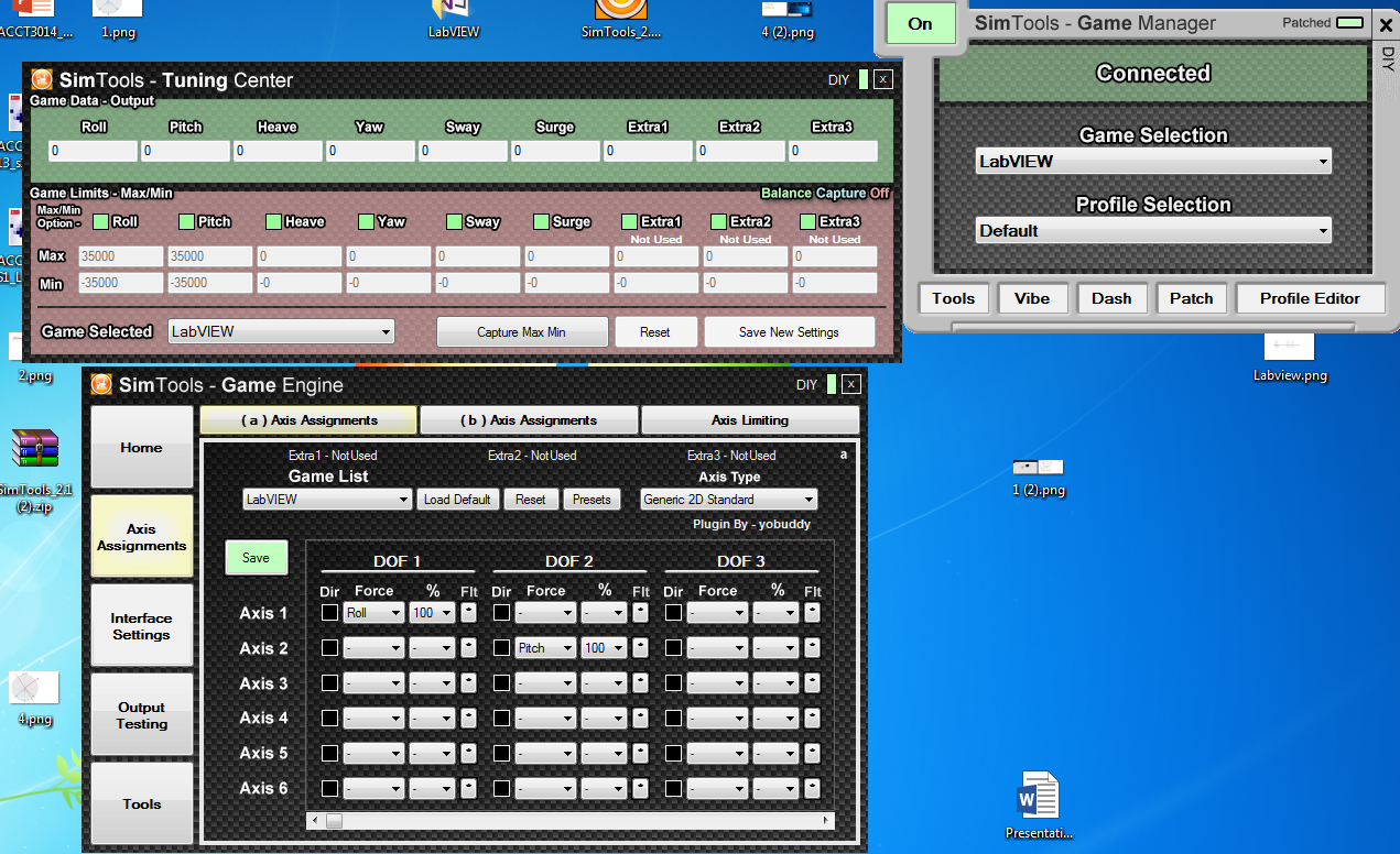

    Hey buddy, sorry for late reply! I closed the test app and tried again, but same result, no data catched. I'm strongly doubt maybe I set something wrong, so here's my setting.
    Open the GameEngine and GameManger, patch the game, set the (a) Axis assignments as picture attached, set interface 1 and 2 with 2 SCN6 motors, and open the tuning center, chose the game select as Labview, and then observe the Roll and Pitch value. Any step wrong? BTW, we I do the output testing, both motors can be control correctly, and we I open the test app, both roll and pitch value can be captured correctly. Thank you buddy!

    Does Game Manager turn blue when you launch LabVIEW?

    I dont think so buddy, it shows exactly as the picture attached with last posting. When I opened the Game manager, it just shown 'connected'. Should it turn blue when I open Labview? How can it know I launched it?

    Yes, It uses the process name buddy.
    Don't you have LabVIEW running when the plugin should be active?
    It seems the process name may be wrong?
    I'll post the source for the plugin when I get home from work.
    I'm sure its just the process name we need to get write, so the plugin will trigger and startup correctly.

    You should only need to change and recompile the plugin with a proper '_ProcessName' for it to work for you.

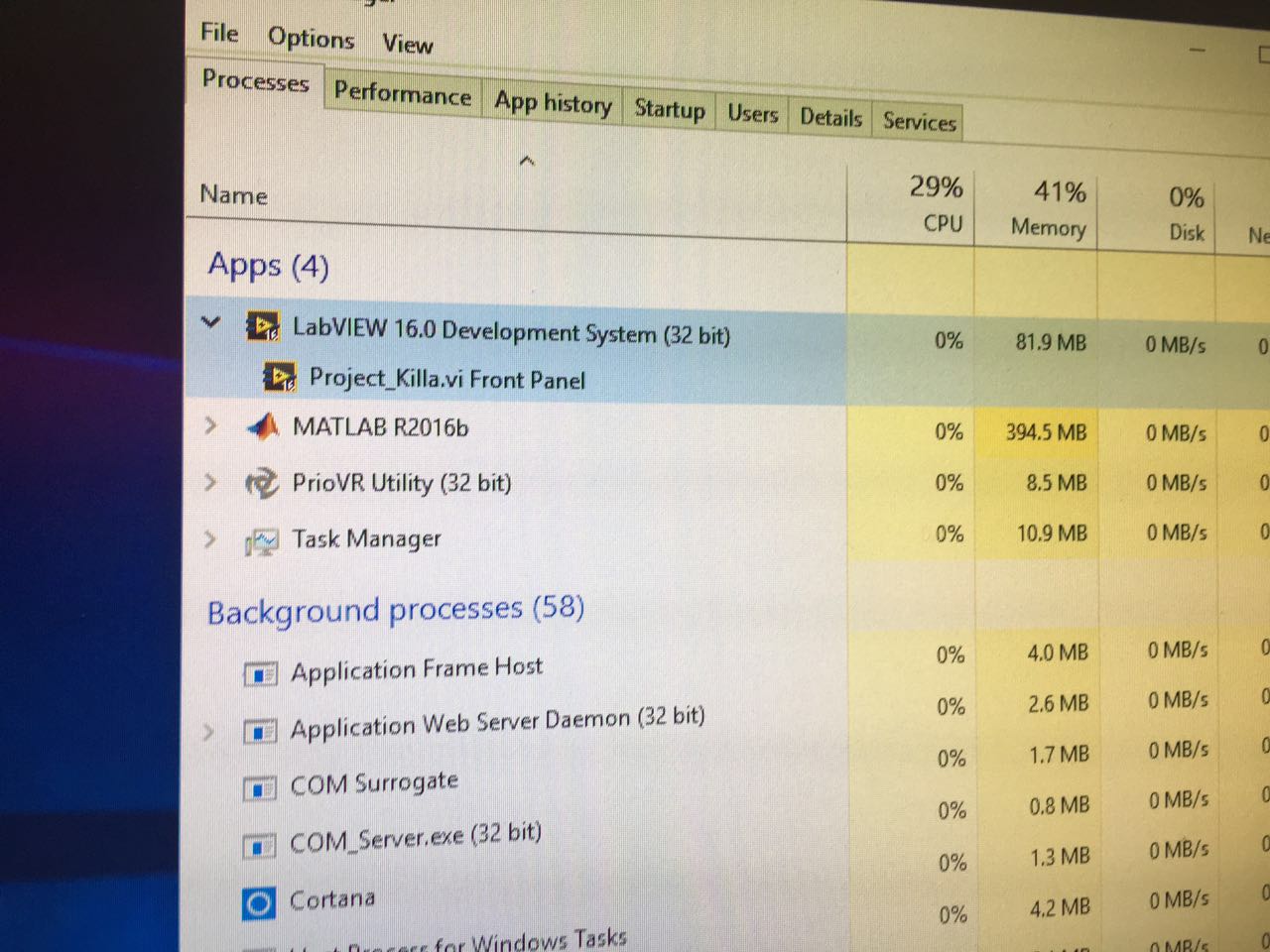

    Hi buddy, I tried to change the name in your original code, actually I tried "LabVIEW 16.0 Development System (32 bit)" and "Project_Killa.vi Front Panel" as it shows in the attached picture, but no response. I think it will at least show the value that I translate in the Tuning center. Do you have any idea what's the problem? Cheers. 408910740.jpg 94149137.jpg

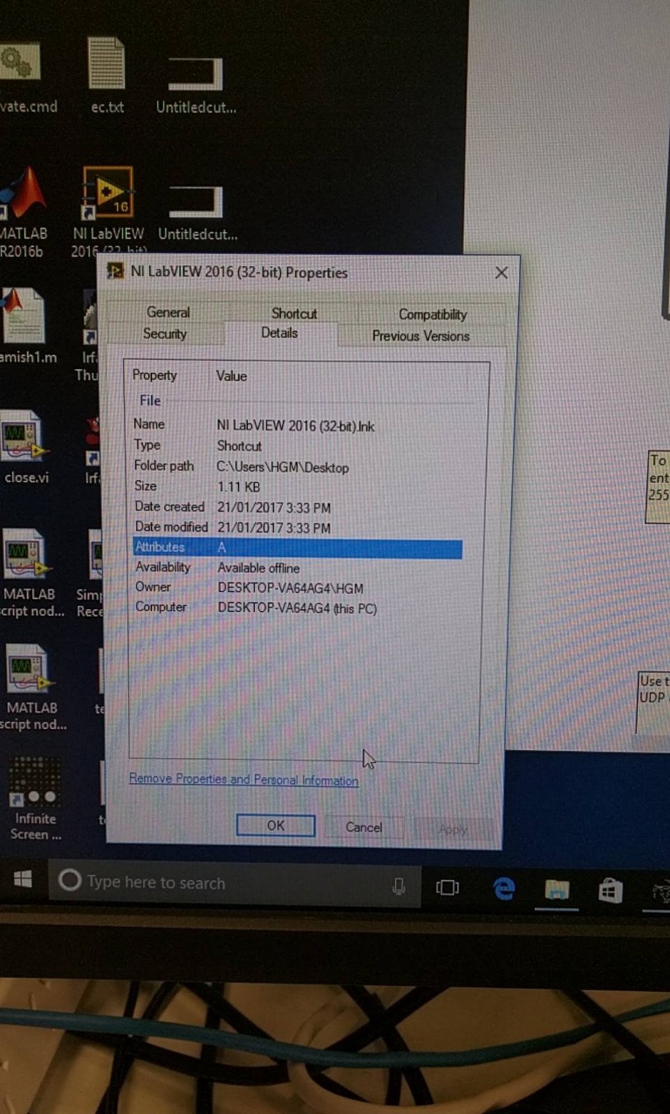

    Right click on LabVIEW 16.0 dev..., and select goto details.
    What does it say?
  12. ZKILLA
    ZKILLA Member
    Apr 5, 2017
    52
    Australia
    417Coins
    +7 / 0 / -0
    SCN5, SCN6
    Sorry for late reply! The picture is attached! Can you see it clearly? 20216437_10214115808355161_351570269_o.jpg

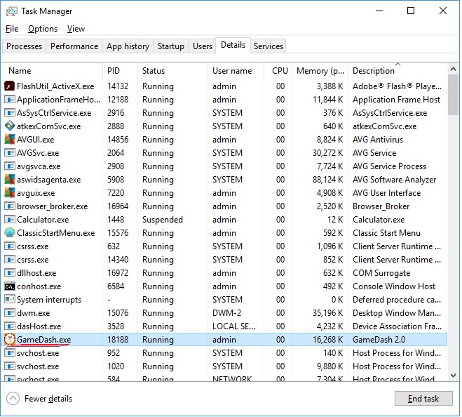

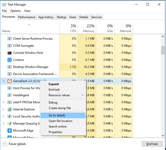

    Right click on "LabView 16.0 development system (32bit)" in the task manager.
    It will take you the name of the process that it associated with.
    Here is an example with GameDash,
    And I get this:
    That's the name we need, without the ".exe." on the end.
    Let me know buddy.

    Hi buddy, I checked it again and I'm very sure that the process name is LabVIEW.exe, the very first one that we discussed. So I really don't know what it the problem now···What should I do after I upload the plugin? Just open the GameManager and GameEngine and wait for the motor move?

    Please try this @ZKILLA
    1) Set the process name for the plugin to (LabVIEW), compile and install the all plugin.
    2) Launch Game Manager and Game Engine.
    3) Open Game Manager and "Patch" The labView plugin.
    4) Now launch labview, and SimTools should kick into action.
