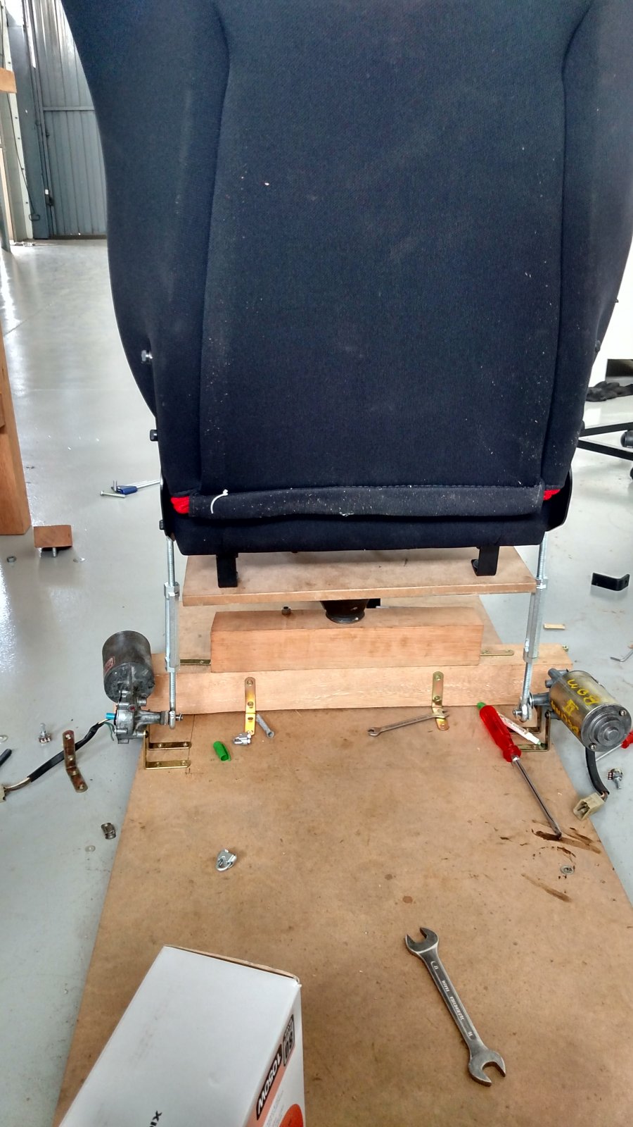

    I would move to shoulder mount, as I lately did, cause otherwise wiper motors could easily overheat and suffer. Because of the better levers you will also feel little motions that now would be lost. I had the same project as you have now, and I regret I didn't do it sooner.

    I would suggest you turned your joint upside-down so that the ball joint would be closer to the seat, avoiding unwanted lateral movements

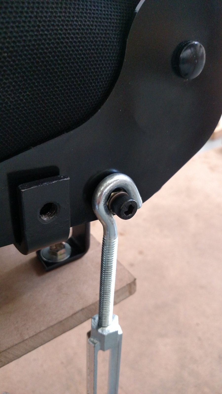

    I'm not using the ball joint, Look i introduce the nut in my screw
  7. Nick Moxley
    17,057Coins
    +2,507 / 30 / -2

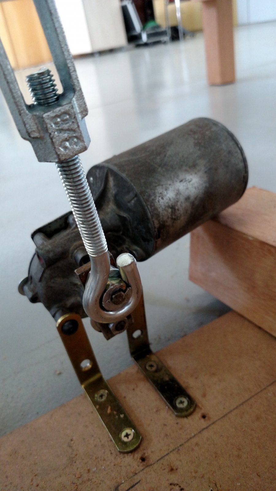

    Oh No No No....That will NOT work.
    Nor will those motor mounts.

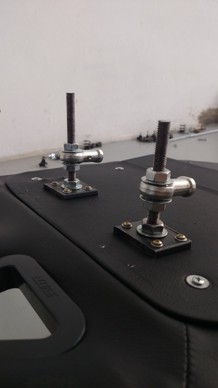

    I personally suggest the Rose style rod ends...part # SQ10-RS....i had a set of the cheaper rod ends that Tombo posted that failed real quick, Not to mention they lack in the "angle" department and might require spacer's of sorts.

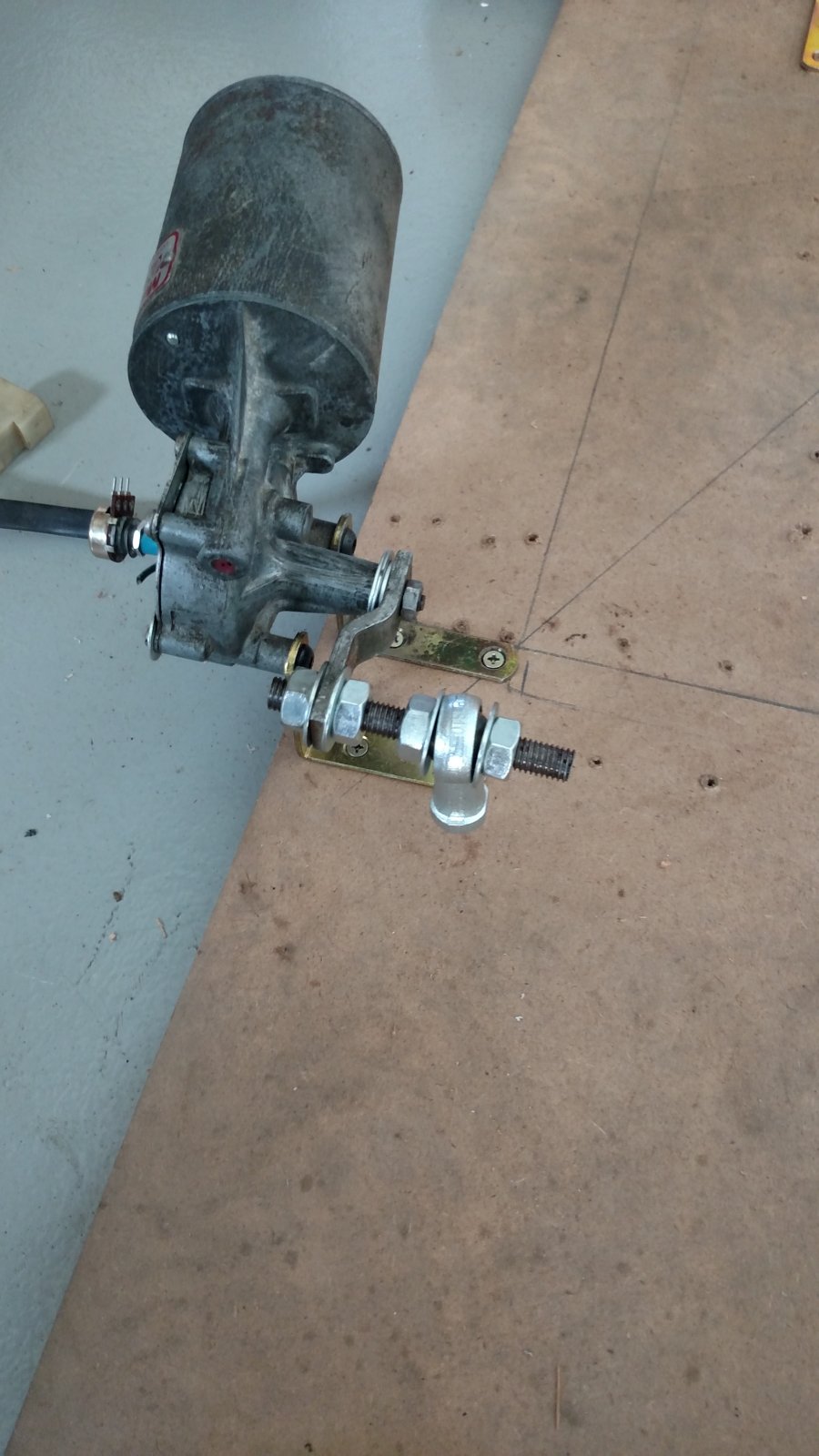

    Motor mounts Defiantly need to be upgraded they unfortunately wouldn't last 5 minutes before bending out of shape and causing all sorts of issues.......For what its worth, The Small Angle Iron was able to be Twisted in how i have my motor's mounted, The Big Angle Obviously Not. Yes i have stronger motor's that you do, But thats beside the point. BUILD it Strong once, then you wont have to revisit these problems down the road.

  12. bsft
    Motor mounts are too low. The motors will struggle, and if you decide to comment "thats what you did in your video, " , yes I did, however, it works better desk racer mount of shoulder mount.

    This is the somewhat ideal setup for the motor's/Arm angles. Yes more angle would be slightly better, but somewhat marginal unless you have the real estate to play with. Your running wiper's so you need as MUCH mechanical leverage as possible to help the motor's.

    I don't find the tip rod like you told @Nick Moxley but i find one look in the picture,
    now I'll adjust the base and the motors supports,
    @bsft I did a test with the motors in the base, but i had problems with the mechanical supports, so I stop the test and Start the new modifications

    Those rod ends wont work like that, they will for sure need spacer's. The Rod ends need to have as Much "angle" travel as possible. The washers you have on currently will SEVERELY limit the angle's the rod ends can work with.
    This is WHY i suggest the SQ10-RS version's....they have Double the Angle of a standard Rod end.
    What is your plan for the motor mounts ? or i guess those will come with the redesign to accommodate some proper Angles on the arms ?

    @Nick Moxley i'll follow @noorbeast suggestion, and put the cone spacers.

    that bracket is NOT helping, the brackets will flex to much.
    either make proper brackets of build it like @Wanegain design.
    Im lost as to what or how your are trying to do things, so good luck doing whatever you are doing.

    I agree with @bsft, it will flex too much. You really need something stronger !
    If your structure is very rigid, you will enjoy longer your simulator but mostly you will enjoy the small effects that will not be absorbed by the flexibility of your system
