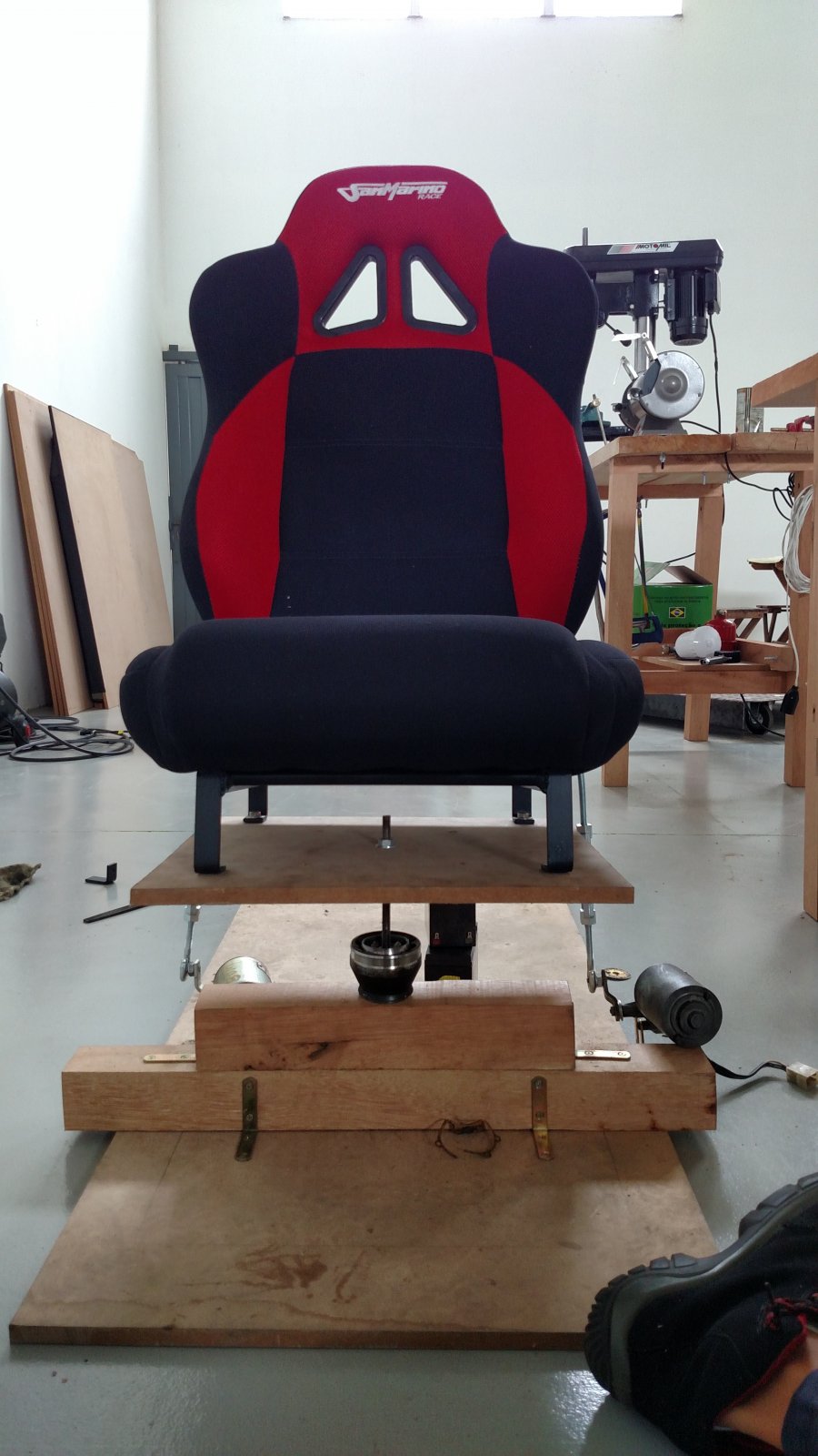

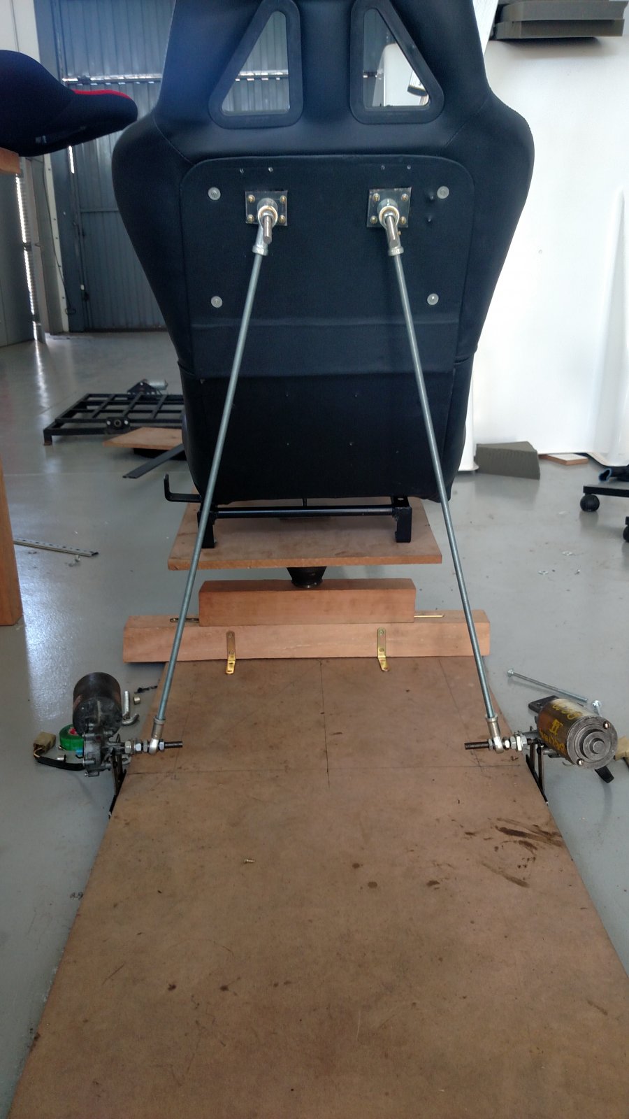

    I make some changes.

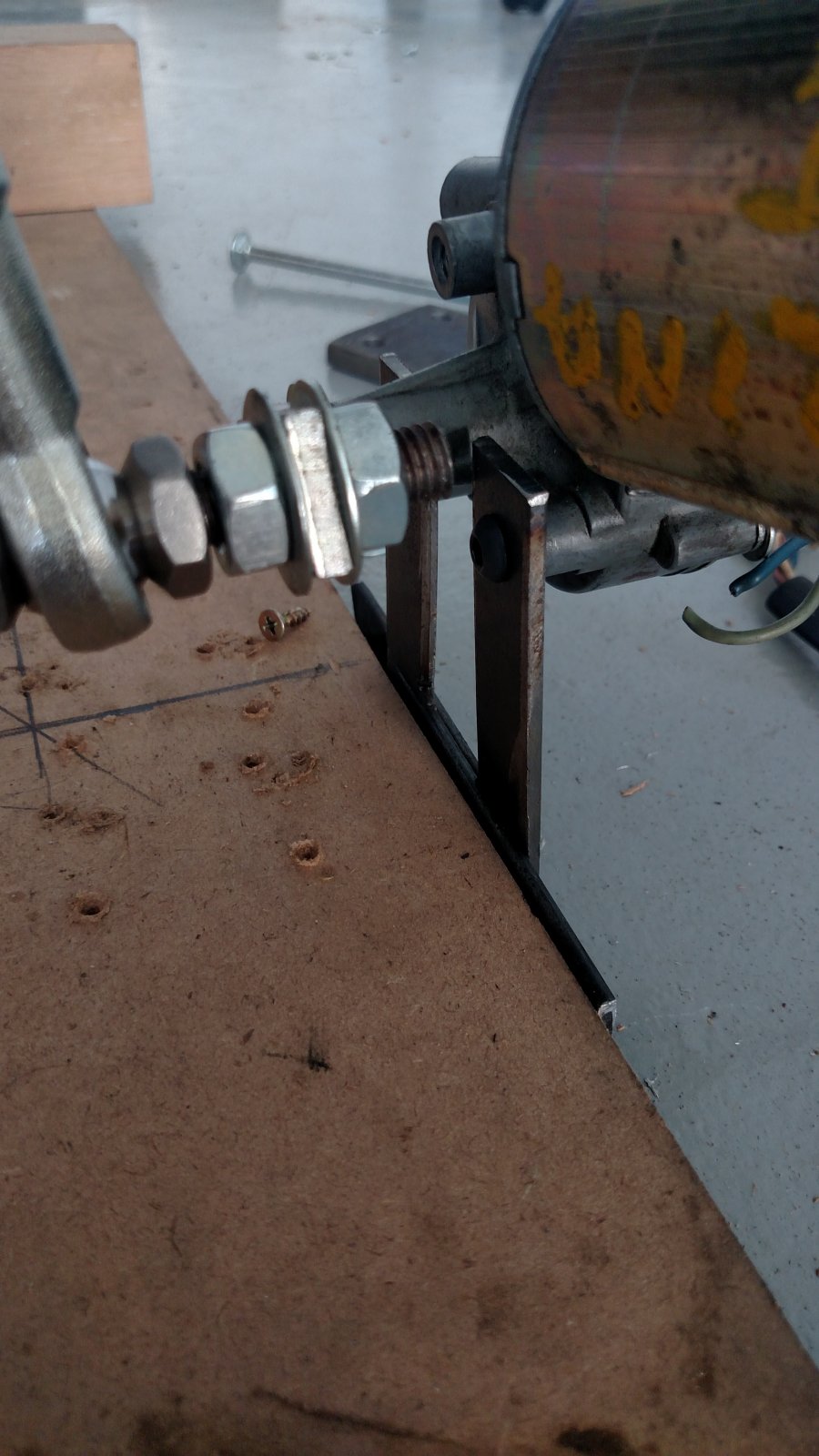

    I use the tip rod and conical nut,
    change the motors supports but I have not fixed in the base yet, I'll pass the screw between the wood and metal plate that hold the motors. check it out.
    IMG_20151007_151338825.jpg IMG_20151007_151415593.jpg IMG_20151007_151453255.jpg
  2. Nick Moxley
    17,057Coins
    +2,507 / 30 / -2
    I still fear those mounts wont be strong enough. Mount them then sit in the chair and bounce up and down a bit, If they Flex ANY little bit. They aren't strong enough.
  3. bsft
    Agreed, with what I can see, (pictures are taking too long to load, like the page was open 5 mins and nothing happened), the brackets are way too thin. Find something 4mm thick and mount the motors inside the edge, not outside

    Be careful with the angle of the ball joints.

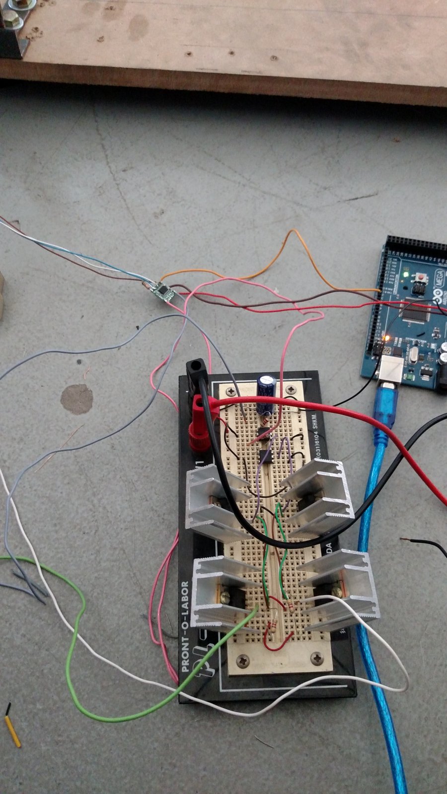

    I don't know if it was brought up already, but have you considered JRK for your motor control? I'm guessing that's what you mean by H-bridge. My team wanted to design our own controllers but it was just easier to use the JRK.
  6. bsft
    @mgill4bu , JRKS are a little costly yes, however, if you have the time and patience, (I certainly dont) then go with an arduino and h-bridge. So if you have time changing codes and sorting things out to save a quid, then go ahead.
    Meanwhile , a mate of mine was messing for nearly 2 years with arduino code , I stepped in, set up some JRKS on his sim and withing 15 mins he was driving and moving like never before.
    Personal choice and cost factor mostly.
    Oh and Ive put the JRK under commercial sim application, meaning constant use on 2 hire out sims. Ran spot on all the time. For the money spent, its so much better.
  7. Bordiin
    Bordiin Active Member
    Sep 23, 2015
    106
    Brazil
    159Coins
    +98 / 1 / -0
    Sorry not answer you in the last weeks, My work take a lot of time.
    @mgill4bu @bsft i'm using the H-Bridge, i found the MM's to buy in brazil but to expensive. so I take the board inside the micro Server Sg90(Little motor to prints) I used in my prototype, I changed the potentiometer and made H bridge with Mosfet's. Works fine but the motor doesn't have torque. Maybe because the motors are old. i'm waiting to arrive a new motors.

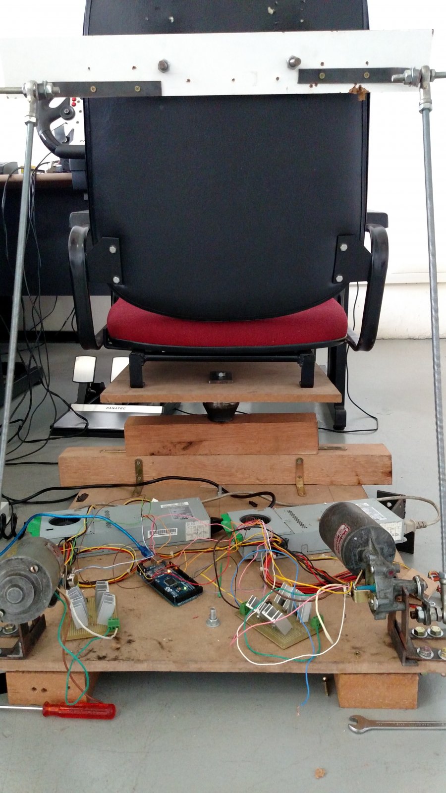

    After a long time, i figure a way to do the first tests.
    I have lot of to improve the mechanical.
    I need help, look in the video, the seat have a strange movement for sides, i think it's not normal, I'm using the Joint ball with conical nut.
    I think the angles are wrong. Have a thread when explain more about the angles?

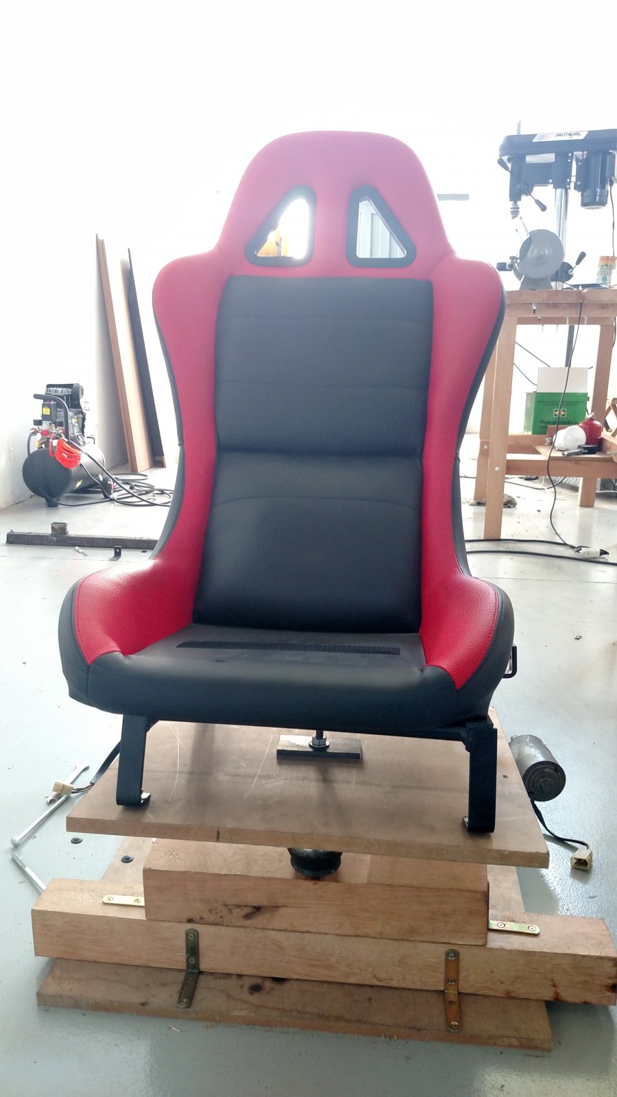

    Hello Tombo
    Yes, I'm still using the CV. But i cut. now it's smaller. look the picture

    Right! This is a prototype,
    I'm start building a new, I already bought the new motors and new power supply. I need time to start build the mechanical structure.
    But What you used instead Ujoint?
