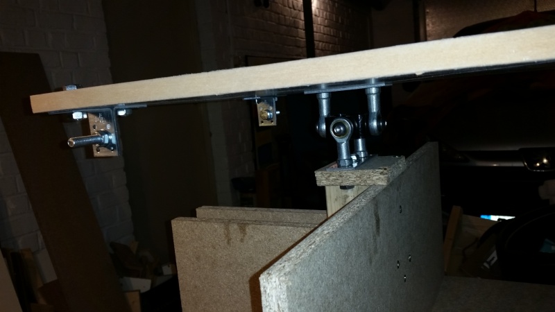

    Hi, I have just completed my 2Dof build using wiper motors and similar layout to you.
    Yes I used M8 rod ends (see pic) top and bottom
    screwed on to a M8 threaded bar - cut to length (mine are 400mm each) to give pivot movements top & bottom.

    I also think you need the top mounts on to the seat base raised higher.
    I ideal height of top mount is in line with your centre of gravity, which is the approximate height of your belly button when sitting on seat,
    this will give you a more even controlled roll effect (side to side) with lower power motors.

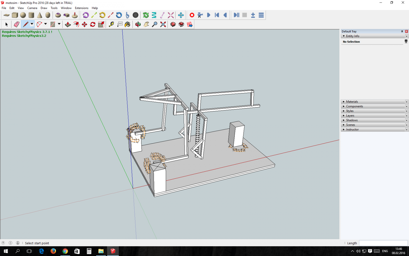

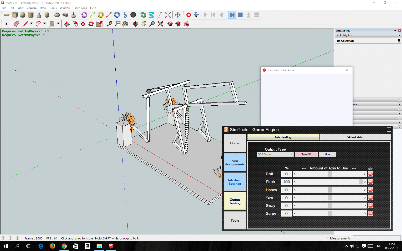

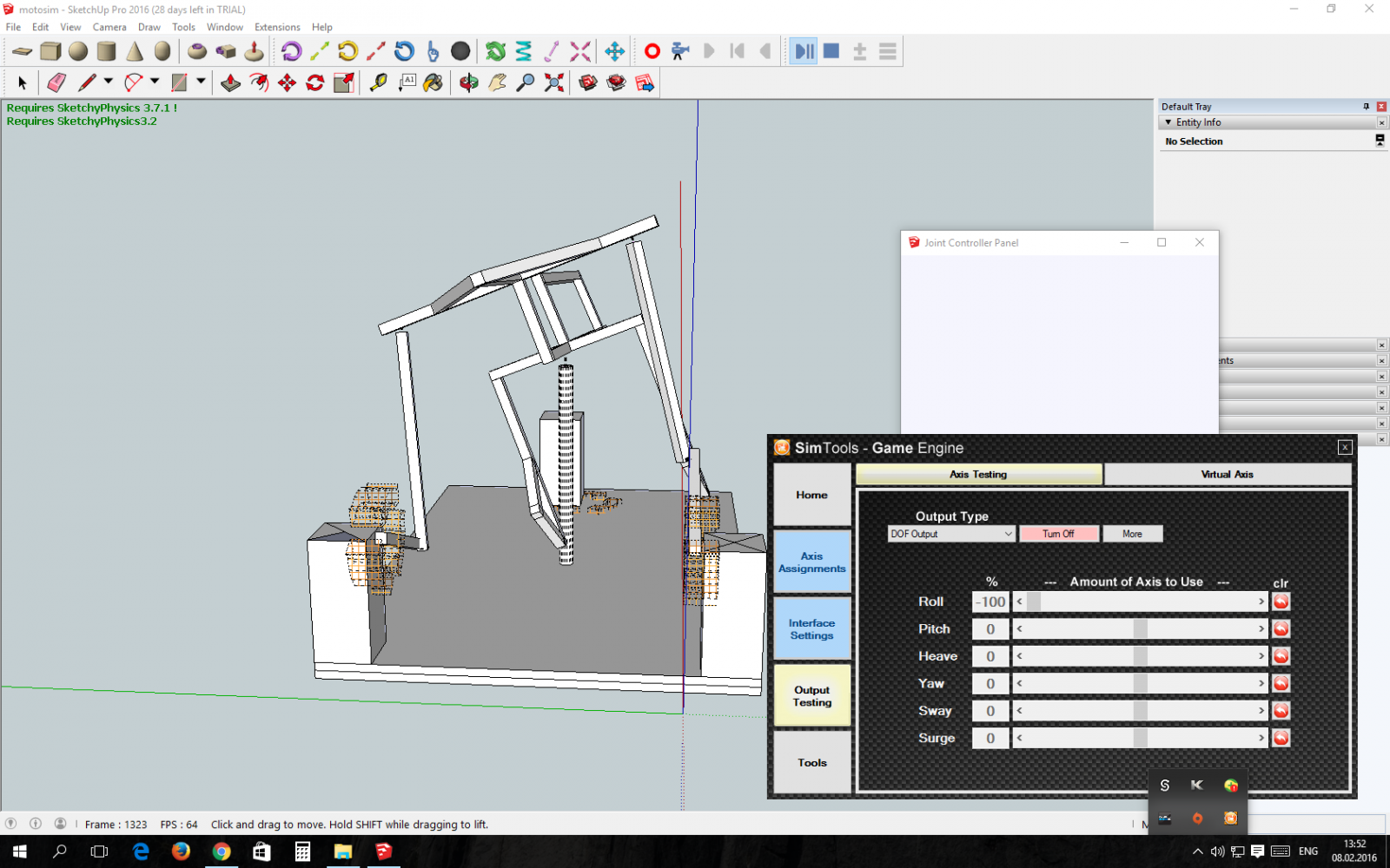

    Hello guys! In very new in those community, so hope you can help me with my project.
    I cant find information, because it is motorcycle platform, not car.
    I need to know, which engine i must use with my sim. Im attaching the pictures, with project.
    Engine arms lenght is 30 cm.
    Also, i will be very thank you, if you can help me add traction loss DOF.
    Im attaching picture of my project.
    Already thank you.
