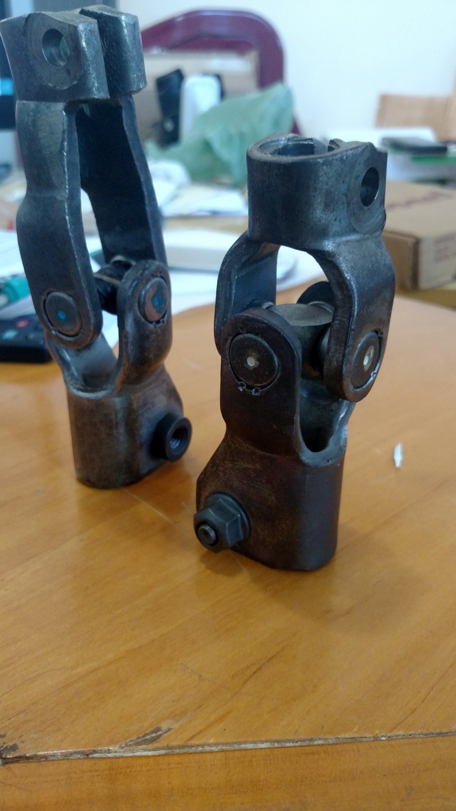

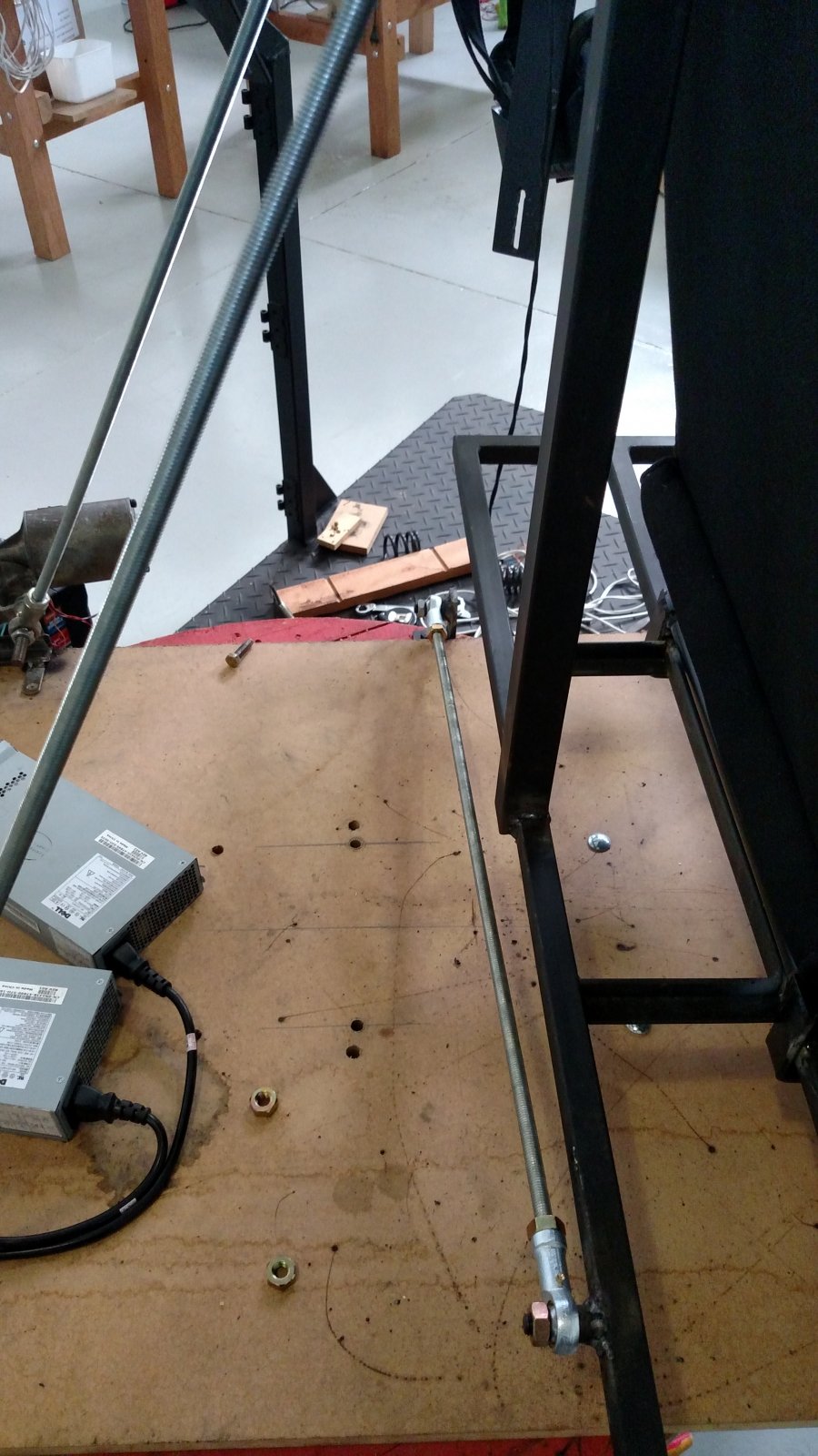

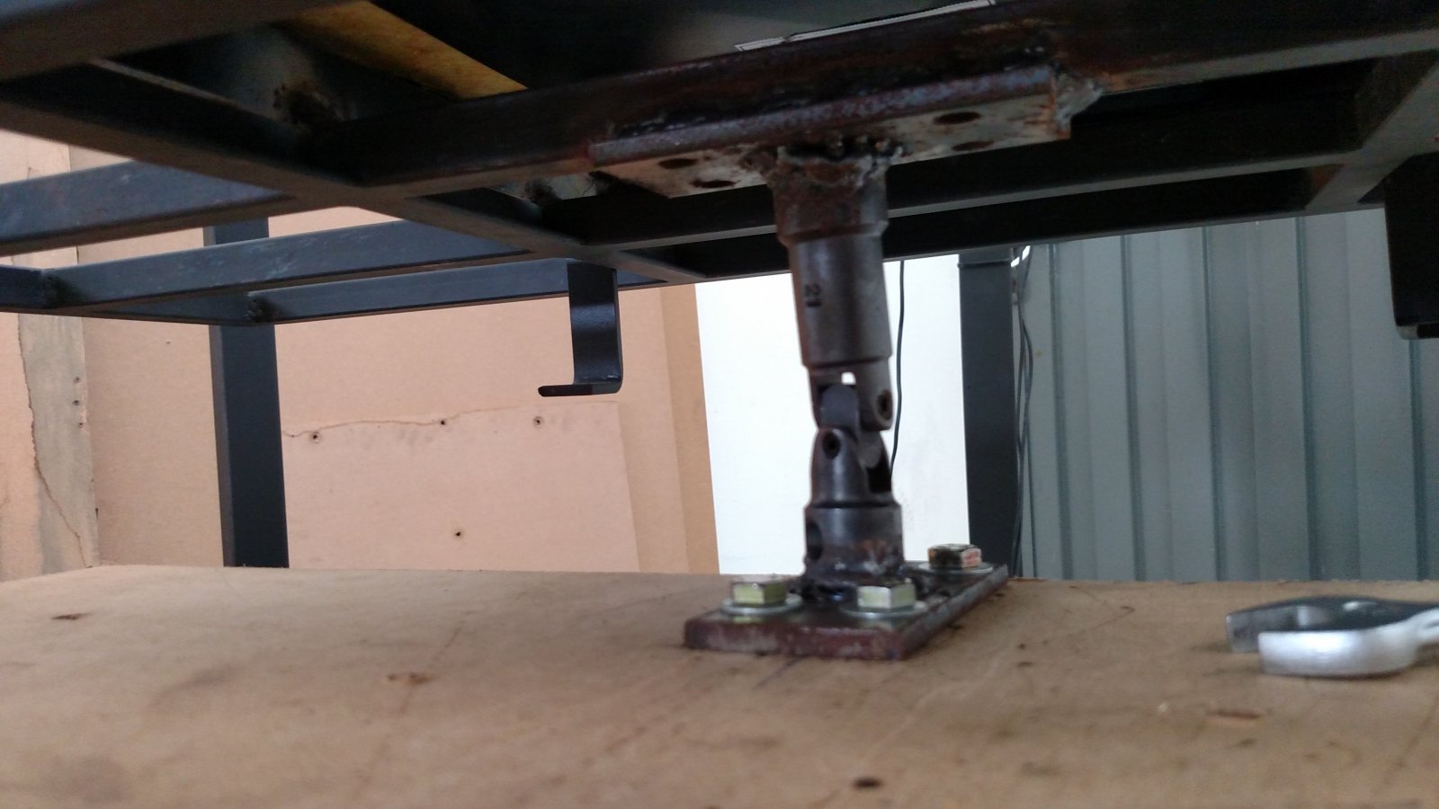

    @shannonb1 This movement is from the joint, there is no loose in it. I'm going to make the panhard style rod to stabilize the twist. What did you mean to "have slop in your bolts holding it together" ?
  2. shannonb1
    shannonb1 Well-Known Member
    Mar 12, 2008
    1,106
    Sales Intelligence
    Virginia
    8,909Coins
    +598 / 5 / -0
    Because a u joint by nature is only designed to move in 2 directions. You actually have an additional twisting DOF with yours. This makes me thing that the u joint bolts could be lose and have slop or play in them. Think of a u joint like a knuckle. Your finger only bends straight. A u joint does the same but goes straight and then imagine turning it 90 degrees to front ot back and side to side. That twisting you have makes me think the seat, the joint, the mount..something isnt tight and its allowing the twist.
    Even better think about it like the thumb stick on an xbox control. It goes forw/back and side to side...sure it can also go for left, forward right back left and back right but AT NO time does teh thumb stick rotate clockwise or counter clockwise...if it did your control is broken. Using a U joint or Steering Joint should allow for that movement Im seeing. SOmething has to be loose.
    22,208
    154,711Coins
    +11,212 / 57 / -2
    I agree with @Nick Moxley and @shannonb1, that looks too flimsy.
    You should also have the larger more robust U joint as close to the seat as possible.

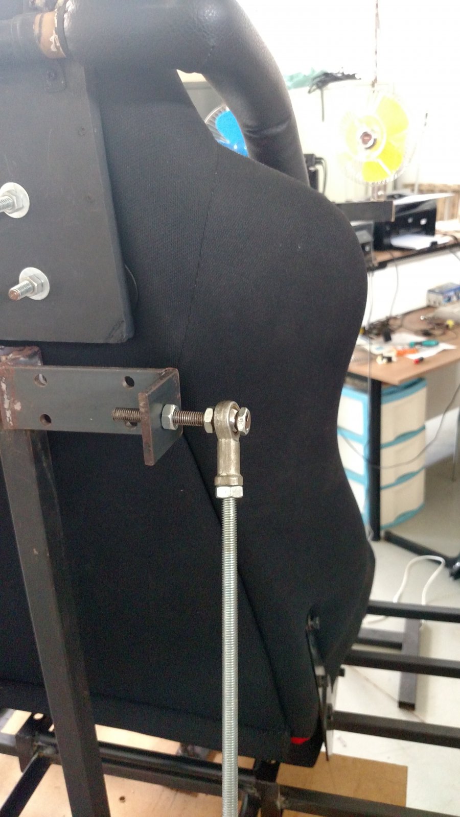

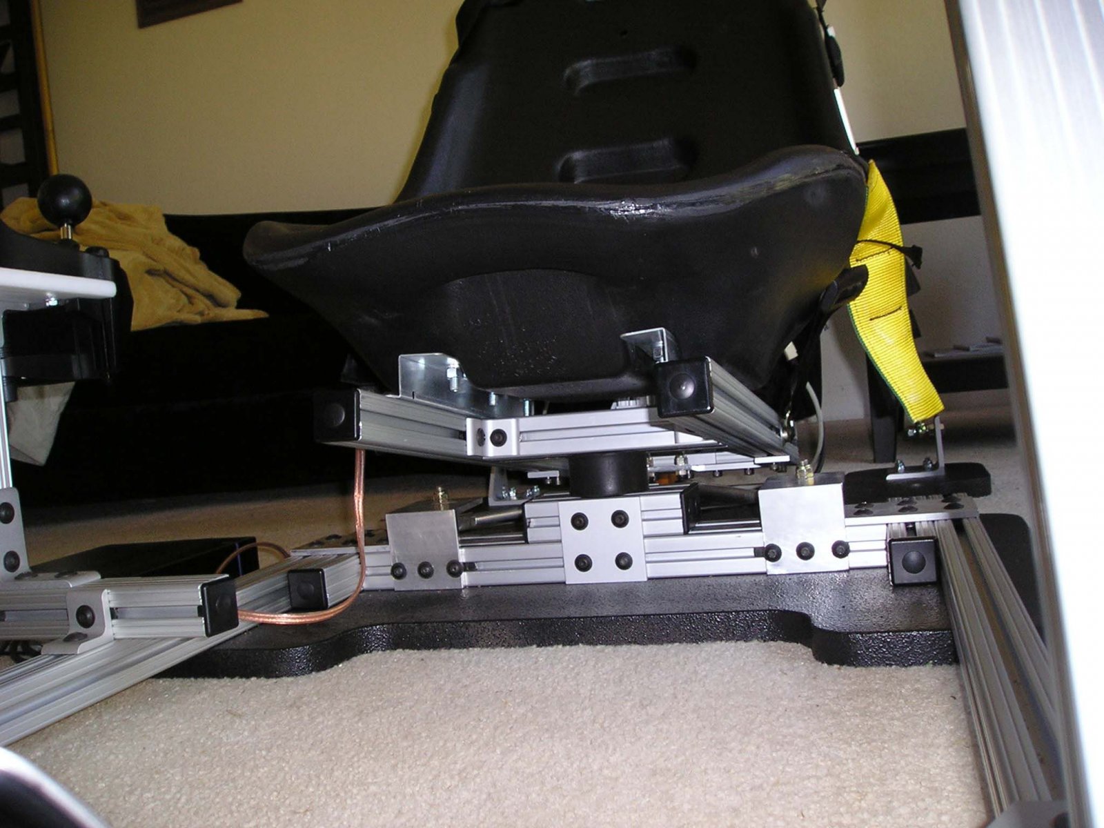

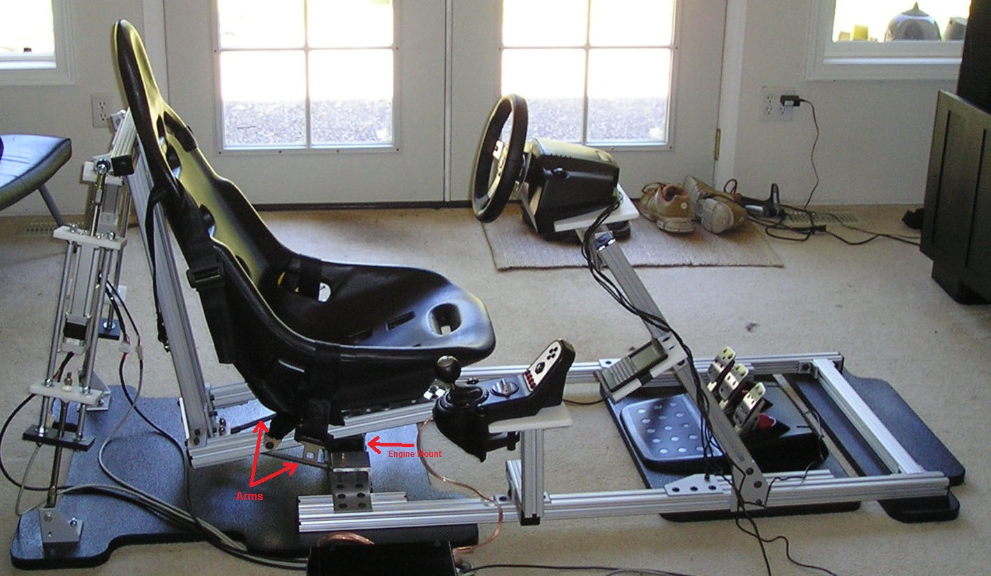

  4. yobuddy
    51,747Coins
    +5,205 / 19 / -0
    You can always use an motor mount and a couple of rods also.
    Being that a motor mount is pretty heavy rubber, it adds a bit of upright tension to a heavier simulator.
    Unfortunately these are the best pictures I have of my old sim and this kind of setup.
    Notice the arms are attached inline with the motor mount. And the arms are attached high enough on the frame so they bend in the same relative plane as the rubber motor mount. (or you may get some pinching)
    The arms attach in the back of the chair also inline with the motor mount.
    -by rods I mean threaded rod with an aluminum tube sleeve and ball end bearings on the ends.
    Sorry I don't have better pictures of it.
  5. Bordiin
    Bordiin Active Member
    Sep 23, 2015
    106
    Brazil
    159Coins
    +98 / 1 / -0
    I did the change that @noorbeast suggest, look at the video and the picture.
    I test with an 80kg guy, and the u joint looks fine, maybe to a heavier guy I need change the u joint.

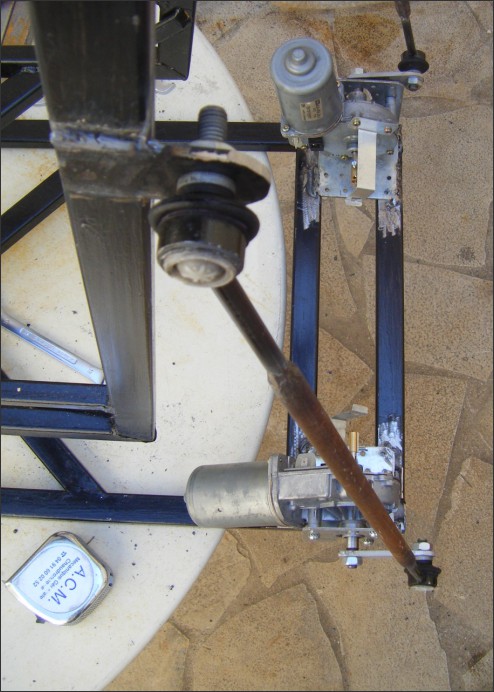

  6. shannonb1
    Mar 12, 2008
    1,106
    Sales Intelligence
    Virginia
    8,909Coins
    +598 / 5 / -0
    Second thought, you have your motors really wide. You also have your motor arms on the inside. In general I find I have better performance when my motor arms are mounted on the outside.

  8. shannonb1
    Mar 12, 2008
    1,106
    Sales Intelligence
    Virginia
    8,909Coins
    +598 / 5 / -0
    No, I was referring to the lower mount

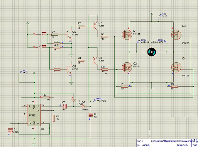

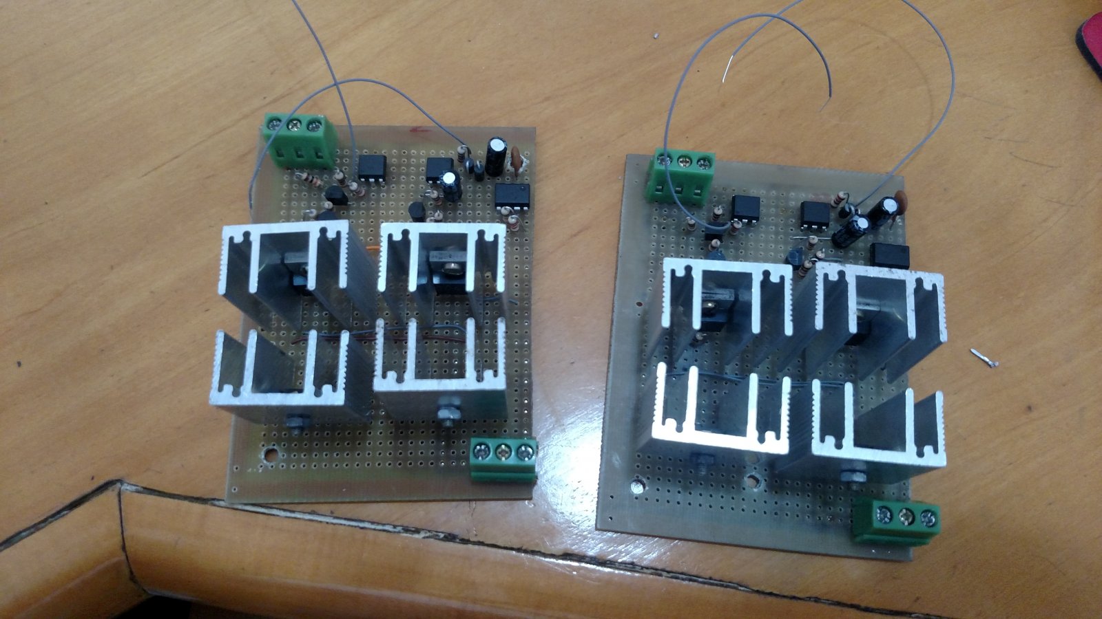

  12. Bordiin
    Sep 23, 2015
    106
    Brazil
    159Coins
    +98 / 1 / -0

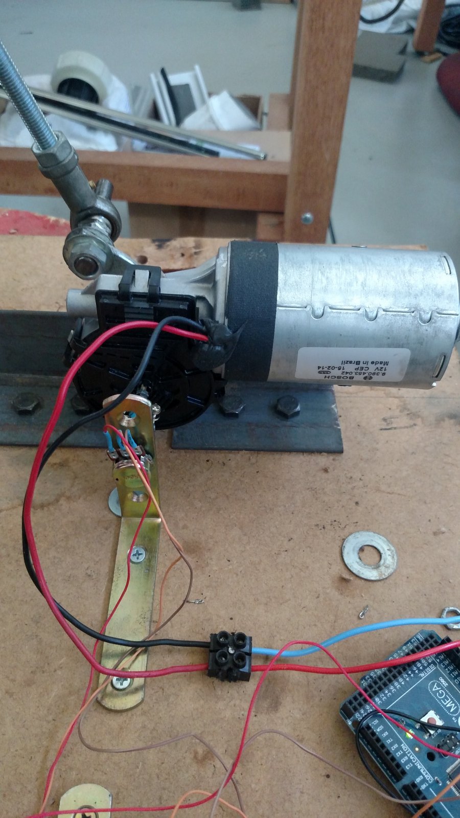

    I bought a new CV, and i made a new H bridge to 40A, follow the schema of the h bridge adn the picture of the new CV
