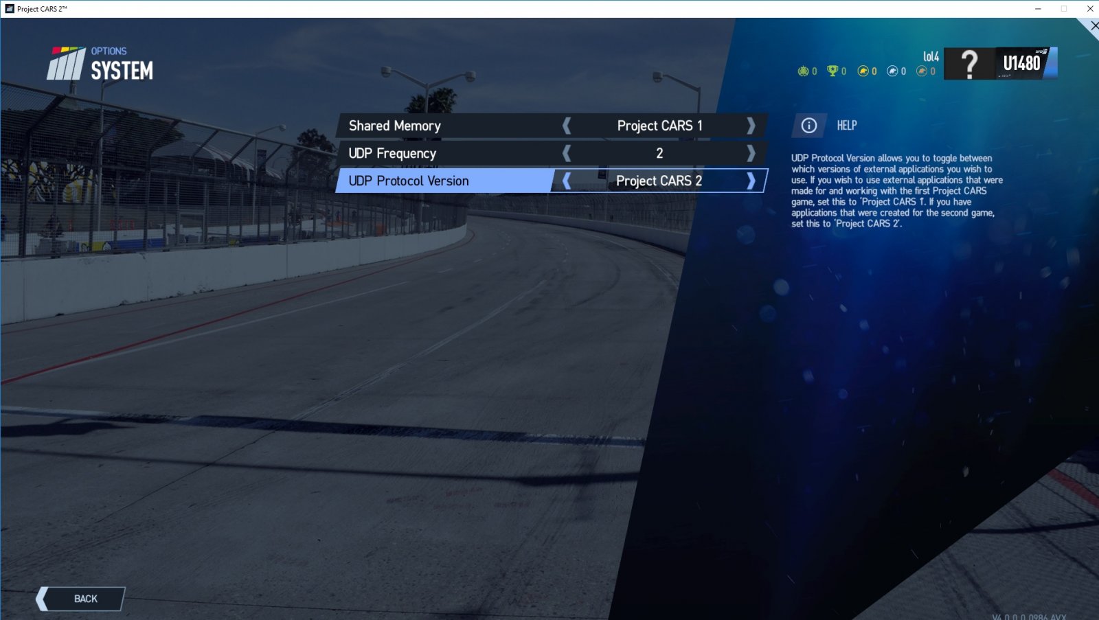

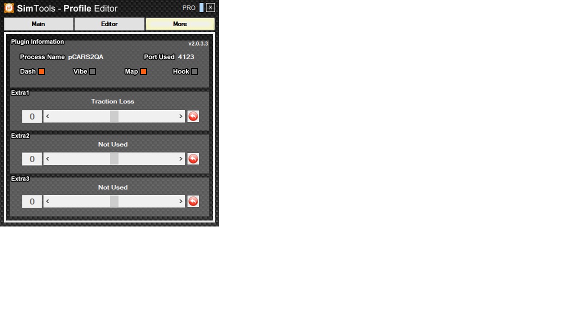

    Just wanted to see if others have got Ga me Vibe working with PC2? I have updated via plugin updater, checked is enabled in game manager, IP is ok,, re patched a few times and all movement as per usual is ok, Game Vibe works fine in Dirt Rally. I did notice that it is not highlighted as per attached screen shot. If anyone can confirm is working ok for them I will keep trouble shooting this end. Also attached my PC2 settings but have not changed these as movement is fine.

    i think this is for PCars 1 not 2

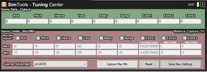

    Yesterday I purchased Simtools and download package to download the plugins. We managed to get LFS working perfectly and when we use the project cars plugin it does not move anything. Already activated Shared Memory in PCars but still no movement from the actuators.
    We got very little movement, but with an older version of the plugin (1.0) But when we use the same axis configuration as LFS the movement is very restricted and nothing like the previous one.
    What do I have to do to get this thing up and running?

    We did the conversion from frex to simtools using rs485 adapters. We managed to get LFS workign fine by just using the preset for SimforceGT. But when we use that preset in PCars the actuators barely move at all. I never messed with tuning center for LFS, why do I need to do that with PCars? Isn't it supposed to be just for fine tuning?
  13. noorbeast
    22,202
    154,675Coins
    +11,209 / 57 / -2
    Follow the steps in the link previously provided and lower the Tuning Center values.
    A motion profile has to be tailored for every game and every rig for best results.

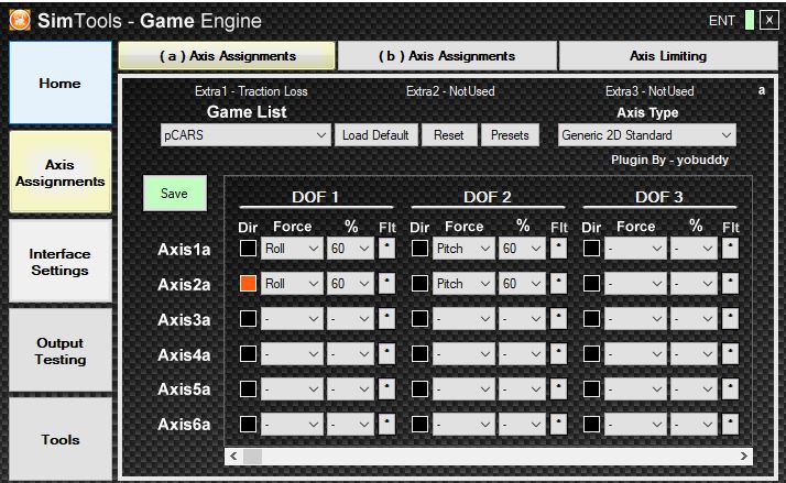

    @madVape
    Looks like you are using Sway and Surge for LFS, but using Pitch and Roll for Pcars.
    Probably the issue is you meant to use Sway and Surge for Pcars too?

    Yup, I had tried the same settings. Sway and surge, but got no results. The problem was in game tuning. I didn't know I was even supposed to mess with those settings, Once I dropped the values to 3 instead of 10 it all started working fine. ;) Thank you very much to everyone for the answers ;)

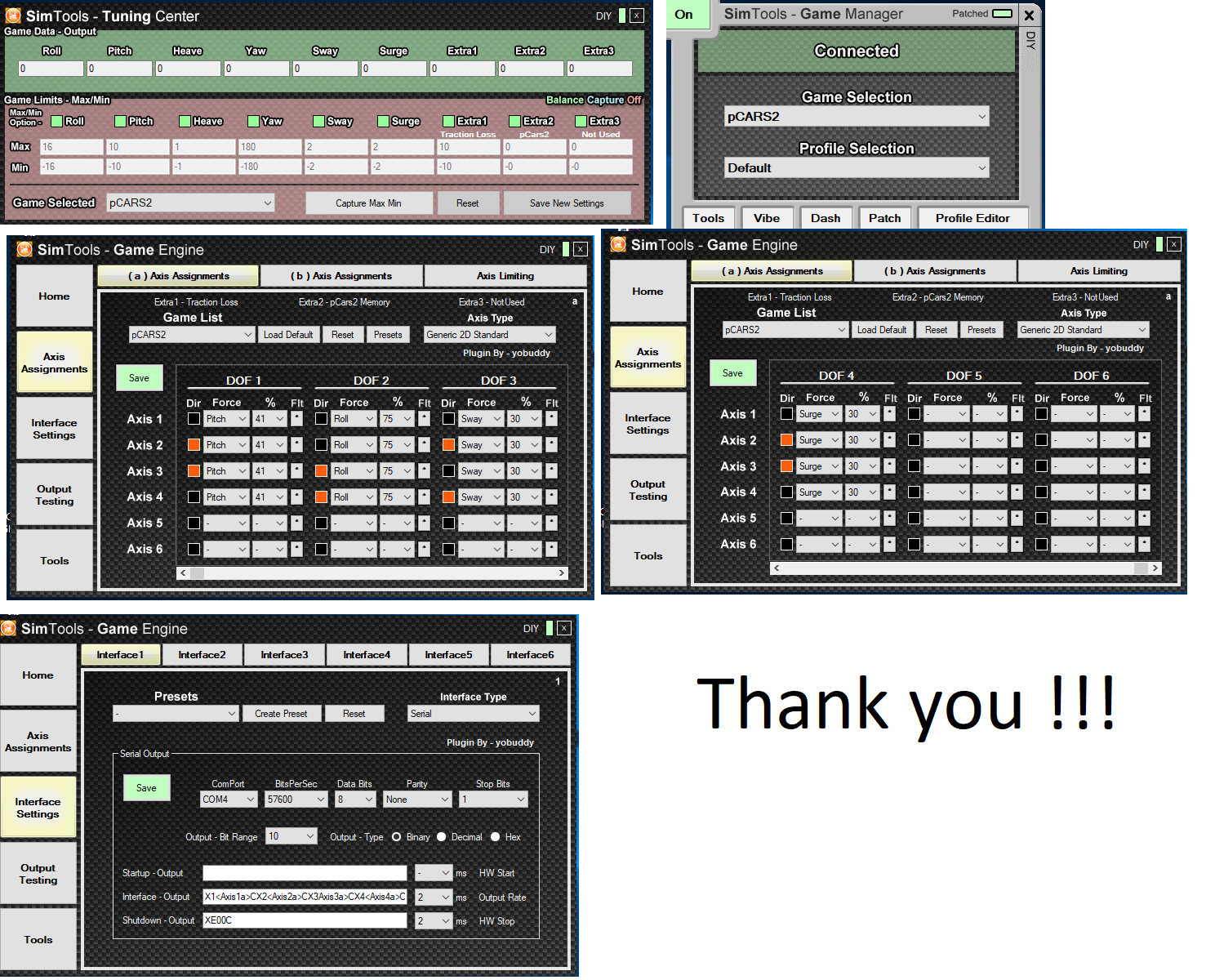

  18. Pitchoun511
    Pitchoun511 Member Gold Contributor
    Aug 29, 2017
    35
    Perpignan
    387Coins

    Can you please post pictures of all of your settings, particularly your Interface Setting, Axis allocations and Tuning Centre.

    Here are the visuals. I have two other problems:
    - I can not edit a profile in "interface settings"
    - video ride player does not appear in my list of plugins
    Do you think these three problems are the same?
