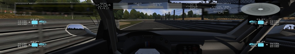

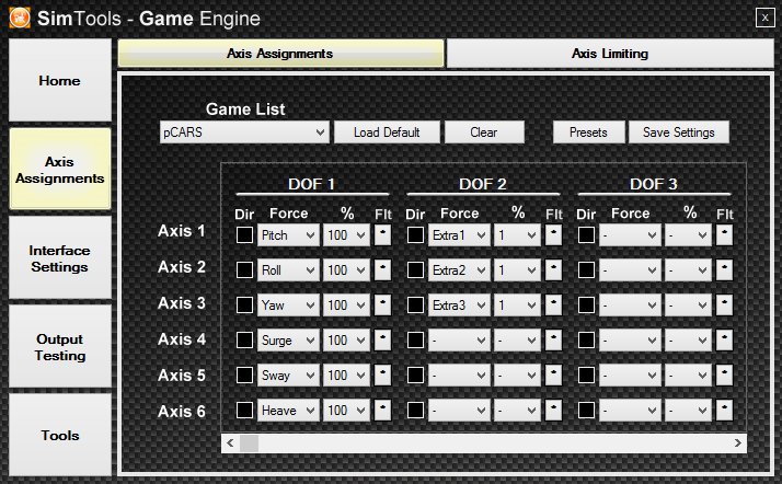

    Hello
    I have a problem with pCars my 2 dof seat mover not work and i dont know where is the problem.
    With Assetto Corsa and WRC 4 work fine.
    Greetings

  16. Ramok
    Ramok Member SimAxe Beta Tester Gold Contributor
    Mar 6, 2013
    45
    Slovenia
    1,130Coins
    +11 / 0 / -0
    Hi again
    Here is video of pCars and Assetto Corsa.
    AC works like charm no problem at all.
  17. value1
    Jan 9, 2011
    2,192
    Zug, Switzerland
    14,297Coins
    +3,363 / 13 / -1
    Hi @Ramok
    Check your axis settings for pCARS.
    Could it be that there is no force selected for all axis?
  18. Erwan960
    Erwan960 Active Member Gold Contributor
    Nov 4, 2013
    137
    3,832Coins
    +257 / 0 / -0
    Check your "Min/Max Value" file. As far as I'm concerned, I have to use this scale : 1 for 1G and not 10 for 1G.
  19. Ramok
    Mar 6, 2013
    45
    Slovenia
    1,130Coins
    +11 / 0 / -0
    @value1 @Erwan960
    Thanks for help guys.
    I put the same numbers axis settings from AC in pCars and works great.
    Greetings.
