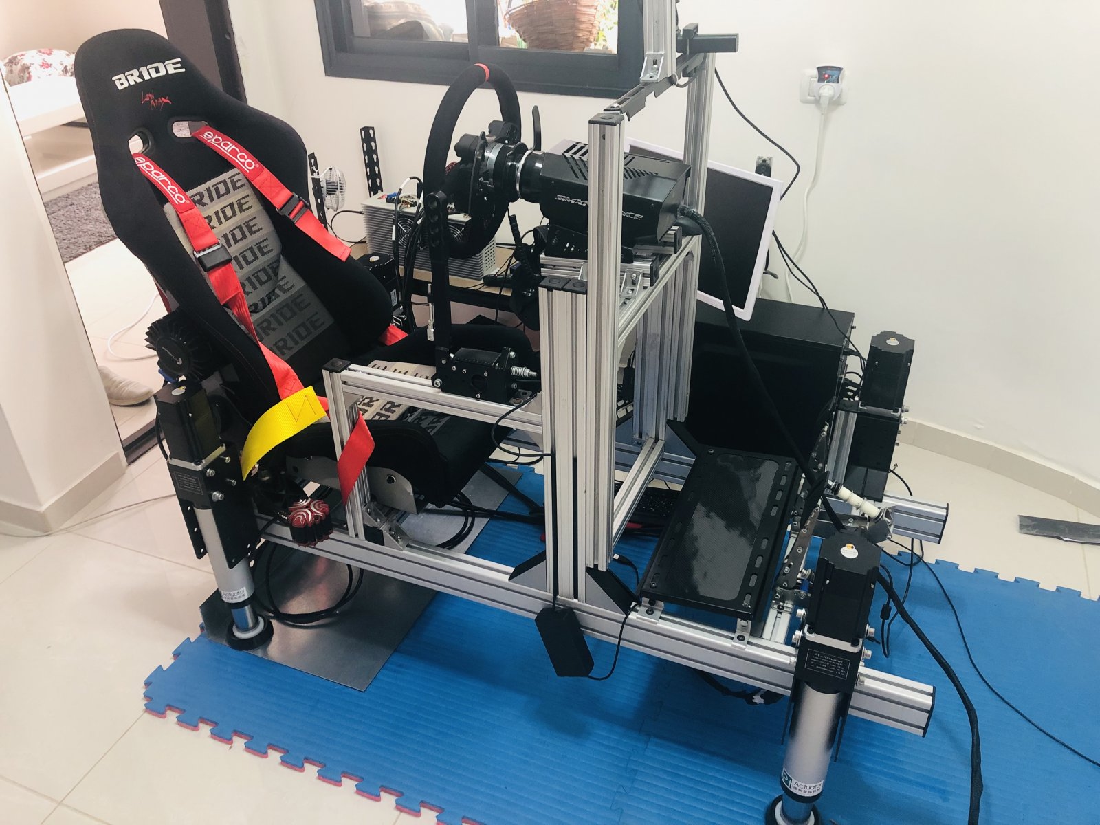

    C77A4294-D16E-45DA-8650-47203E77ABD8.jpeg I have 4 actuators like this( 4 Axis)
    I have a total of 125 ( I use only 5 DOF ) for each axis. Is it to much ?
    I saw some presets with the same system with 230 for each axis,

    You should start your own thread, and re-post your question on it.
