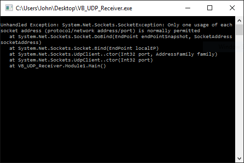

    Im on w10 and that app says a problem will close the program. [​IMG]

  9. Radioproffi
    May 15, 2014
    139
    Lviv
    1,638Coins
    +89 / 1 / -0

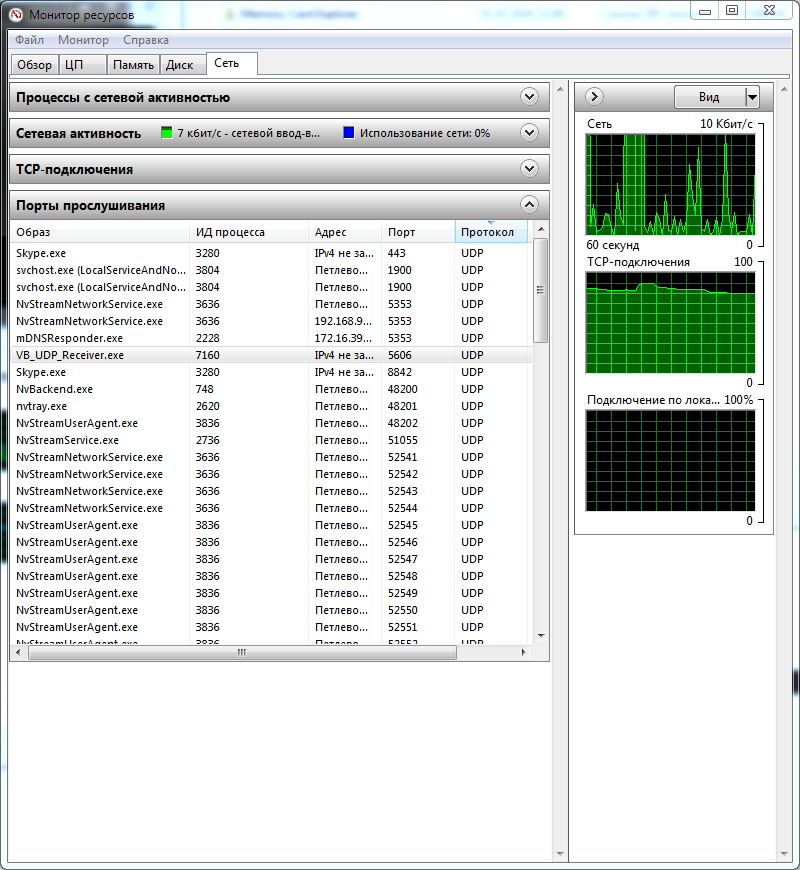

    It looks like you have closed or busy port is needed UDP - 5606

  11. Radioproffi
    May 15, 2014
    139
    Lviv
    1,638Coins
    +89 / 1 / -0
    You can check it in Task Manager
  12. SBDESIGN
    SBDESIGN some knowledge
    May 25, 2016
    56
    director
    UK
    125Coins
    +7 / 0 / -0
    2DOF, SCN5
    For some reason, after clicking this in task manager, I got a dos window displaying live values for my xbox one.
    I re-shut everything down, and rebooted the simtools engine and manager.
    And now I can see sliders move :)
    And more than that the actuators move !
    MASSIVE thank you! You guys have really helped and been patient.
