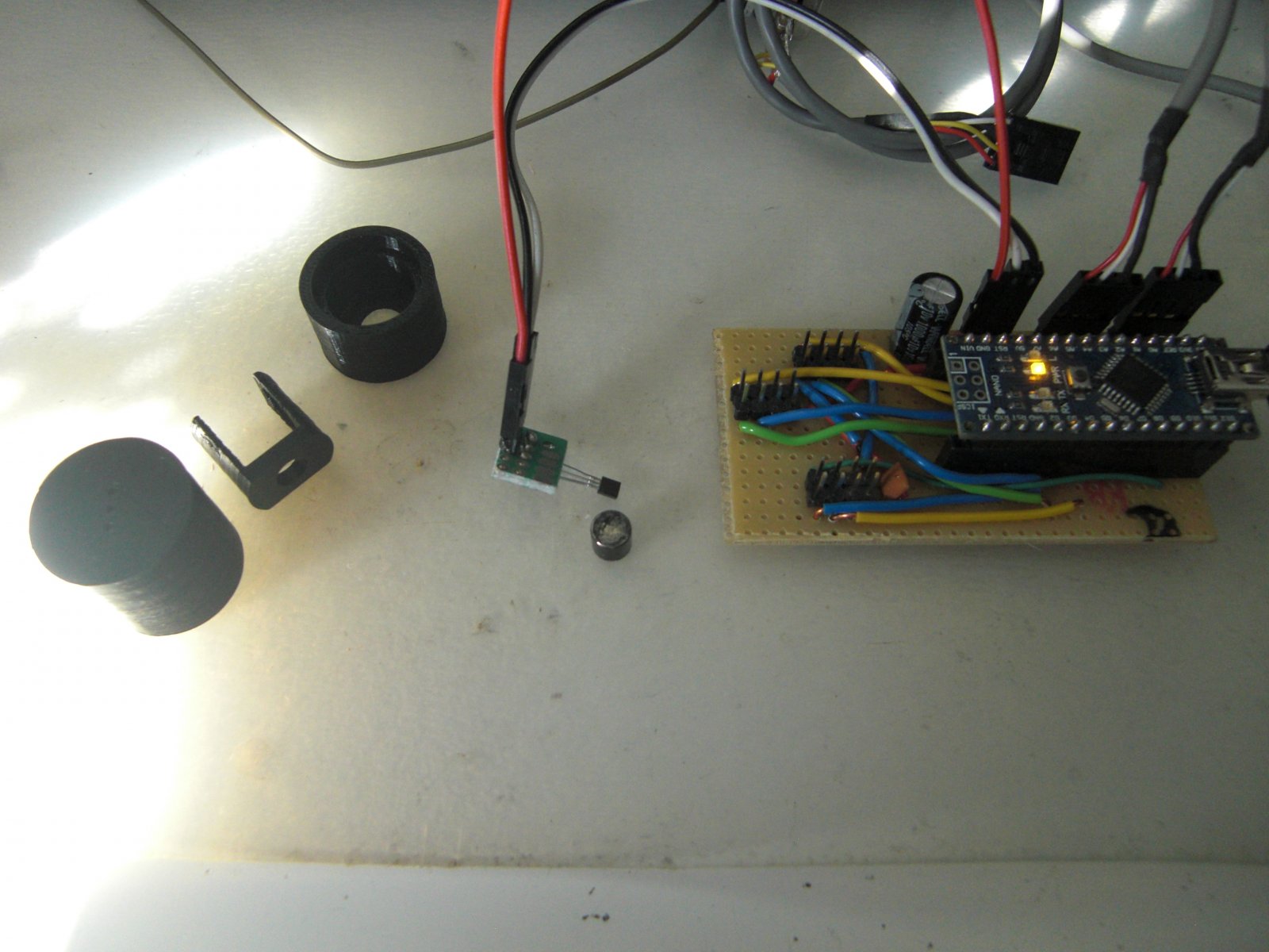

    Made a prototype with a analog hall sensor to replace the potentiometers (sensitive to wear).
    had some problems with the oscillation of the motors but I fixed that too :)

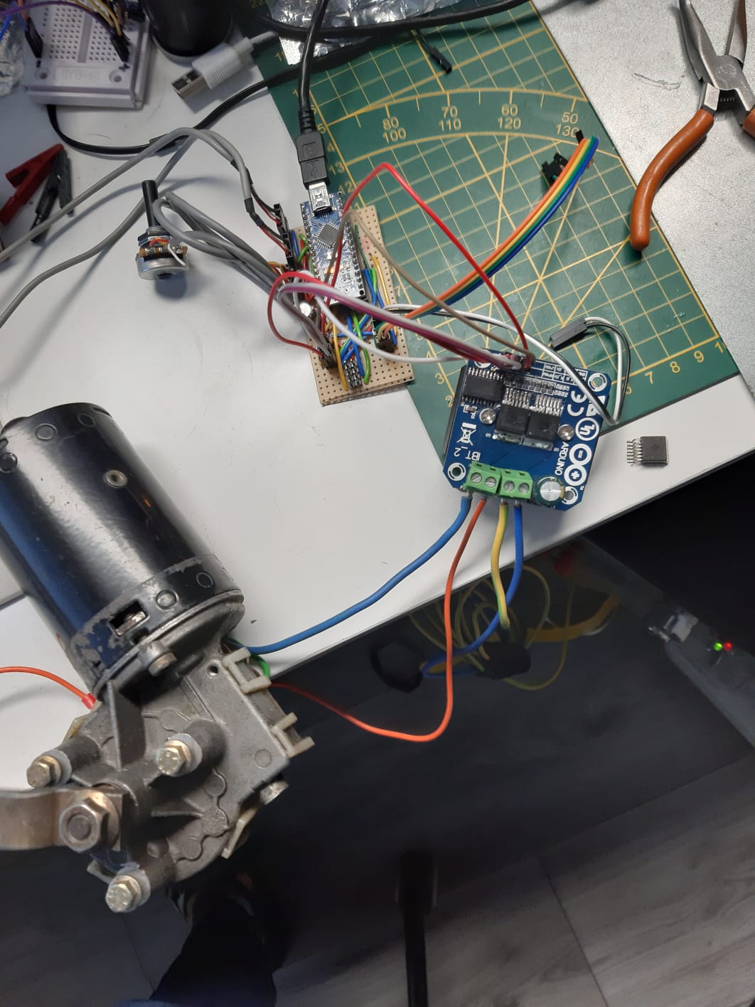

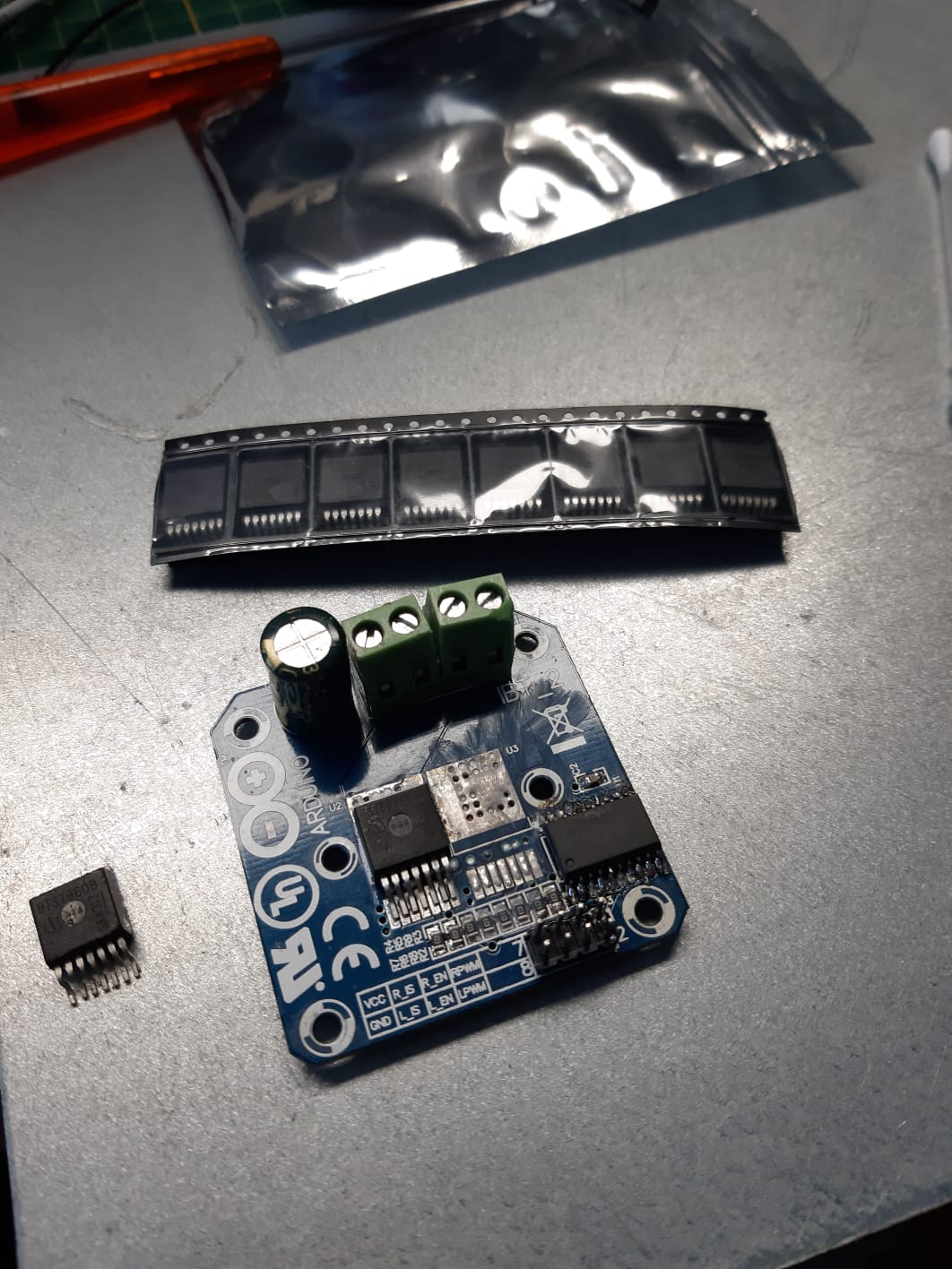

    Hmmm i blew up one of my h-bridges (IBT-2),
    so i bought some bts7960's via Aliexpress, with my smd station replaced the defective chip and now it works properly again (i'm happy again:grin)

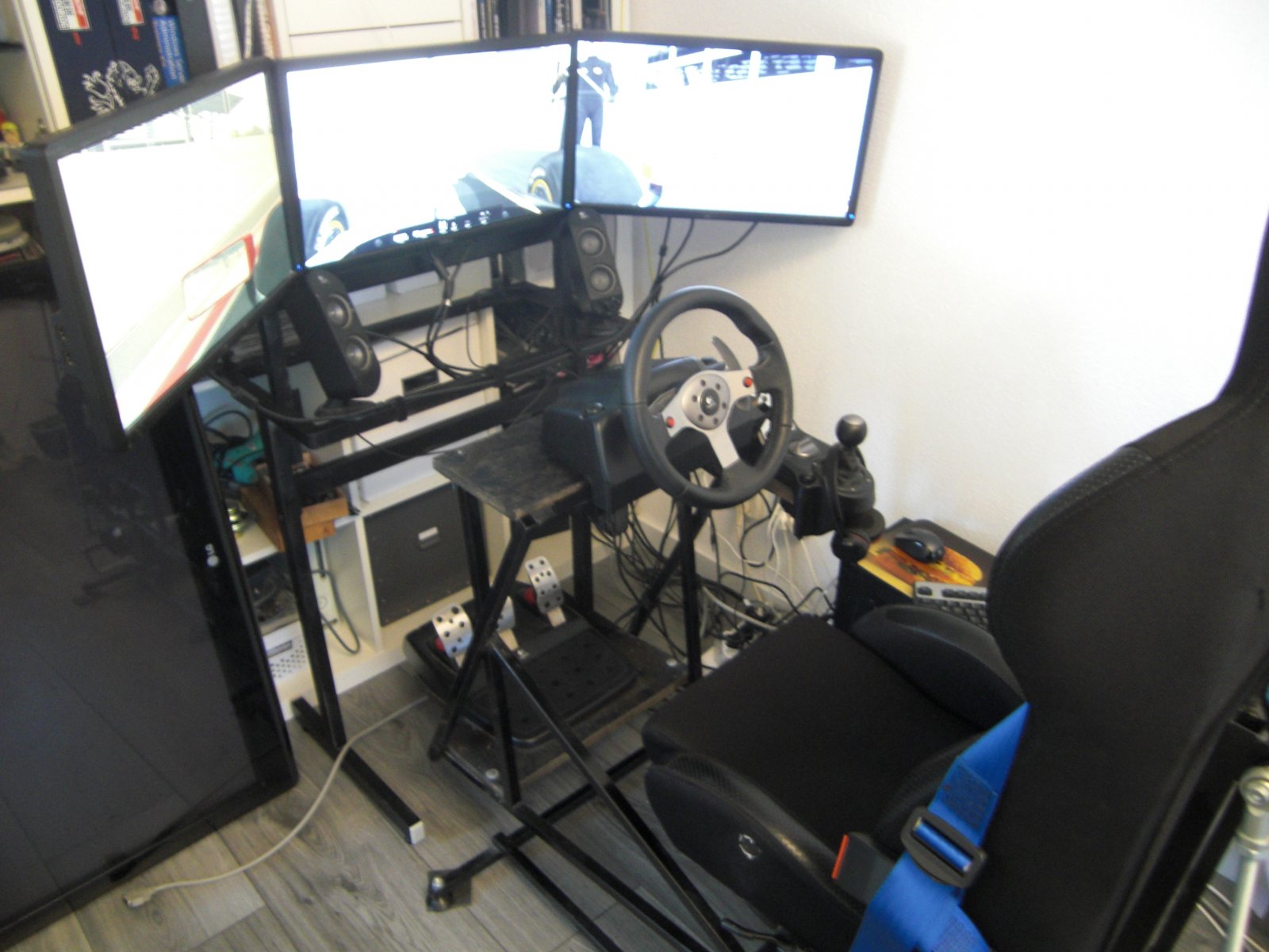

    Updated my rig, 3 x 23" screens on a bracket (made myself :))
    it give's simracing/flying a new dimension and experiance :grin
    All my friends are enjoing the sim:thumbs, it's great fun (with a couple of beers and chips)

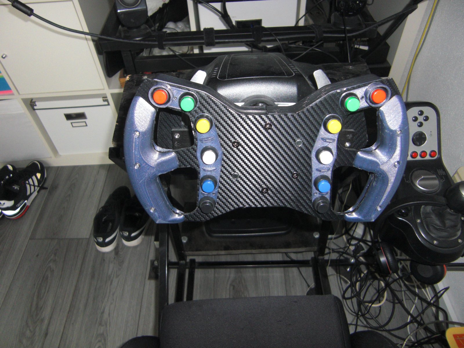

    An extension for my sim :cool:
    Okay build my own F1 steer (posted in another article)
    This is how it looks like on my Logitech G27 rig :thumbs

    A other update i always wanted to implement.
    Hall-Sensor instead of analog pots (who tends to wear out on time) :grin
    So i'm using a (cheap) 49E hall-sensor, 3D printed a housing to hold the sensor (because i want to exchange them easily)
    This is my experimental setup, so i can test it before i mount it on mij rig.:thumbs
