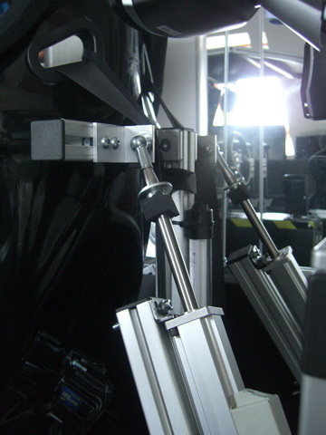

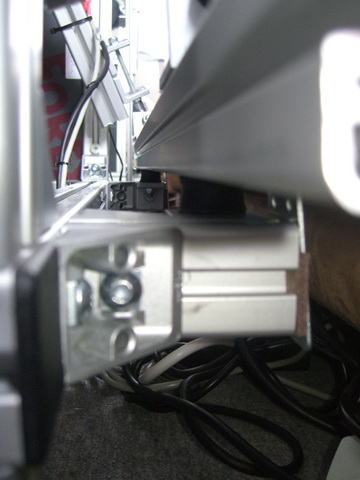

    Hi Mike,
    took a few fast shots and want to post it. I hope you can see how the things are attached.

    Hi Chris, from the photos i can see that the actuator rods are extended almost fully. Shouldn' they be at half the distance when the seat stands still?
    or it does not matter?

    You're absolutely correct: The pictures were taken directly after having installed the angle joint heads and the damper bar, just for assembling everything together. THEN resp. AFTER THAT I balanced the seat unit and mounted the upper bar (where the upper joint heads on the lift rods are fixed) approx. 4-5cm down.
    Right, they should be half way out when the seat is balanced well ! If my SCN5 initialize at profiler start, the lift rods are half way out, so everything's just fine ;) !

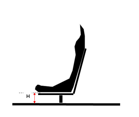

    Could you please tell which is the total distance of the driver from the ground (see attached drawing)?
    Many thanks.
    Edit: The red arrow in the sketch shows by mistake, the distance from the main base.

    Hi John,
    the distance between the seat unit and the base rig (= H in your drawing) is 20cm / 7,87 !
    The distance between the base rig and the seat (where I'm sitting on) is approx. 38cm / 14,96 !
    Hope this helps.
