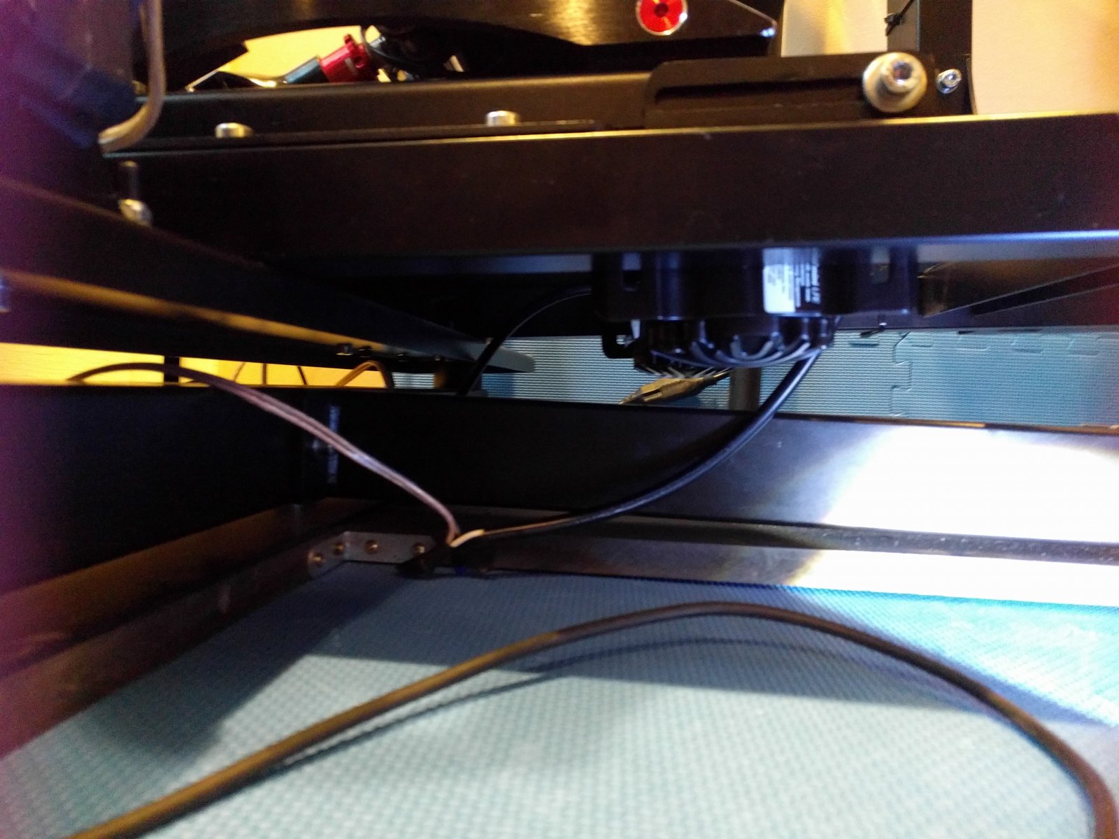

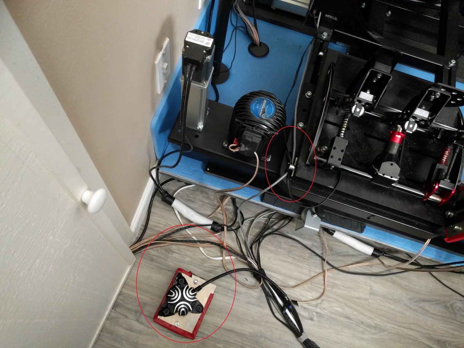

    a bit of an update on my build. So my initial "design" to mount Mini's on pedal plate raiser was a bad decision. Tiny Mini managed to break the raiser! Reminds you that nothing lasts forever.
    However, new location (under the pedal plate) is more successful, gives more sensation at a cost of a bit of locality/spatialization.
    Also, attaching my EQ APO settings for Mini (Recon 3D) and LFE (AE5)
    Lastly, attaching SimHub profile I use for rF2 and R3E (4 mini's + 4 lfe at "corners").
