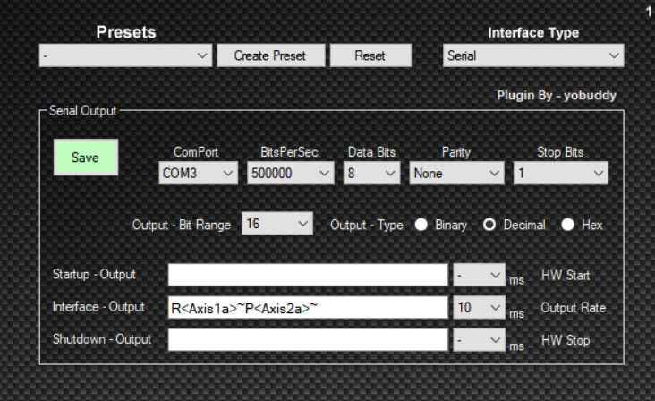

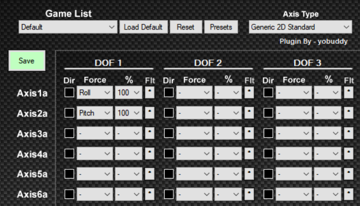

    I have just been asked by @Fabio27aigner how to interface this piece of code with Simtools, and I never realized until now that the settings I used are pretty critical to the operation. Better late than never I suppose.
    Output Type: SER
    ComPort: User specific
    BitsPerSec: 115200
    Data Bits: 8
    Parity: None
    Stop Bits: 1
    Output - Bit Range: 16
    Output - Type: Decimal
    Startup - Output:
    HW Start: - ms
    Interface - Output: P<Axis1>~R<Axis2>~
    Packet Rate: 10ms
    Shutdown - Output: P0~R0~
    HW Stop: - ms

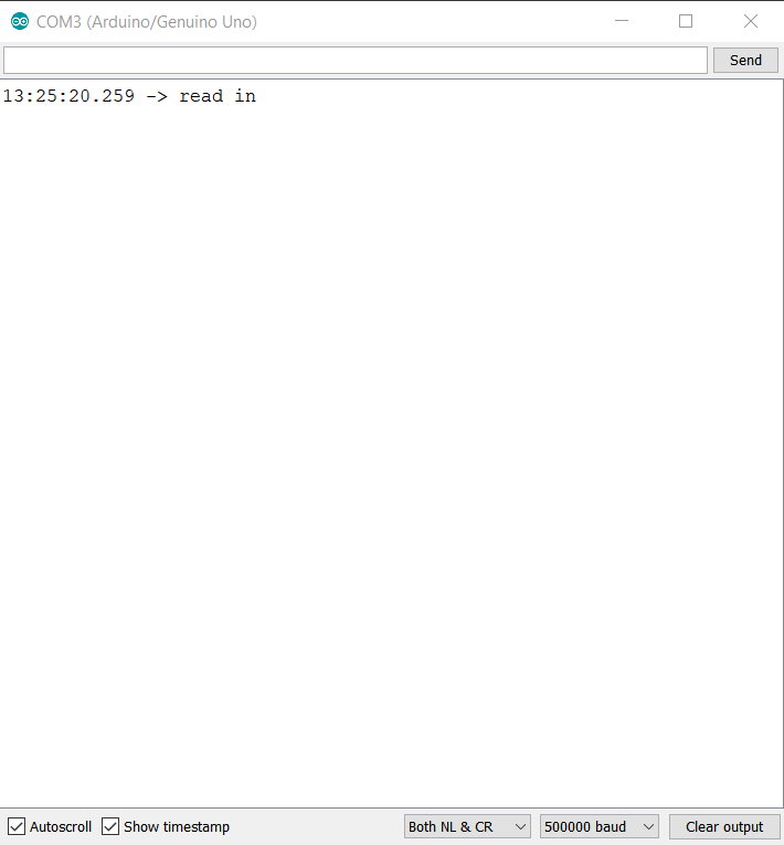

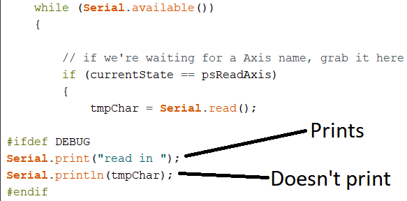

    Hi @dontcarefilmer and all, really great work here, this thread has helped me out loads with my project. Thank you so much.
    However, I am at a sticking point and not sure what else to try. I am unable to read serial data from Simtools on my Arduino.
    I have followed this thread and a few others closely, but still no luck.
    Interface settings:
    I have tried:
    • 9600, 115200, 500000 bps (and updated Arduino code and serial monitor accordingly, also the COM3 settings in windows)
    • 8, 10, 16 bit range
    • binary, decimal, hex output
    Axis Assignments:

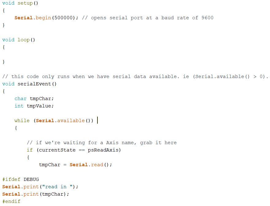

    Arduino code from here:
    https://www.xsimulator.net/community/marketplace/communicating-with-an-arduino-and-sim-tools.97/
    Have only updated:
    Serial.begin(500000);
    according to which bps I was testing.

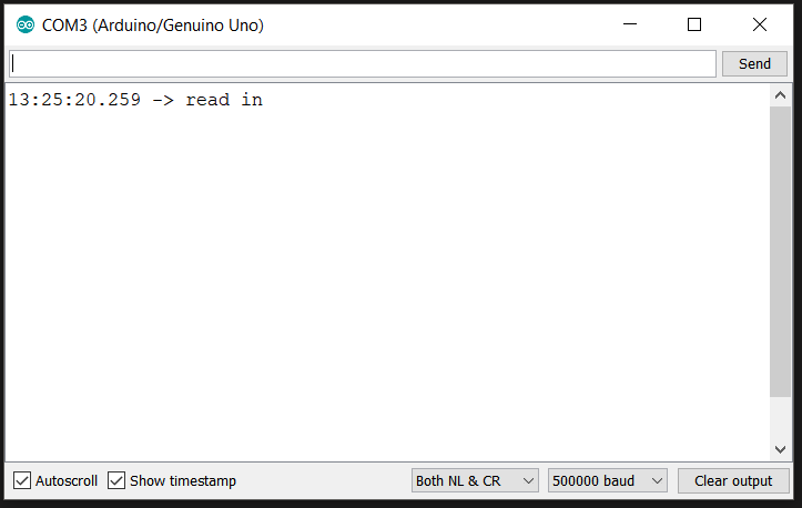

    Serial Monitor output:
    It's been some years since I have done any programming, but it seems like tmpChar must not have been given a char from the serial read.
    I have tried sending output through Output Testing, and also running games that are working and can read game data in the Tuning Center.
    Thanks in advance for your help! I'll go brush up on Arduinos and coding in the meantime. Sorry for the length.

    Hi @IndependentEngineering, thanks for taking interest in this project. It's been a while since I worked on this particular piece of code, but I've got some ideas that you may be able to test out. A couple of questions first:
    Are you trying to connect both the Serial monitor and SimTools to the arduino at the same time?

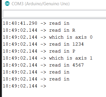

    Have you tried using just the Serial monitor to manually enter in some values that you would expect SimTools to generate (eg. "R1234~P5678~")?
    You are only able to connect a single application to a Serial device at a time, either arduino IDE or SimTools (or RealTerm if you want to get closer to the hardware level). I can't recall how SimTools responds to debug feedback via Serial, so I'm not sure what the outcome there would be.
    Most of my testing was done via the Serial monitor and hand typed values. Later on as this project grew I started using an interface I wrote in "Processing" to handle the communications as this didn't require my direct input for every movement. The arduino should respond in the correct way when using hand written commands, albeit not in real time compared to SimTools. It will allow much for simpler debugging. Once you are confident that your code functions as expected, then connect it to SimTools for further testing.
    Additionally I would recommend capping the upper speed of your Serial connection to the arduino at 115200. From what I understand, the arduino may be able to achieve higher speeds, but at the cost of greater packet loss. Re-transmitting those lost packets may end up bringing the actual speed much lower than you expect. A baud rate of 115200 is still pretty quick, especially for the small amount of information you need to transmit.
    Good luck.

    Thanks for the super quick feedback @dontcarefilmer!
    And thanks for the pro tip about sending the Arduino inputs from the serial monitor, I honestly didn't even know that could be done, this is my first real Arduino project. :)
    The output was as expected:
    Hmm, I was hoping to read the serial data in serial monitor live based on game data output. Bummer. But looks like RealTerm could possibly help out with this. Thanks for the tip!
