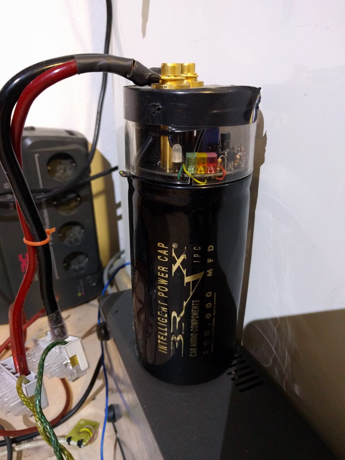

    2DOF, 3DOF, DC motor, Arduino
    I had the same problem with my DD steering wheel, the engine shut off the PSU, solved with 0.5 Farad condenser for Car use.
    BRAX intellicap condenser with automatic charge and discharge, connected near H bridge

    no, the condenser must be connected in parallel to the terminals of the power supply unit.Attention! the device when charged with very high discharge currents. or use a condenser equipped with automatic head for start and shutdown, or use a 10-20ohm resistor to charge it at each power supply start. also an automated system with a 10 seconds timer and a 30 + 30A tip doping relay.

    this is the device in the picture. without him in support, even my big 40A bench power supply goes into protection as soon as I turn the steering wheel abruptly. while with the connected condenser it turns on to the overload warning light but does not go into protection
