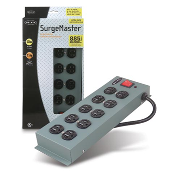

    I'm looking at an enclosure for the servo motor drivers.
    I plan to use a 6U server enclosure and add a surge protector inside:
    Most USA residential electrical circuits are 15A so most multi-outlet power bars with surge protection are 15A.
    But there are (in my case) 3x servo motor drivers, rated for 15A so will a 15A unit be enough.
    My home has 20A circuits for the outlets so there are 20A option but hoping someone can chime in here.
    I'm guessing the 15A will be sufficient as that's what most homes will have wired for their power outlets?

    Furman makes 20A rack-mount power conditioner/strip units but they aren't cheap. For example the "PL-PRO C 20A" has eight 20A outlets on the back (and a 15A on the front), but costs around $300.

    Thanks for this. I don't need a $300 unit, I just wanted to make sure that the option I chose is fine for the job.
    I would imagine that most use a regular power strip and plug their servo motor control boxes into that, and then the power strip into a regular home wall receptacle.
    The alternative is to start ripping out sheet rock walls to wire entirely new circuits in their homes, which would likely need a dedicated sub panel supplying say 30A to just that one receptacle.
    I'm not reading about people doing that.
    US homes are 99.99% 15A on receptacle outlets, so I just want to go a step above a regular power strip that most will use.
    Unless of course you can tell me that most people will buy something like this?

    BTW I just looked up that CyberPower strip you pictured and Amazon has 20A versions for $56-$66: models CPS1220RM and CPS1220RMS.
    The CyberPower site lists several more 20A models but most have additional features and a higher price.
    Another option would be to build your own, though it probably wouldn't be any cheaper. As a starting point, Belkin has a 10-outlet 15A power strip with a metal enclosure (not rack-mount) for $35. The enclosure uses normal outlets, so you could pretty easily replace the guts with 20A components and wiring:

    Thanks!
    I ended up buying the Tripp light model instead, but it's 15A with 3000 joules surge protection and EMI/RFI filtering.
    Should I return it and get the 20A version and then upgrade my wall outlet to Nema 5-20R?
    UPDATE:
    After seeing Thanos's reply in my new thread about power, I cancelled the Tripp Lite 15A and bought the best Cyberpower 20A option from Amazon and a Nema 5-20R wall outlet since my circuit is on 20A.
    amazon.com/gp/product/B00077IS32
    Thanos felt it would be very rare to use full 15A, so I figured that since I had the Simucube too, I may as well get a power strip/surge protector that can use the full 20A available on the circuit if ever needed.
    My Sub panel is brand new (basement remodel) and has ACPI breakers on every circuit which are much safer than the old style breakers.
    Thanks again for your input
