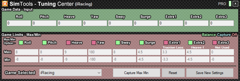

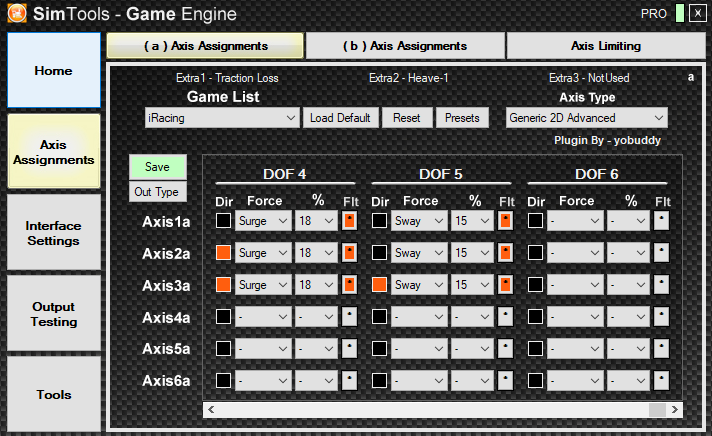

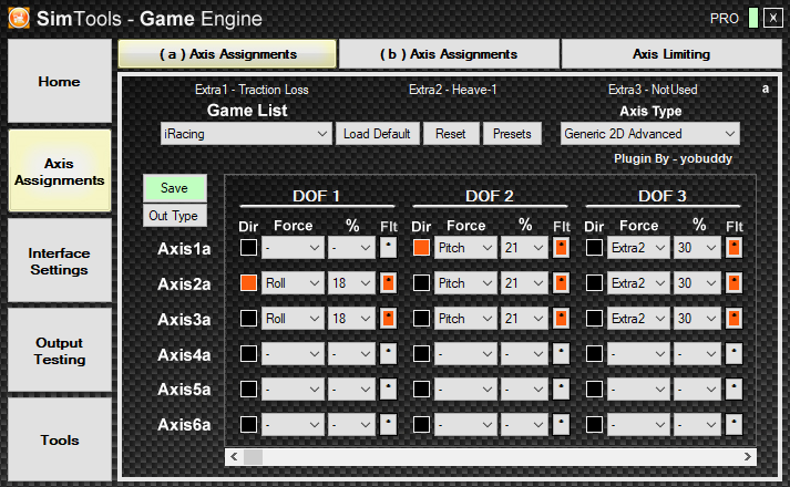

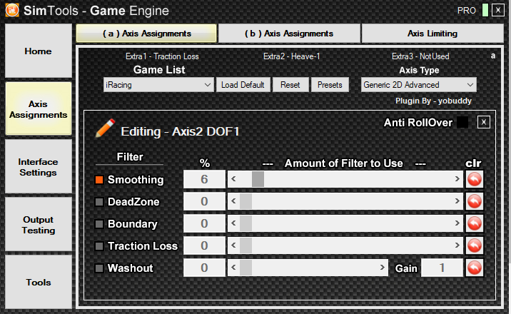

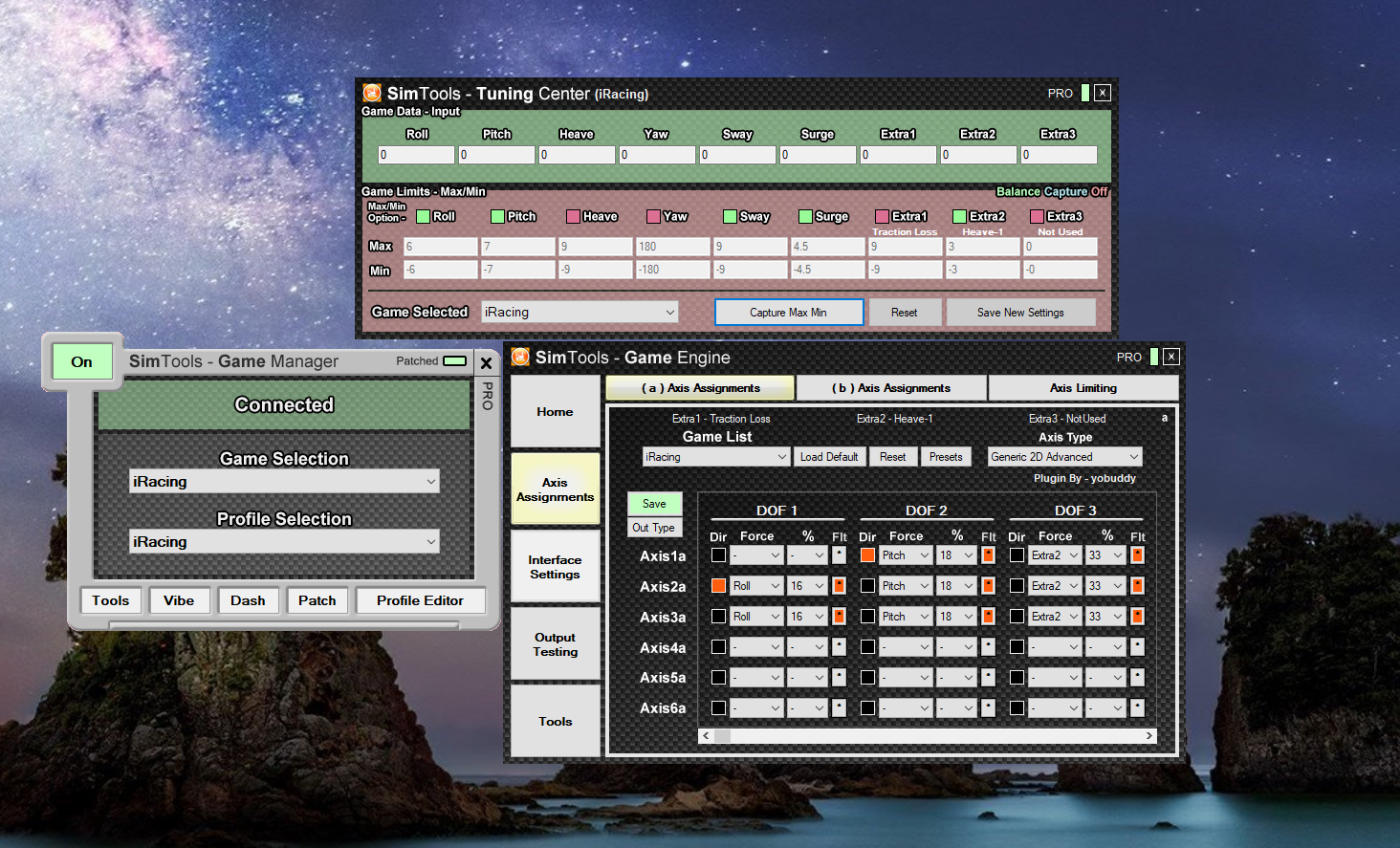

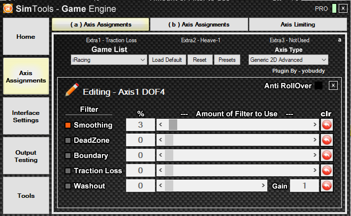

    Posting my settings with PT Mega Monster 3x150mm Actuators mounted in tripod format - 1 actuator in the front center of my P1 chassis, the other 2 actuators on each side of my racing seat, as far back as possible on each side piece of extrusion.
    These are for iRacing after playing around with things for a bit over a month now with lots of helpful advice from many other users.
    It should be noted that SFX1000 (100mm) actuator settings may not feel ideal on these PT units - ZeroNilZero (Tim) has been extremely helpful in offering ideas and settings, but ultimately they created a very violently moving rig despite efforts to mitigate. Nonetheless, learned a lot throughout this process and Tim really knows his stuff when it comes to understanding how all the effects fit together.
    But there is no one size fits all, even if you had the same equipment as everyone as different goals for what they want to feel.
    Driving mostly GT/GTLM and formula cars, my goals were to have a very 'tight' and 'informative' motion system, offering motion cues based on iRacing's laser scanned track data that added more useful information to my driving experience, instead of feeling like I was driving a John Deere tractor over a rocky beach.
    Nothing exaggerated or distracting, which for me is what I wanted as a tool that helped me hone my driving skills rather than create a bouncy castle experience that is fun, but wasn't helping me become a faster driver.
    I played with a range of DOF values and filters, then looked at tuning center values to increase/decrease intensity of motion cues.
    The best piece of advice I've had is to only have one DOF at a time and drive the car until you feel it's right, adjusting values and filters and Tuning Center then turn that one off and try out another. I would keep all Tuning Center values to 9 and -9 to start, then go down as you feel is needed after you have everything feeling natural to you.
    Do this until you feel all the values feel right to you, then try running roll, pitch and heave together and see how they all feel together. Then try surge, sway and TL if you want to simulate TL (I didn't find any value in trying to simulate this without an actual TL system so turned TL off).
    With only 3 actuators, I found that too much sway can really create a very odd experience that caused me to make more mistakes as I was getting motion cues that suggested the car was 'drifting' more than it actually was, and caused me to make larger correction inputs than was needed.|
    Pitch is also something that can feel very odd with too much value, for me it created a 'rocking horse' sensation when going through very fast sections of track with larger undulations that just felt wrong. I might even go lower than the values I use currently - maybe try 18 or 15.
    Surge is cool, but too much is not very realistic if you don't have a dedicated surge platform. Too much and when you accelerate, it feels like you are engaging hyperdrive and the steering wheel moves away from you as if your arms are stretching. On braking you move forwards and up, which can be off-putting with too much values here too. This is a trial and error thing and ultimately I prefer to have this as a subtle cue until I add a surge platform.
    I race 100% in VR, so perhaps this is more accentuated than those driving on monitors so YMMV.
    Roll is a setting that you want to keep low - thanks to Mike Jeffries for this one. Much of the violent motion you will experience during a collision is related to roll, so be sparing on this.
    Another useful tip from Mike Jeffries was to use the 'Extra2-Heave-1' parameter instead of 'Heave' as the former does NOT have gravity, unlike 'Heave'. There's a big difference between the two and when I first tried using just 'Heave', it was not a nice feeling when you felt like the car was sinking into the track surface. Recommend you don't use 'Heave' and instead use 'Extra2-Heave-1'.
    But these will only serve as a guide, everyone wants different things from their motion rig, so ultimately you will end up tweaking things to your liking.
    Good luck!

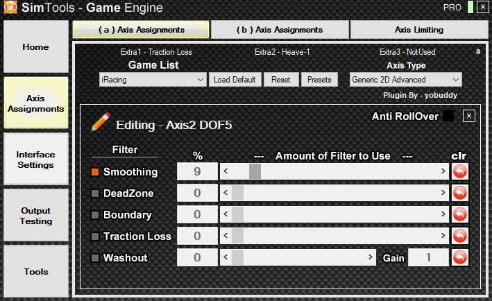

    Attached Images of filter values (all filter values the same for each axis within that DOF column) can be easily linked to the DOF #:

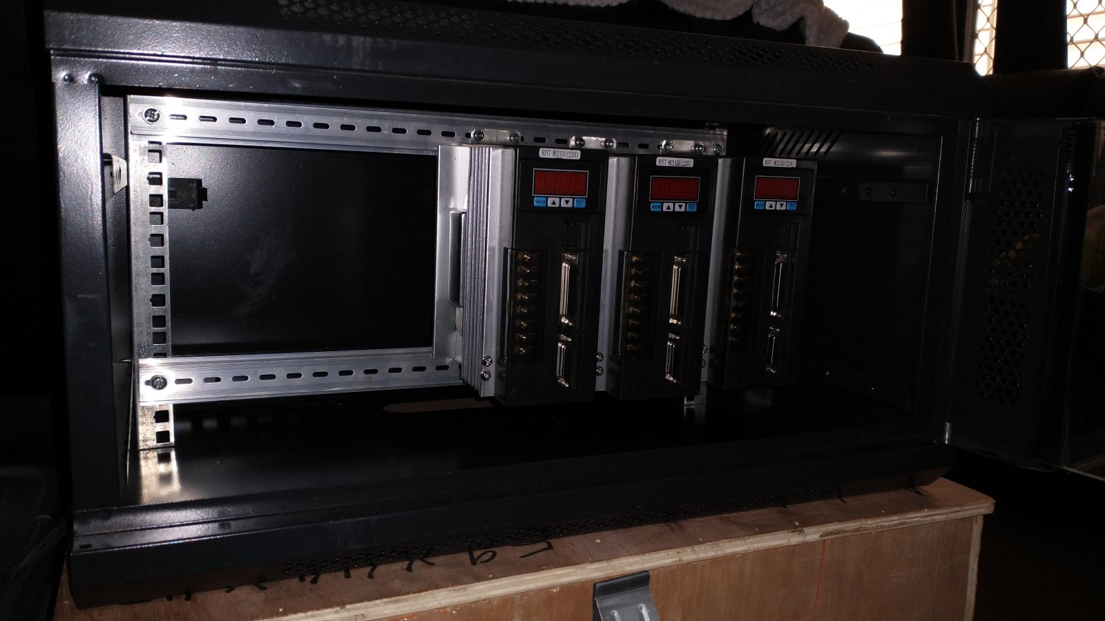

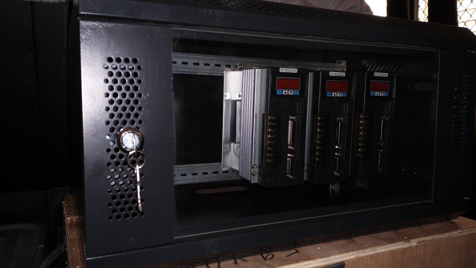

    @Globespy - Wow, that is awesome mate ! So much really helpful info in your post ... I received my PT Monster kit but still waiting on my Trakracer TR160, latest is that the shipment lands around 15th and has to pass customs and then get sorted and sent out in the days following.
    The PT actuators look really beefy, very impressive and the black powder coating rocks ! :D
    Shao mounted the servo drives in the control housing for me ... btw that is very nicely made and glad I got it. All I am missing is an Australian power plug as he didn't have any but I can pick one up easy.
    Do I need a dedicated surge control just for the servo and controller ?

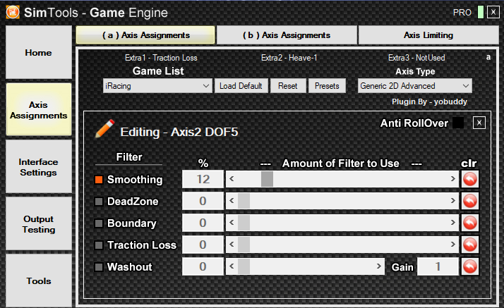

    New Set of Values for iRacing - this feels better to me, feedback is lively but informative.
    Tested on V8 Supercars, GT3, GTE, GT1, Riley Proto.
    Filter values are the same for each DOF - I just showed one from each - so Roll, Pitch, Extra-Heave-1, Surge and Sway.
    Of course it's all subjective but thought I'd share anyway.

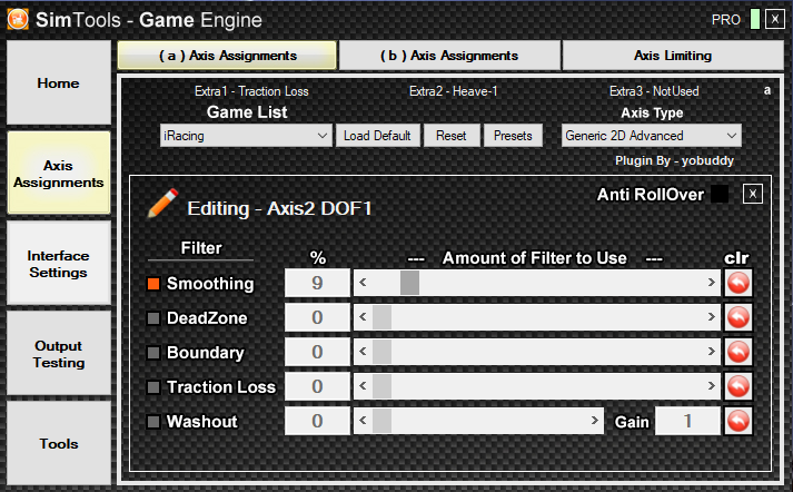

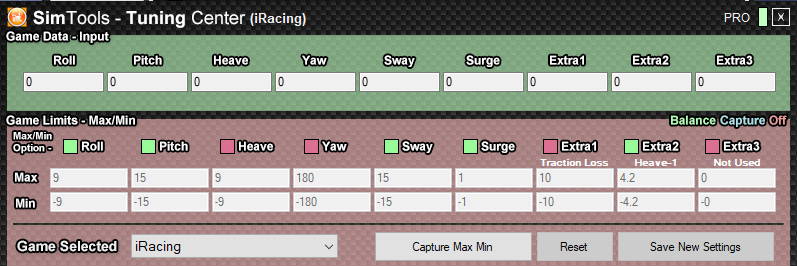

    I have made a few slight tweaks to you settings, thought I would share - I removed filters from some DOF.
    Capture.PNG Capture2.PNG Extra1-Heave-Filter.PNG RollFilter.PNG SwayFilter.PNG TuningCenter.PNG
