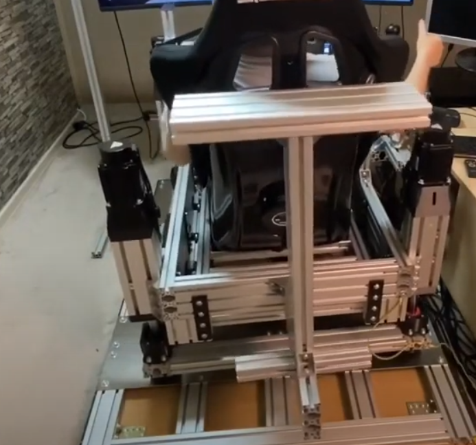

    You don't want to have captive feet on SFX-100. These actuators are only push type. If you try to pull the rod, the actuators will gladly hand it to you as nothing is holding holding them in place.

    Thanks Thanos, I thought maybe "captive" feet were what this guy has on his rig? Or something else? upload_2020-9-24_11-54-4.png

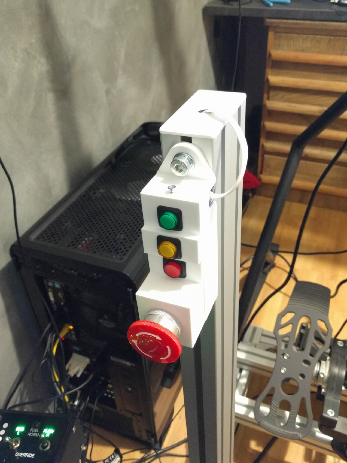

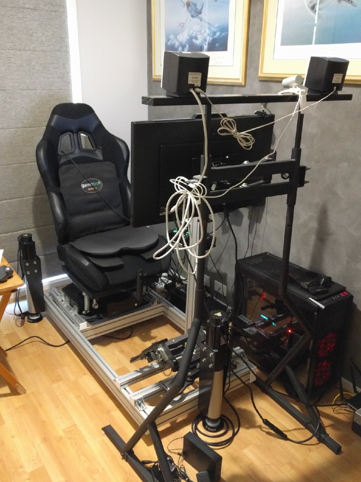

    So I have cleaned up my rig somewhat, better cable management in that the actuator data and power cables are distanced form each other, and I built myself a stop switch using @Bajer 's fantastic efforts as inspiration. Quick Q for those in the know, would I be better served for pitch by having one single actuator fitted at the rear (and thereby closer to my seat) or would there not be much difference? i am using my current setup to share weight load between two actuators. I'm using a Rift S and there have been no EMI issues. 20200926_120814_1280x720.jpg 20200926_120841_1280x720.jpg

  21. Zippo246
    Zippo246 Member
    Nov 12, 2017
    38
    Sydney, Australia
    158Coins
    +21 / 0 / -0
    3DOF, Motion platform
    Hi Blanes, the queries you bring up are the reason I went with a single actuator at front, rather than rear: so the rear two could share the weight load due to the weight distribution imbalance that is present with 3 actuator config's.
