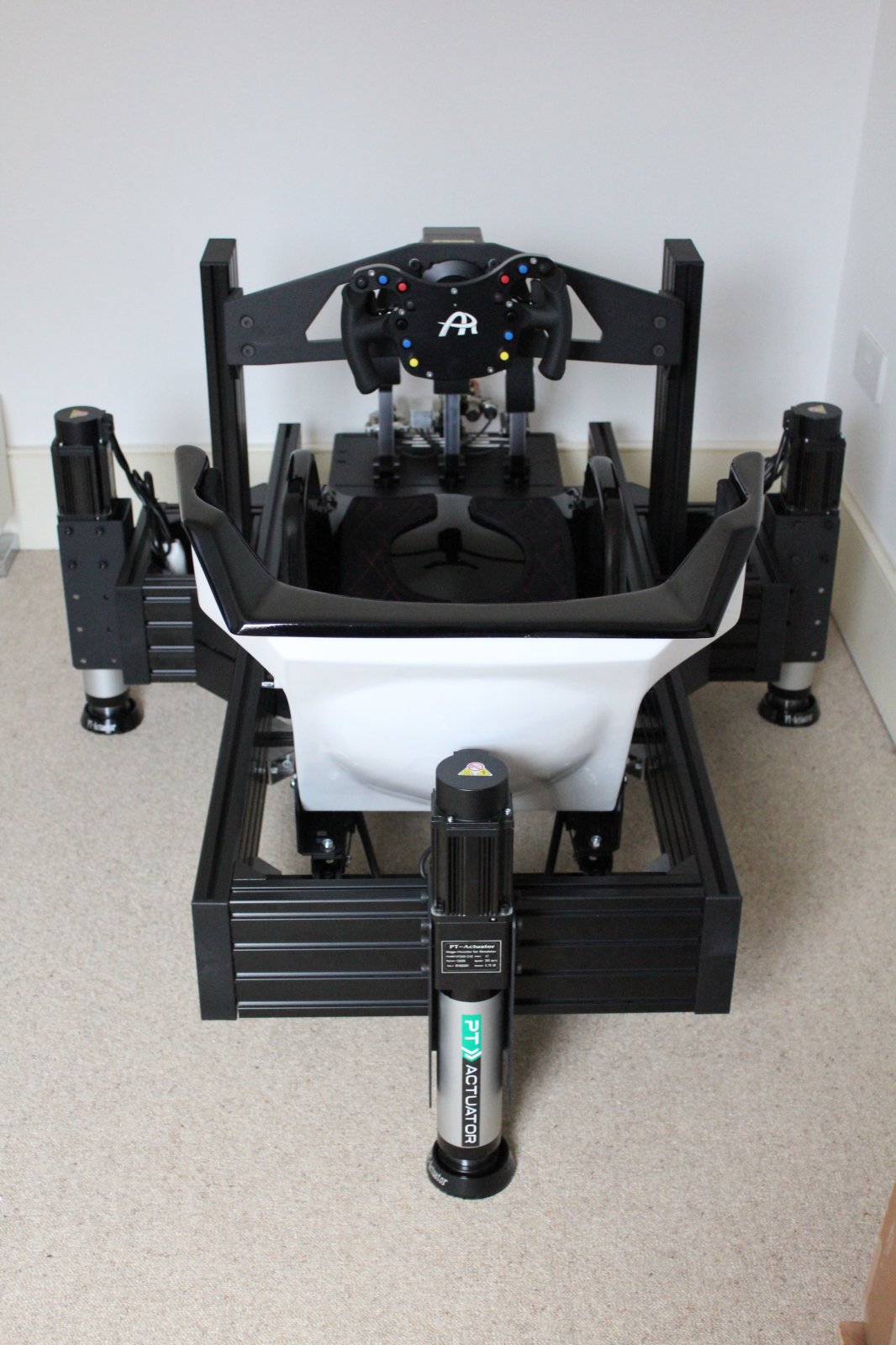

    Just finished the mechanical portion of my 3DoF / 3 x PTActuator + P1X build.
    Having 3 actuators, I took the advice of noorbeast and focused on weight distribution and CoG. As a result I bought some additional cut 16040 profile and 8080 brackets from SimLab (who have been amazing TBH).
    Though it does increase the footprint - the 'side pods' have allowed an equilateral actuator triangle to be created (110cm) . The weight at each actuator is within 2Kg when seated (I'm 80kg). Frankly I'm amazed at how stable it is.
    Looking forward to the tuning now.

    Stupid question maybe, could you help me understand what you mean by mimic wheel placment?
    21,666
    151,650Coins
    +11,045 / 56 / -2
    An actuator is located on each corner, as the wheels of a car are.
    The downside of that, during very fast actuator movement, is that it is possible for one actuator to lose contact with the ground, which effectively is a loss of control from a motion simulation management perspective.

    A triangular base needs to be big enough to provide stability.
    Do you mean yaw or traction loss, as they are 2 different forces?
