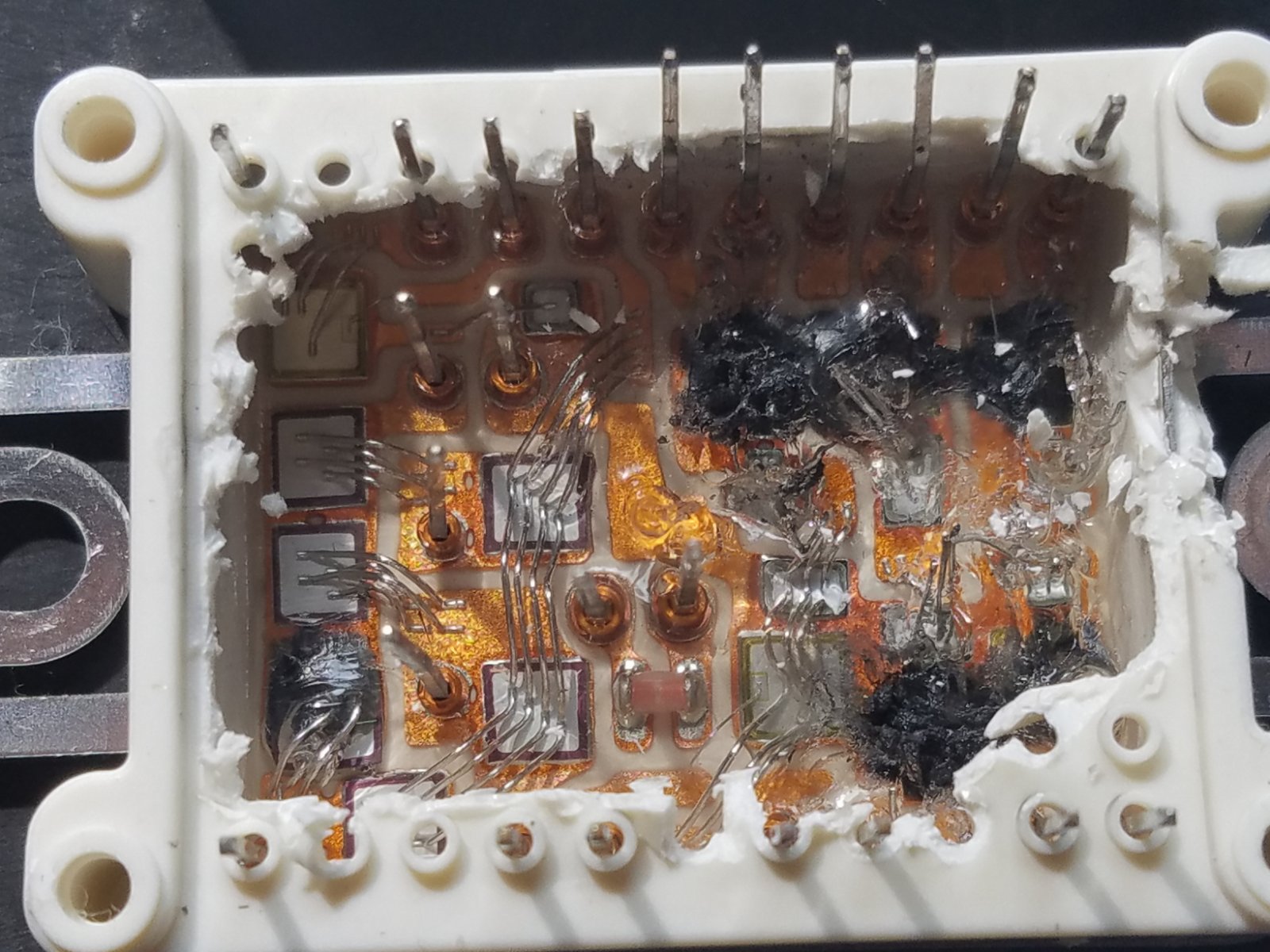

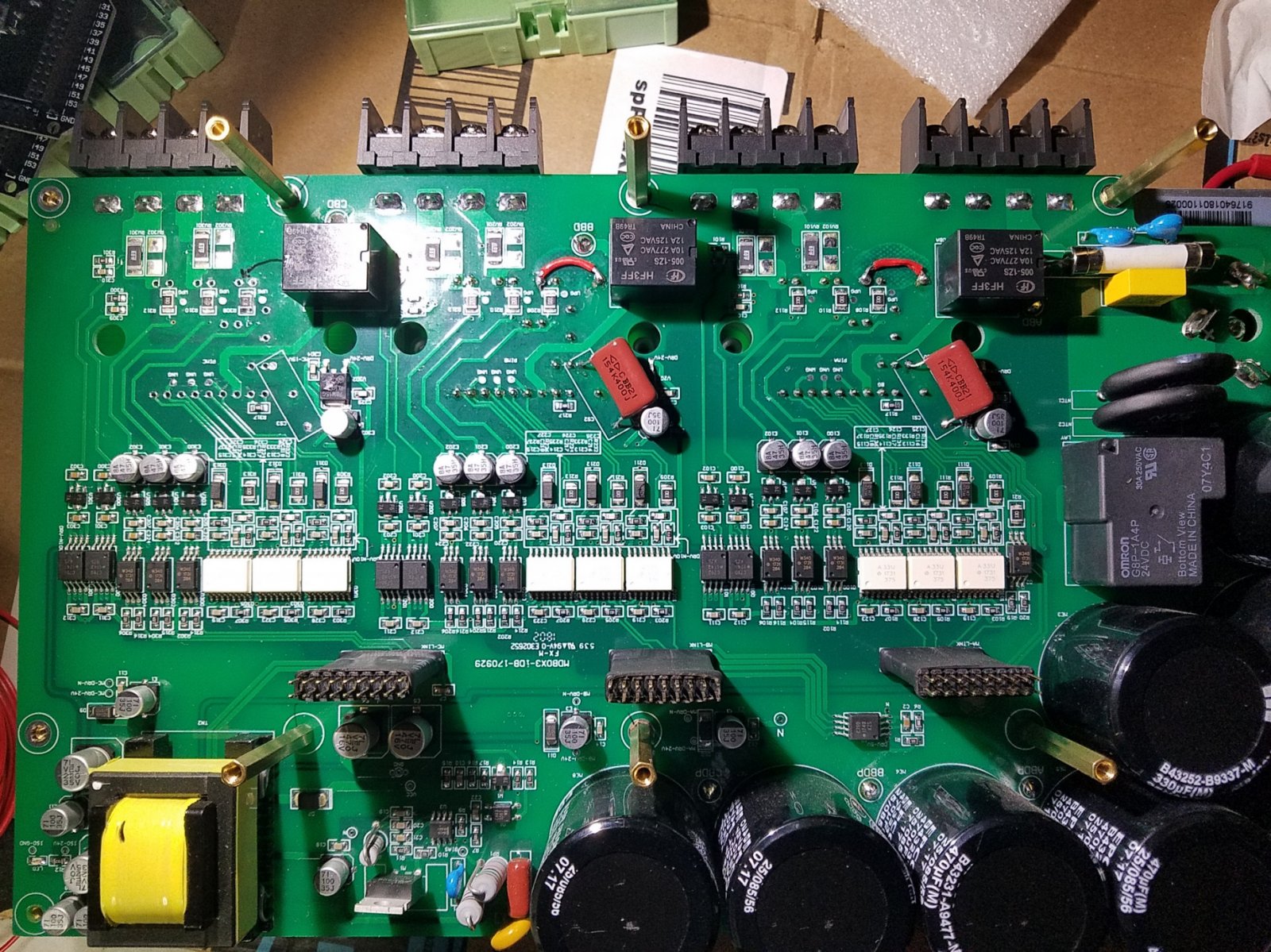

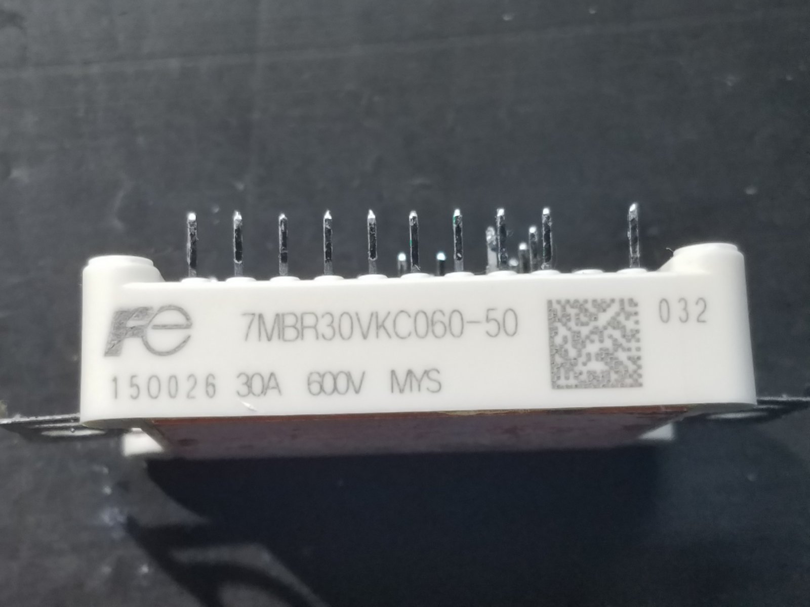

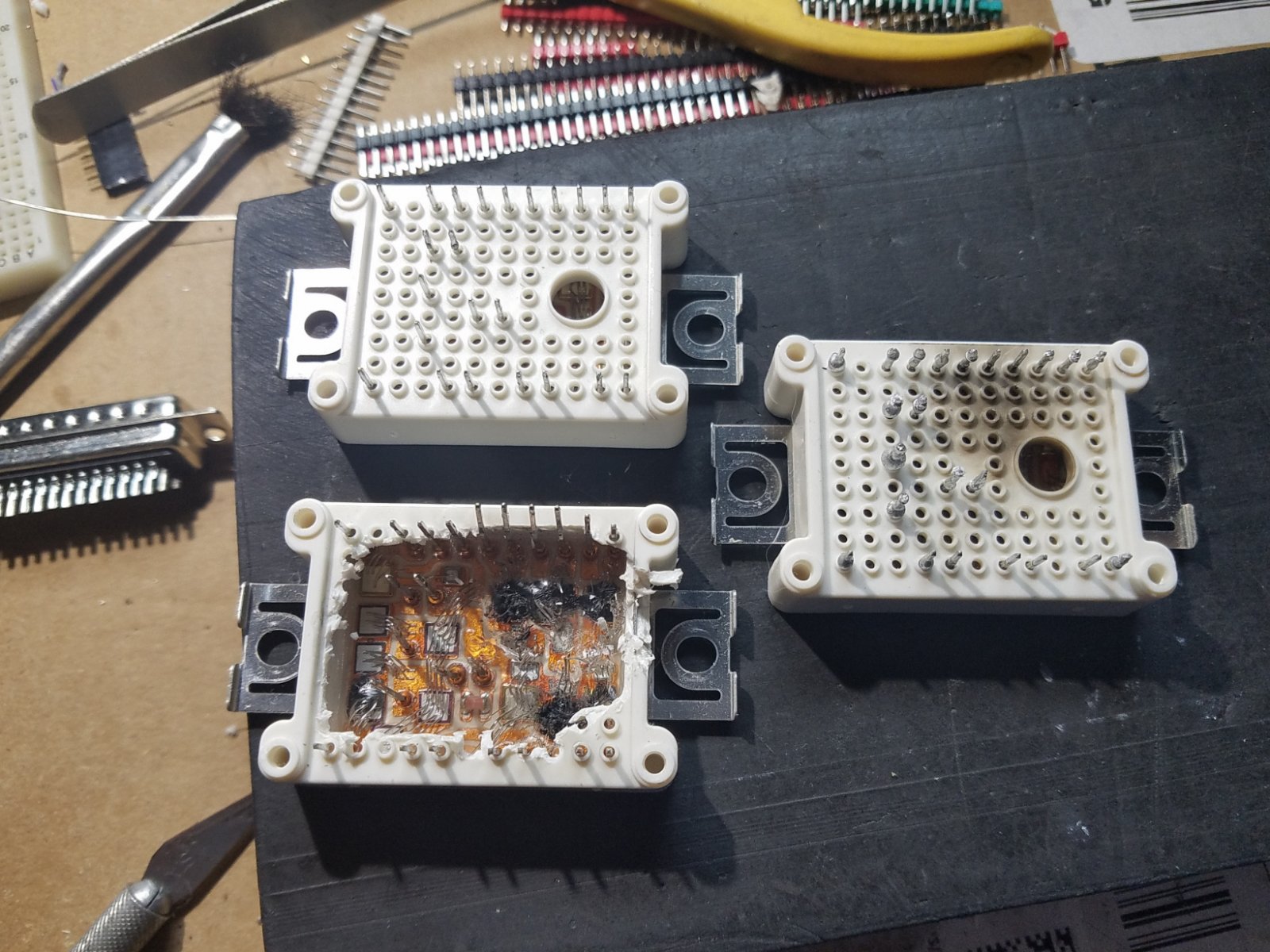

    Hi, the IGBT part is this big white part with the many through hole pins:
    As you can see on the board I also had to replace some high voltage capacitors ( red part) and add a few pieces red wire to replace the burried traces that were burned out as well...
    Like I said, it's not simple repair unless you are electronics engineer. You need to trace surrounding parts to make sure the IGBT failure didn't bring them down as well.

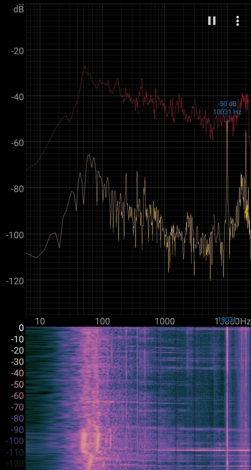

    I don't have any of the new PLUS drivers to check DB levels, but here is a screenshot of measuring the 10khz from the old drivers:

    From your picture above thats a big old 10KHz spike but also stuff above! It sounds like the new drives would be a big improvement on the noise front as our ears are less sensitive up there. The older drives are not terrible though neither are they silent.
