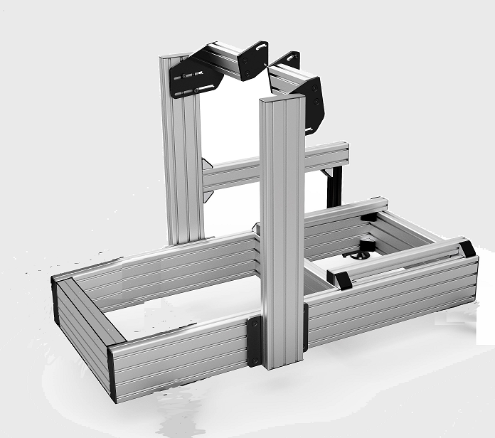

    Maybe another option for you... I've just been speaking with Simlab and they're happy to customise a P1-X for me with a front cross beam. This is what I'm leaning towards, with 2 actuators at the rear corners and 1 at the the front in the middle.

    In terms of the clearance issue I measured my current setup from the the front point of the pedal deck to the rear point of the seat mount rail. It came to 120cm so I'm fairly comfortable I'll be able to mount my seat in a normal position without the pedals needing to overlap the front of the frame. The Simlab frames are 140cm long.
    I was also looking at GT1 EVO for the same reasons as you mention. It'll be lighter and allow actuators to perform better. However, it's also less rigid both in terms of mounting the actuators and the wheel deck. Maybe you can do some modifications yourself to beef it up slightly where needed, and have benefit of all the saved weight elsewhere. I think either rig would work fine though, it's just trying to decide what is most important and what you're willing to compromise on.
    For adding the front cross beam to the GT1 Evo I'm sure they would do that for you. There were happy to help when I asked. The piece you need is exactly the same as they provide for the rear cross beam, so there's nothing special they have to cut for you, just provide two of them instead of one. The other option is to just order some aluminium profile from eBay and modify things yourself. That's the beauty of having an 8020 rig :)

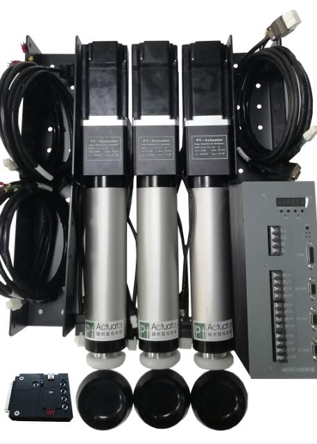

    And the photo seems to show all that is necessary ;
    Can someone confirm if there is something missing in this kit? Controller!?!
    I am very interested and would like to have an idea of the total cost for a Plug & Play product.

    This photo shows the more expensive version with Nano controller (not sure how much)
    But you can request the same with AASD-15 Servos and includes a AMC-AASD15A controller in the value and still cost less:
    3 Mega-Monster Actuator which mounted perpendicular
    1 set of AMC-AASD15A controller (up to 6DOF)
    3 set of AASD15A servo driver (flange size 80 with 750w)
    3 set of floor contact cups
    3 set of servo actuators ( speed:250mm/s,force:150kg,stroke/150mm)
    3 set of U brackets
    3 set of power and encoder cables (3meters long)
    Shipping by express to final destination ,3,199USD

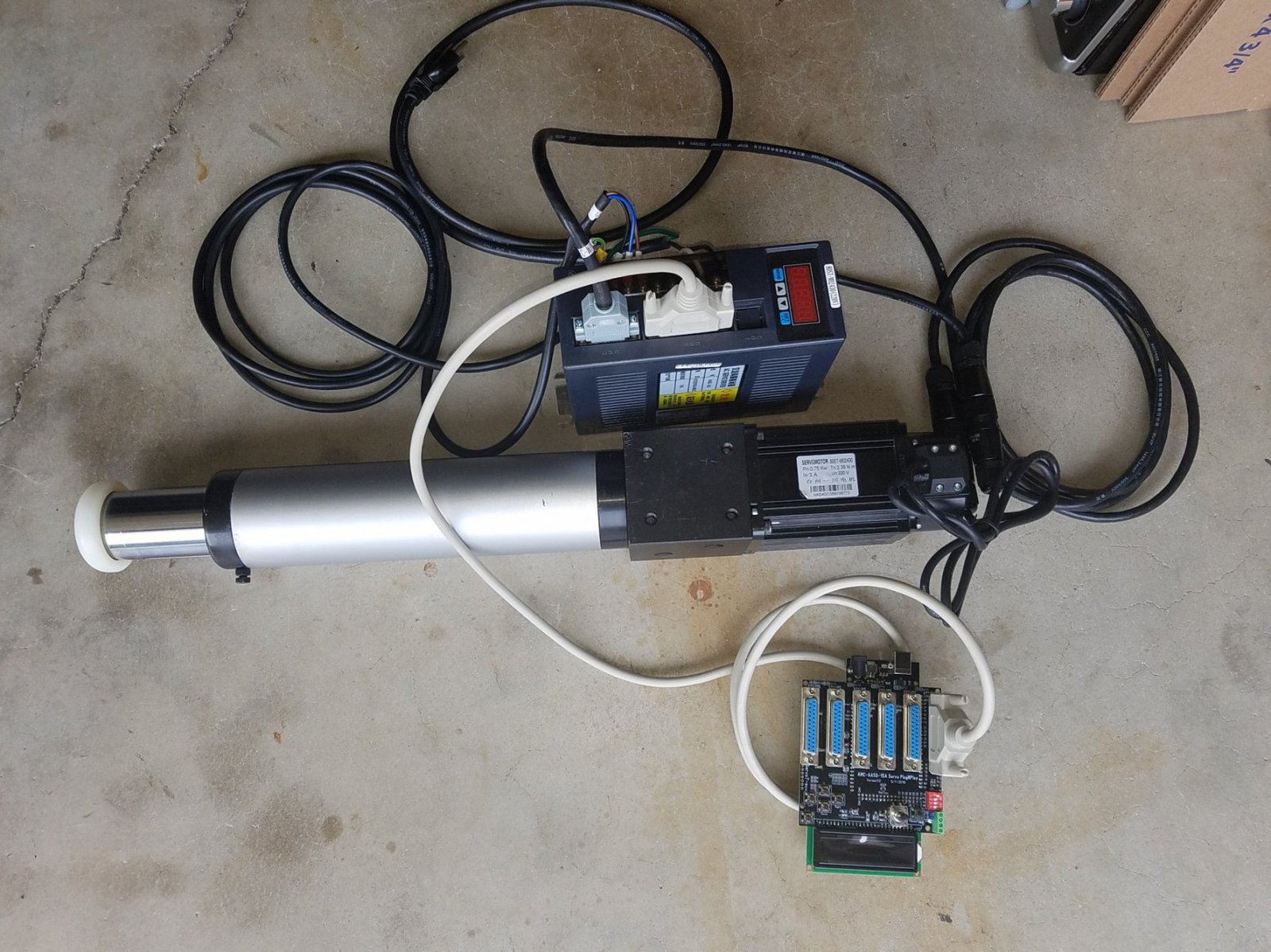

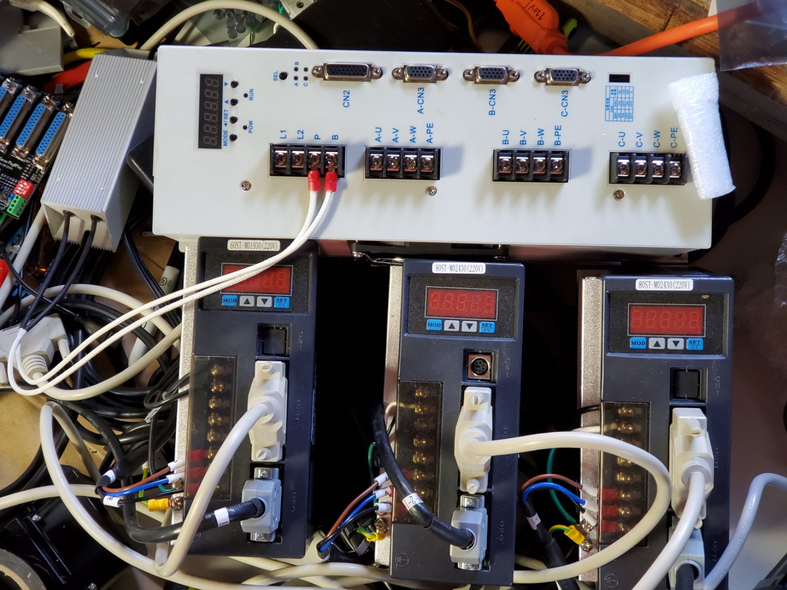

    The size of three AASD-15A servos is not that much larger... see them next to each other. Top is the 3in1 and below the three single ones...

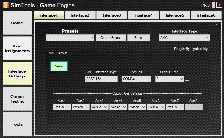

    You need the AMC-AASD15A controller to be able to interface the actuators to simtools. The connections go like this:
    PC-> AMC-AASD15A-> AASD-15A-> servomotor-> Actuator
    And you can connect multiple AASD-15A servos on the AMC-AASD15A servo controller

    PC-> AMC-NANO-> 3in1 servo -> servomotors-> actuators...
    Just another more expensive solution...

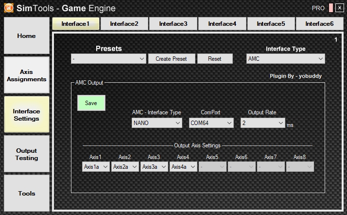

    Thanks and Simtool will also work with the AMC-Nano?

    Yes. There is plugin that supports all AMC controllers... Notice the Nano, can do only up to 4 actuators...
