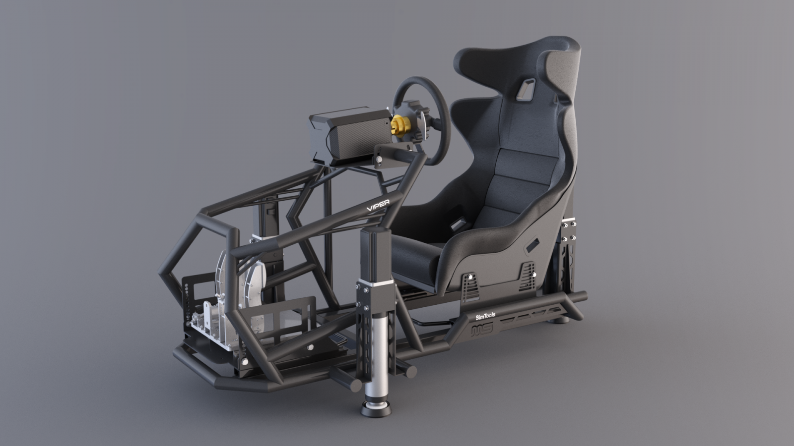

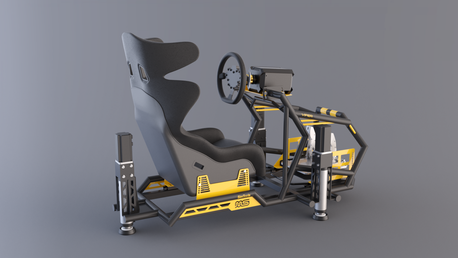

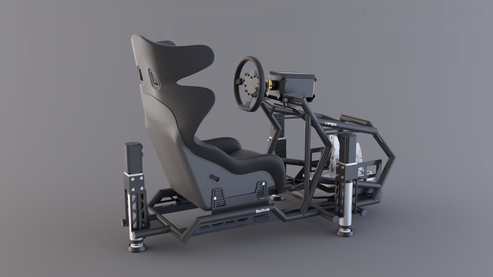

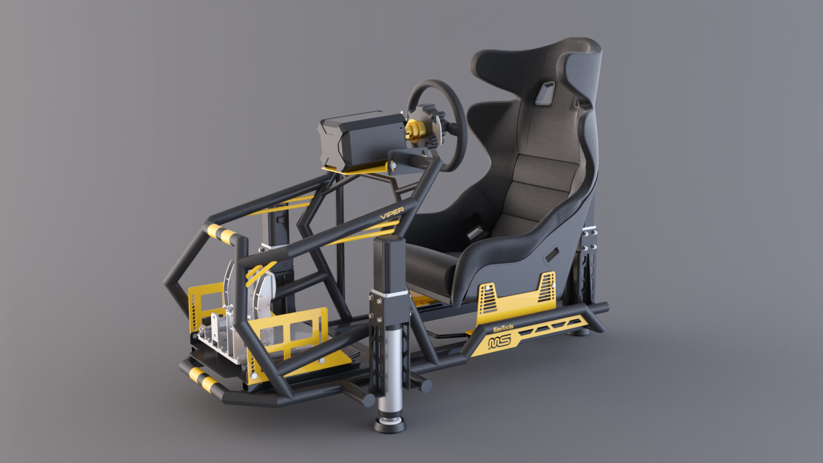

    Hi Guy's
    I think both the 4 and 3 axis PT setups are just fantastic!
    But I really like 3 legged version myself, as they make more sense to me, as you have 3 motors for a 3DOF sim that way.
    (No sense paying for the 4th motor if it does not add anything?)
    And PT Actuators are strong as can be anyway.
    The other thing I really like is there is no way the sim could ever "high leg" (where one leg is a bit off the ground).
    Not that we have seen it to be a problem with 4 legged setups, but its just not possible with the 3 legged version at all.
    And the 3 actuator MDBox controller also support vibration input (which I have been told works quite well with GameVibe).
    In the end thou, what I really like, are the looks you can get from a 3 legged setup.
    Just take a look at this work in progress by @nclabs, wow is all I can say. :eek:
    Just wow! :thumbs

    Totally agree, I would although like to see the actuator attachment points placed a bit higher (should be easy to do), so that the roll center is more realistic.
  4. yobuddy
    51,703Coins
    +5,204 / 19 / -0
    They are hip level in the pic :thumbs
    Although the way it works, I don't think it changes much..

  6. SeatTime
    2,572
    Your right - it is a solid box, but that means the roll center ends up very near the floor. That's unfortunate, luckily though in practice it does not roll much.
