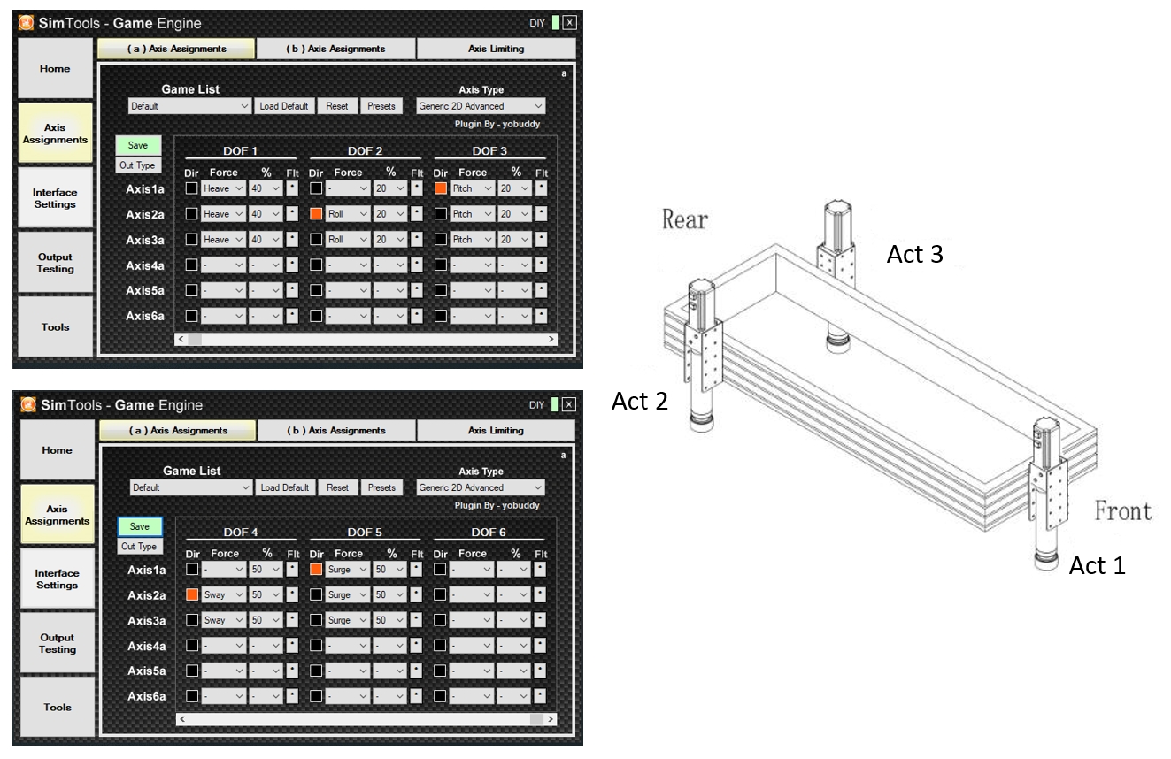

    good
    this configuration is correct, currently I have the sfx100 with three servos, one front and two rear and this configuration I do not notice it natural
    when accelerating leans forward, when I brake back, it should be the other way around
    another thing that I notice and I don't know where to change in the simtool is the brsquedad when changing gears, I would like it to feel less abrupt
    could you help me please
    thanks

    In SimTools Axis Assignments the Dir box being checked orange or not determines which way and axis moves, so try reversing how yours are set for surge: https://www.xsimulator.net/community/faq/which-way-to-set-simtool-axis-movements.230/
