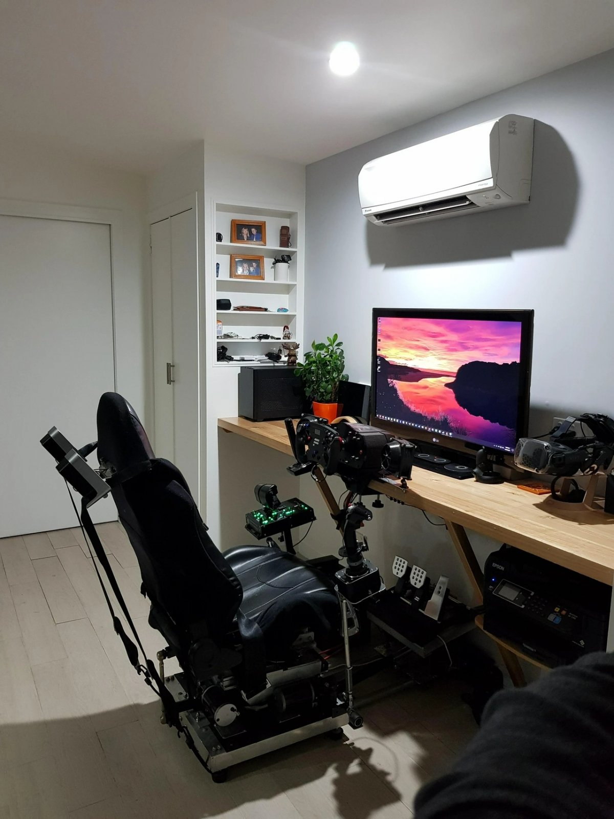

  16. noorbeast
    22,185
    154,750Coins
    +11,196 / 57 / -2
    My compact rig has been kicking around and located in many places for over a decade, here it is in my old office setup, which I think is somewhat similar to what you have in mind, though I mounted the wheel, wind simulation fans and keyboard tray on an articulated arm to the desk itself with audio controls underneath:
  17. Sky_Rock
    Sky_Rock Member
    Mar 6, 2026
    30
    184Coins
    Thank you
    Yes, something like this.
    Is it a motion platform?!

  20. noorbeast
    22,185
    154,750Coins
    +11,196 / 57 / -2
    I did not say it could not work, I think you are referring to this earlier post:
    My rig was initially built in 2014 and has been configured a number of different ways and places in its life, with another one pending once I build the new garage as its new home.
